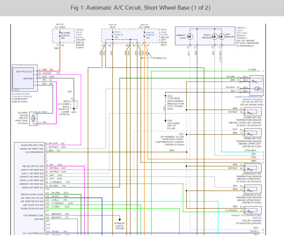

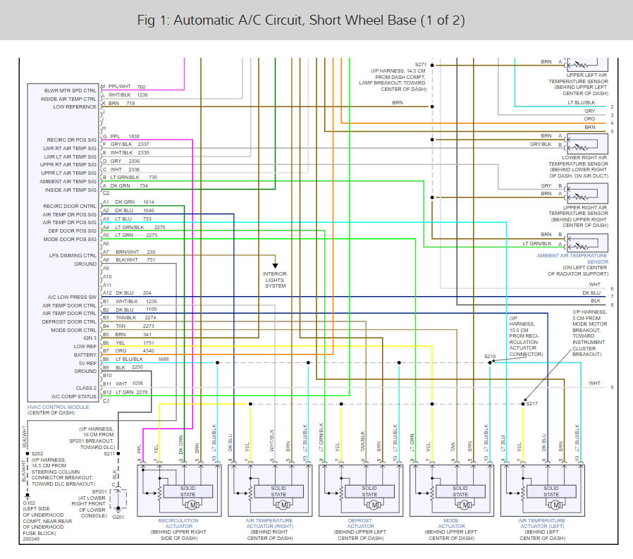

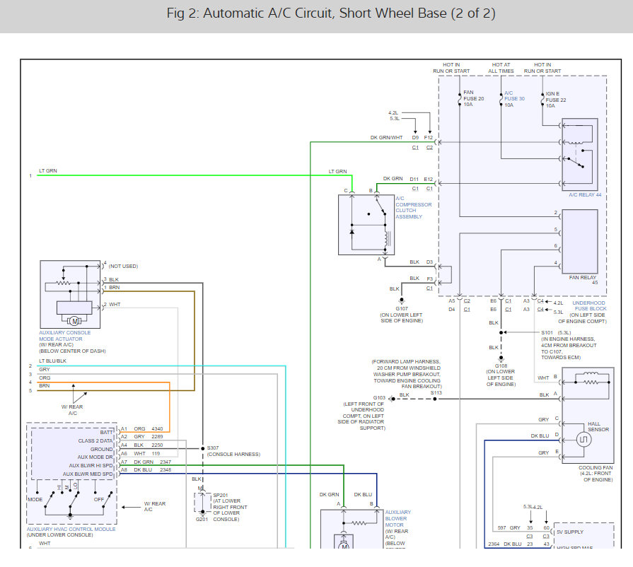

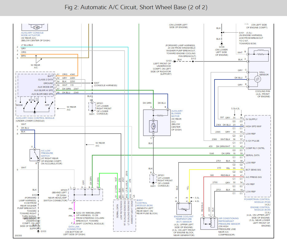

Is this an automatic, or manual climate system? It makes a significant difference in the schematic, and components involved. Lets start by checking the motor this guide will help.
https://www.2carpros.com/articles/blower-fan-motor-works-on-high-speed-only
Here are the blower fan wiring diagrams so you can see how the system works. Check out the diagrams (Below). Please let us know what happens.

According to my schematic, check first the blower fuse 40amp in underhood fuse block. With a test light to ground, check for power at blower resistor terminals G, B in lo, A in med 1, D in med 2, C in med 3, and F in hi. Check for ground on pin E. If you could use this ground to ground your test light when checking the above, it will validate it. If you have power and ground (the resistor can be disconnected) on these, and no power or ground to your blower, than replace the resistor. The resistor is shown attached to the blower motor.

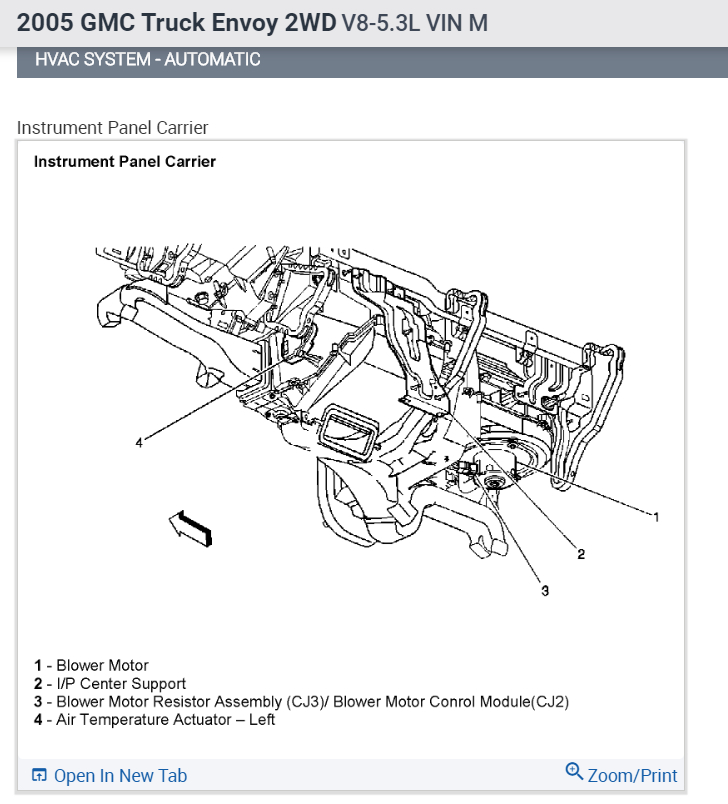

WRENCHTECH
  • 20,761 POSTS

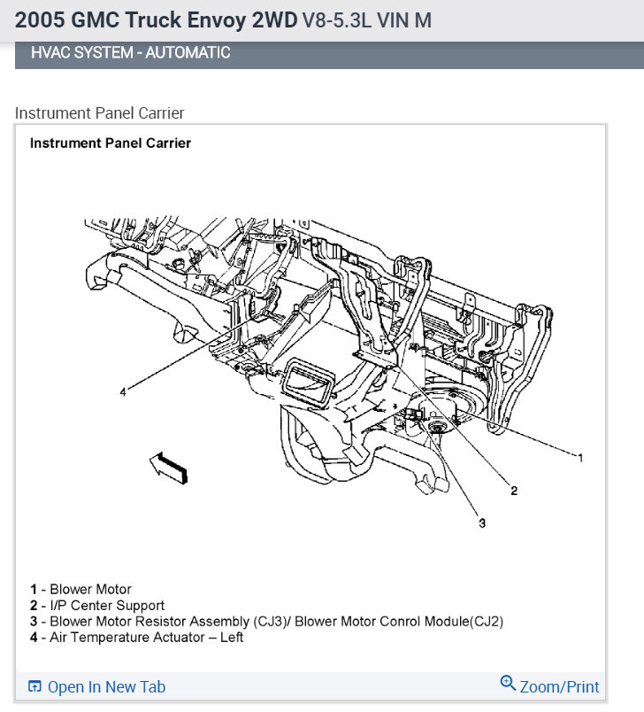

I assume you have Auto Temp Control. That is usually caused by the blower speed control module which is located where the blower motor resister normally would be, next to the blower motor.

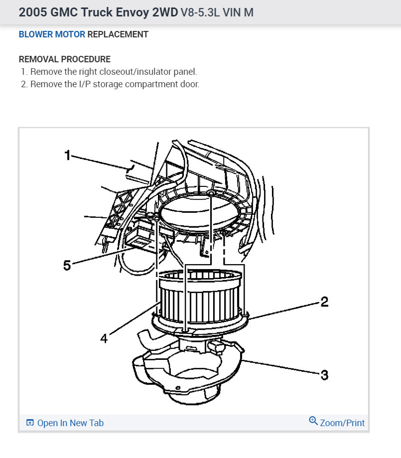

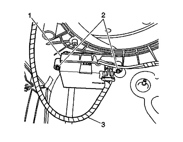

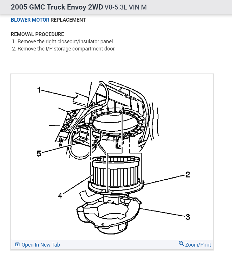

Good afternoon,
The most common issue is the blower resistor. I will attach the procedure and the picture of the location.
Procedure
REMOVAL PROCEDURE
1. Remove the right closeout/insulator panel.
ImageOpen In New TabZoom/Print
2. Disconnect the blower motor resistor electrical connector (3).
3. Remove the blower motor resistor mounting screws (2).
4. Remove the blower motor resistor (1).
