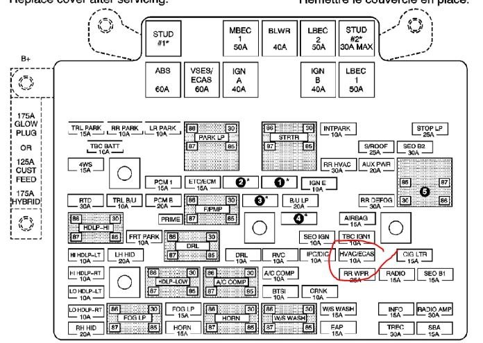

No lights come on, no power, no illumination lights. And no way to turn on A/C it heat?

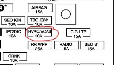

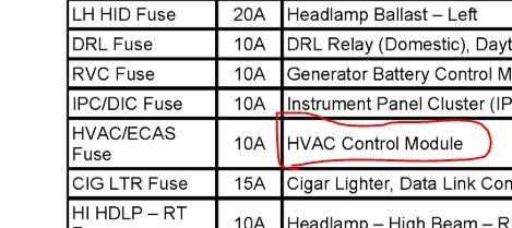

The first thing I suspect is a blown fuse. In the under hood fuse box, you will find a 10 amp fuse labeled HVAC/ERAS. I attached three pictures to help you. The first one is a picture of the fuse box. I circled the fuse. The second picture is a close up of the fuse and I circled it. Third is simply what the fuse is for.
Here are a few links you may find helpful when checking the fuse. They explain how to check, replace, and how to use simple testing equipment for testing.
______________________________
Check this first and let me know what you find.
