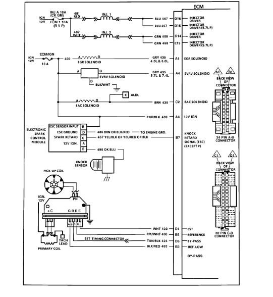

I have changed the fuel pump twice, rebuilt the TBI with new injectors, new fuel filter, new distributor and changed a bunch of sensors/ECM. The injectors are still dripping fuel. I hooked up a fuel pressure gauge right after the fuel pump and I’m not getting any fuel pressure. So I’m stumped. What do I do next?
Jul 6, 2020 at 5:55 PM
Good morning,
I attached a wiring diagram for you to view. We need to verify power to the pump to find out why you have no pressure.

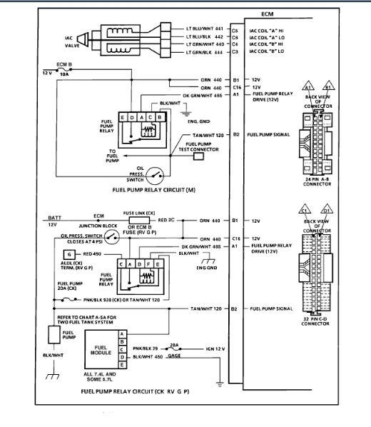

Yes, the pump is getting power. The meter said it’s receiving 7.95 volts. That’s at the pump connector. I think the starter solenoid isn’t receiving power from the ignition switch. That was my first thought because the starter is good.
Jul 7, 2020 at 1:01 PM
That was not the pump. That was for the sending unit.
The fuel pump must have battery voltage to work.
With the key on, it will have power for 2 seconds for priming. When cranking, it will have power all the time.
It should be the purple wire.

It has power from the purple wire “0.35.
Jul 7, 2020 at 1:33 PM
That is not power. It needs a minimum of 12 volts for the pump to work.

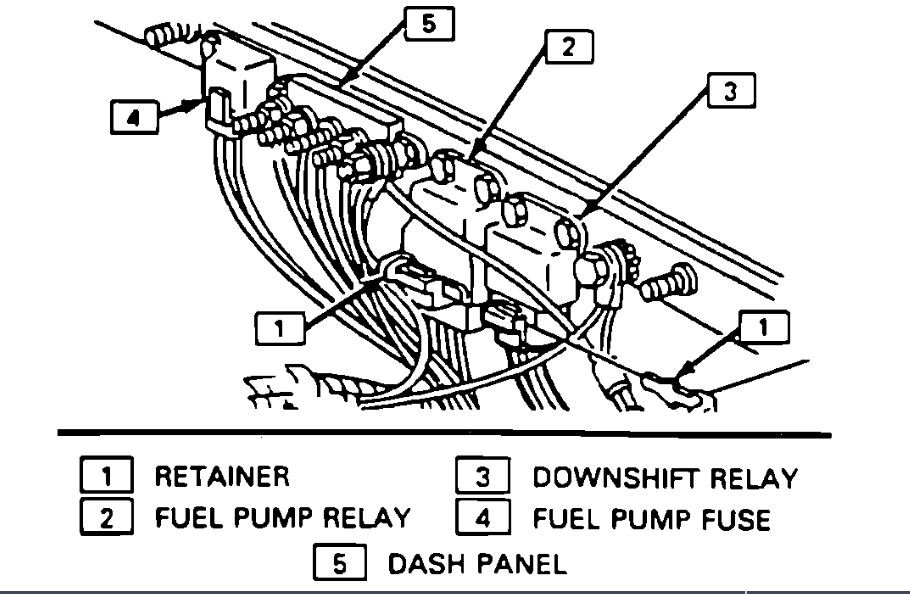

I attached a picture and location of the relay. We need to find out why there is no power at the pump.

Go to the fuel pump relay and remove it.
Test for battery voltage with the key on a one terminal.
If you have power, then you need to test for power when the key is first turned on to another terminal. It will last for only 2 seconds.

Okay, good.
Put the relay back in and turn the key to on and see if the relay clicks.

I have 0.35 at the purple wire, but I can hear the fuel pump turn on for those 2 seconds. I also have 8.5 volts coming from the pink wire that connects to the purple wire at the connector .
Jul 7, 2020 at 3:24 PM
The purple wire should have battery voltage, not .35 volts. The pump will not run with that voltage.
Please recheck.

I have confirmed that the purple wire doesn’t have power.
Jul 7, 2020 at 6:43 PM
JOE UTLEY
  • 13 POSTS
Correction. I tested the gray wire and that has 12 volts to the pump. The purple wire which is my fuel level gauge has no power. So the fuel pump is getting power and I now have 5 lbs of fuel pressure. The injectors are dripping still and the truck will run with starting fluid only.

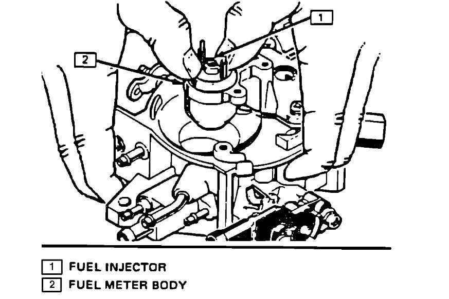

You need a fuel pump. If the injectors are leaking, remove the connector and see if it still leaks.
https://www.2carpros.com/articles/how-to-replace-an-electric-fuel-pump
If it does, replace the injectors. If it does not, you could need an ECM or you have a wiring issue from the ECM to the injectors.

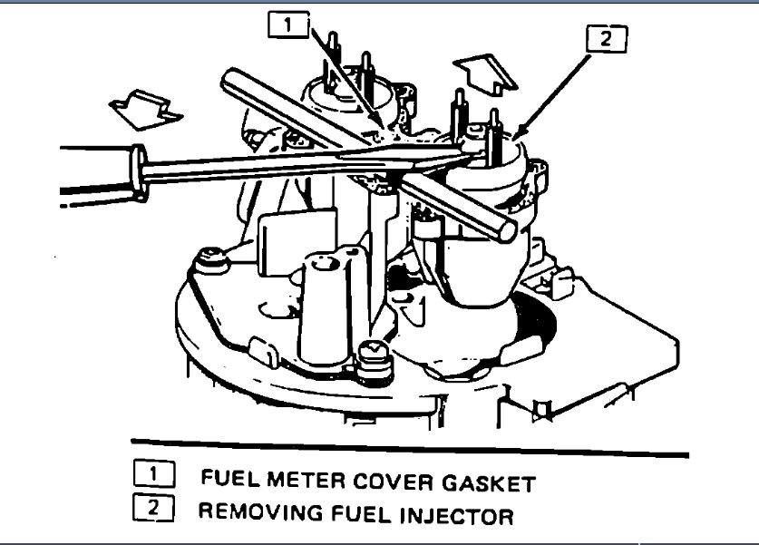

REMOVAL:
1. Disconnect electrical connectors to fuel injectors. (Squeeze plastic tabs and pull straight up.)
2. Remove fuel meter cover assembly, refer to FUEL METER COVER ASSEMBLY.
3. With fuel meter cover gasket in place to prevent damage to casting, use a screwdriver and fulcrum to carefully lift out each injector.
4. Remove lower (small) O-rings from nozzle of injectors and discard.
5. Remove fuel meter cover gasket and discard.
6. Remove upper (large) O-rings and steel backup washers from top of fuel injector cavity and discard.
