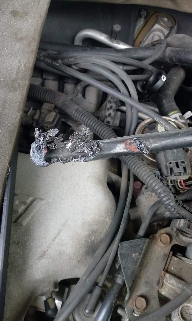

EUGENE PEACHY
It checked out fine.
Wednesday, January 20th, 2021 AT 10:25 AM (Merged)

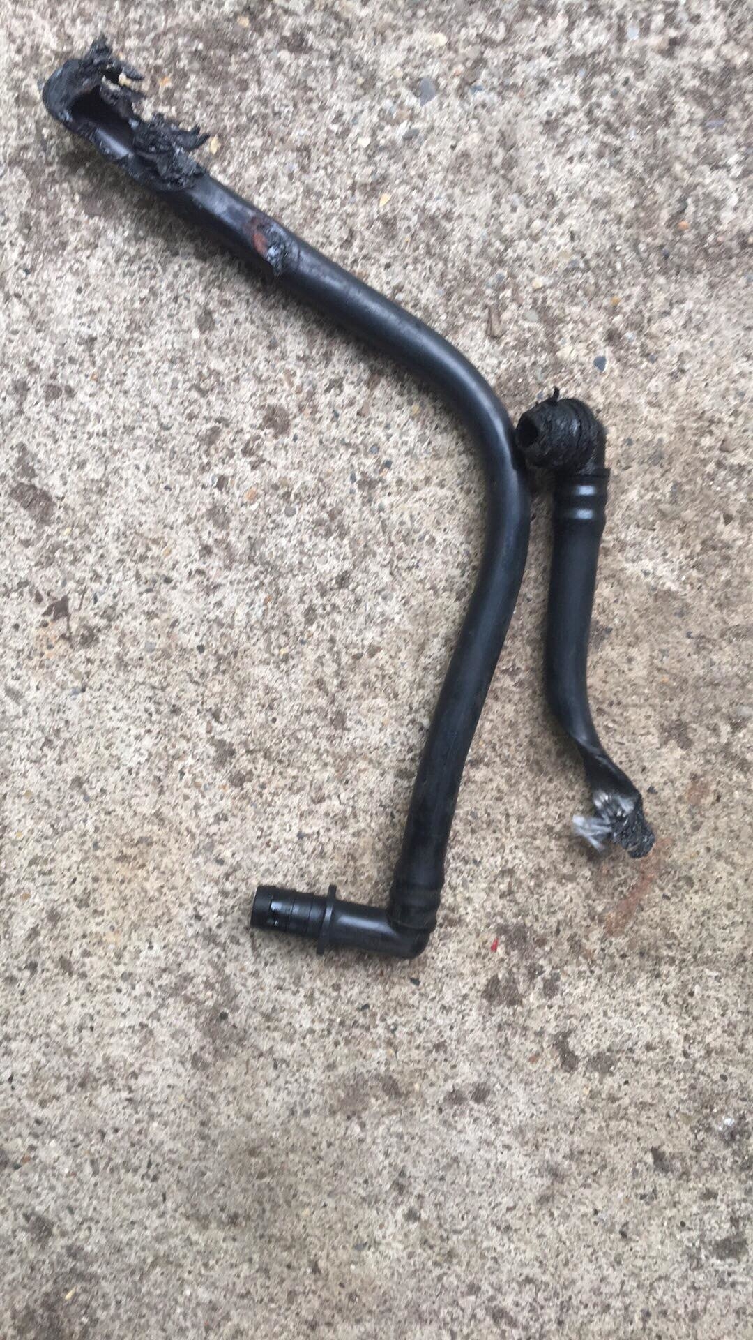

EUGENE PEACHY
And this is what I found. I fixed it and the car runs just fine. Now it was melted by the EGR valve.
  • 52,797 POSTS
That is the breather tube to the mass air flow hose.
