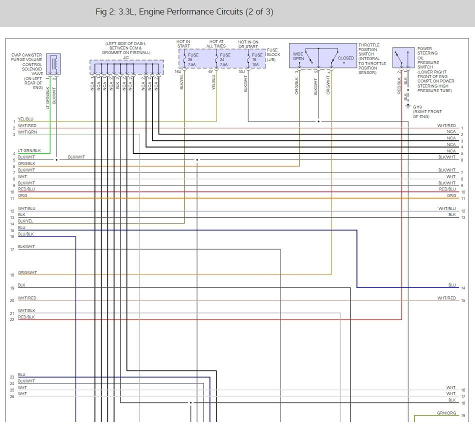

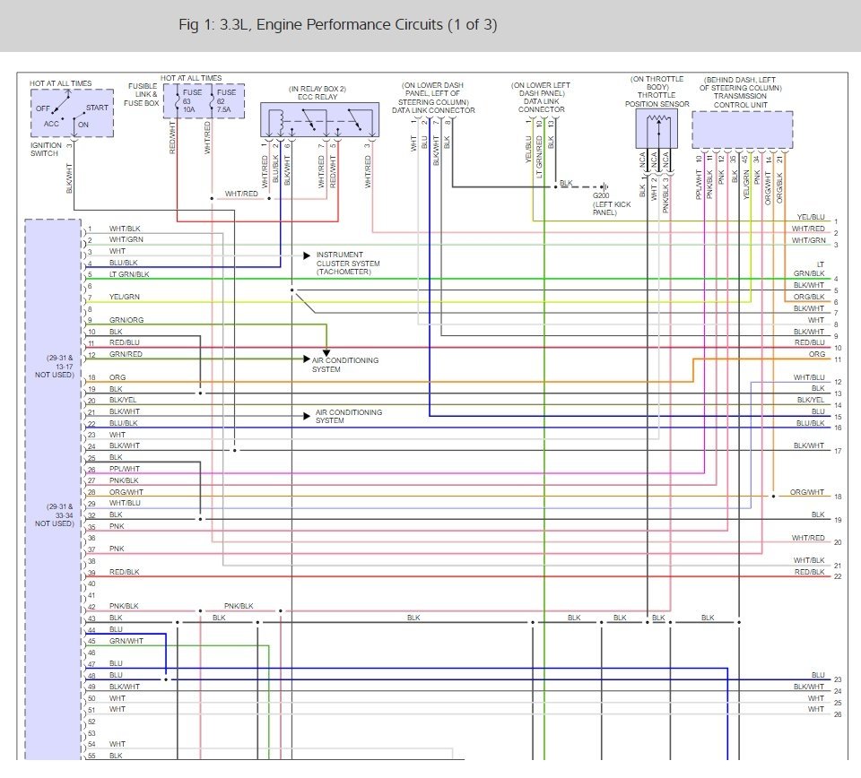

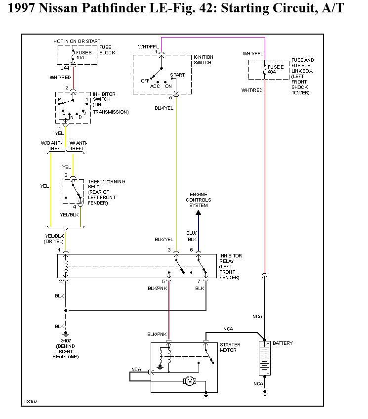

No power at any terminal on inhibitor switch.
Nov 14, 2018 at 12:19 PM (Merged)
JIM1111
  • 7 POSTS
I need to correct my reply, I checked the inhibitor relay on fender not switch on transmission.
JIM1111
  • 7 POSTS
How do you remove inhibitor switch from transmission for test?
KHLOW2008
  • CAR REPAIR CONTRIBUTOR
  • 41,814 POSTS
You need not remove the switch for testing.
Unplug the connector and test for battery voltage at White/Red wire terminal. If voltage is present, use a jumper between White/Red and Yellow and try cranking.
SHYSHA24
My car won't start I don't know waht it is when I turn the key it just makes a clicking noise, almost like a static noise. So can you tell me the problem.
  • 75,992 POSTS
For a start test the battery and also make sure its cleaned and tightened properly
JIM1111
  • 7 POSTS
Does the connector pull out of transmission?
KHLOW2008
  • 41,814 POSTS
Yes, connector is plugged in and held by a locking tab which is pressed to release
JIM1111
  • 7 POSTS
Inhibitor relay has no power on any terminal.
KHLOW2008
  • 41,814 POSTS
Terminal #1 of inhibitor relay must have battery voltage with ignition on and while cranking.
JIM1111
  • 7 POSTS
No voltage on #1 what should I look at next?
KHLOW2008
  • 41,814 POSTS
The answer was given previously. Check for battery voltage to inhibitor switch and out of it to the inhibitor relay.

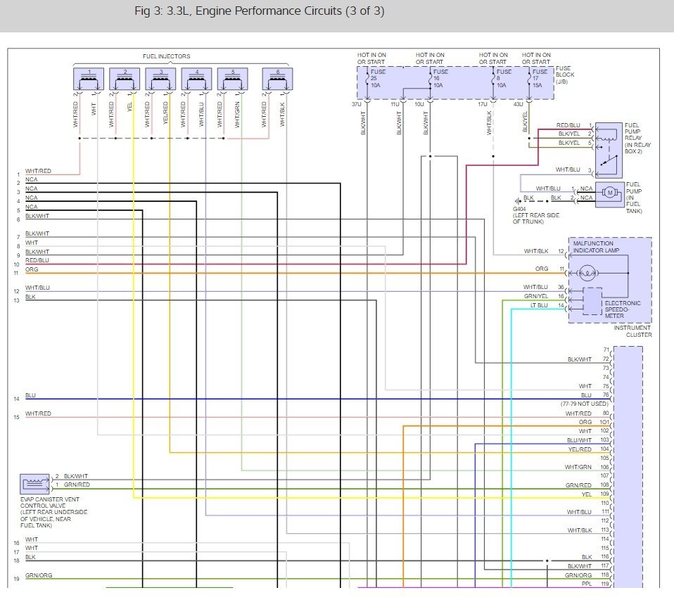

My 1996 Nissan Pathfinder wont stay started and stalls out immediately. I have replaced the distributor, which also replaces the Cam Postition Sensor, since it is built in the distributor. I have also replaced the Mass Air Flow Sensor, fuel filter and had a fuel pressure check done. I also had a computer diagnostic test done. It showed some faults. Knock sensor problem bank #1 - also O2 sensor B2S2 problem - also O2 sensor B1S1 heater problem. Will the O2 sensor problems cause it not to start now?? It turns over and barely starts or idles for a second or 2 then stalls out. Need HELP.. Thanks.
HMAC300
  • 48,601 POSTS
check fuel pressure first
NO-WHEELS
Thank you, but I did that already. Showed 35 psi. I have no dash lights showing. It all started with it bucking and stuttering one day at certain speed or after car was warmed up and reached it's normal running temp.
After reading blogs, I have replaced the distributor, because I found metal shavings which indicates wear which also replaces the Cam Postition Sensor at the same time, since it is built in the distributor. I have also replaced the Mass Air Flow Sensor, fuel filter and had a fuel pressure check done and read 35 pounds of pressure.
I also had a computer diagnostic test done. It showed some faults. Knock sensor problem bank #1 - also O2 sensor B2S2 problem - also O2 sensor B1S1 heater problem.. Not sure where to go from here, since money is tight and I cant afford to do process of elimination anymore.
When I start it, runs extremely rough as if it were out of time. After installing the distributor, it ran perfect until it I ran it to the store and it warmed up. Then started acting up again. So I am stumped and still without wheels.
HMAC300
  • 48,601 POSTS
MINIMUM fuelpressure is 43psi you don't have enough
NO-WHEELS
Thanks again for responding. So 43psi is minimum? Can it be my fuel regulator relay cutting out sporadically?
And can it cause my pathfinder to run extremely rough with no power at all? I started it yesterday but was really running extremely bad and heard a few popping noises in my filter box. I would hate to buy a new fuel pump and go through the work of replacing it as it is in the gas tank and then find that it wasn't the fuel pump. Thanks for helping me and I would appreciate your advice, since I am on a minimal income and disabled. I am so discouraged right now and feel lost. Chris Btw, nice motorcycle you have in your pic.

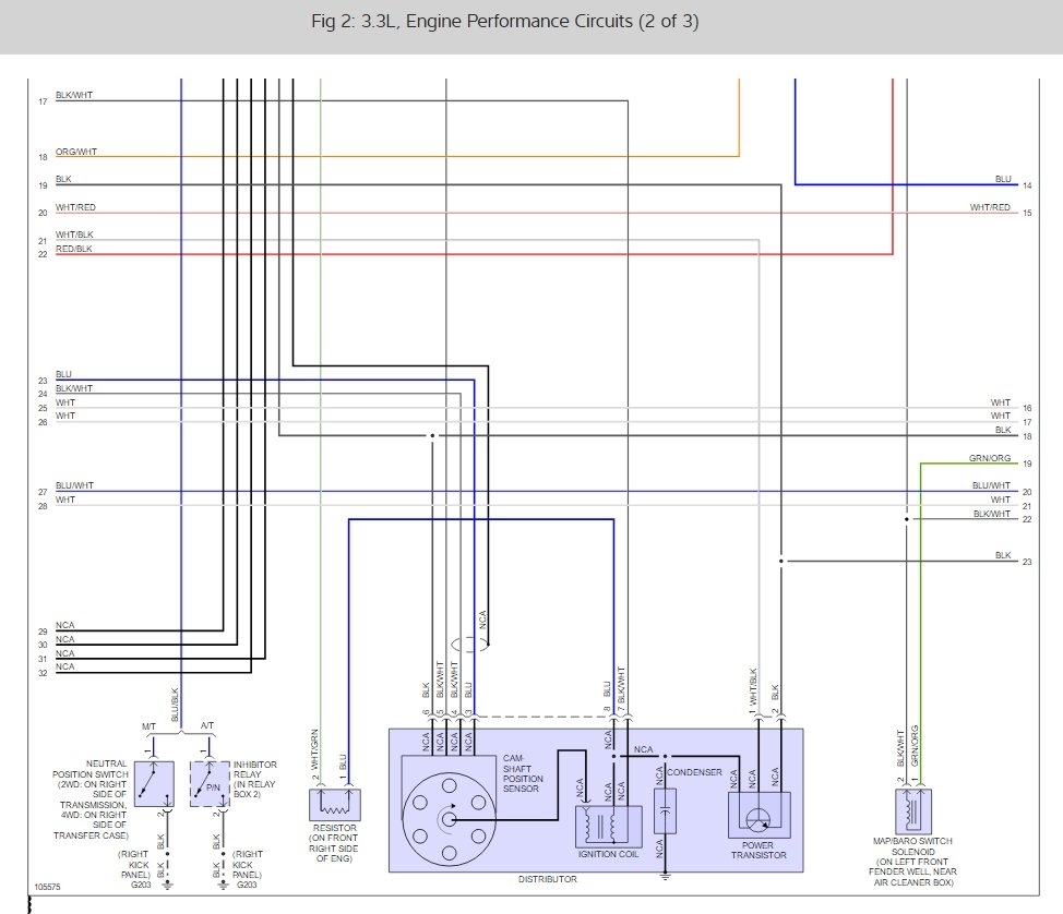

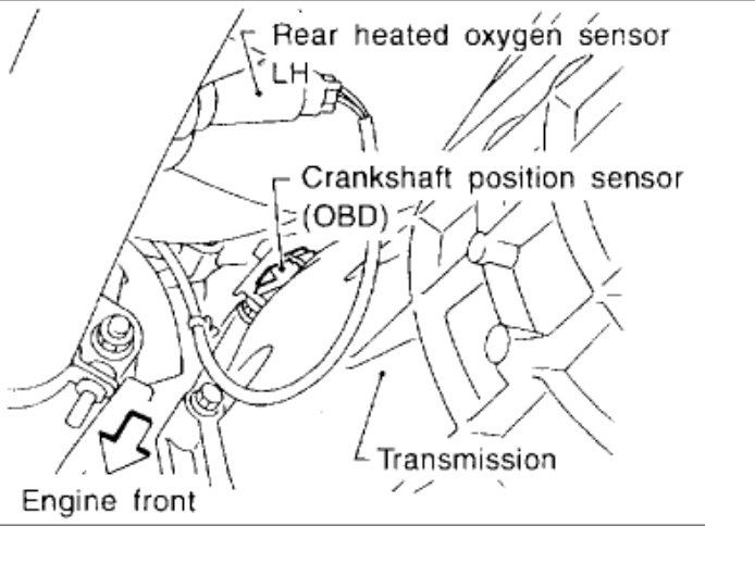

A few day ago in the morning, our 98 Pathfinder would crank, but not start. We changed 5 out the 6 spark plugs and it ran fine that night and the next morning until about 20 min. into driving. Then, the car began to idle bad and acting like it was going to shut off. I arrived at work and when beginning to leave, it cranked and started but again idled bad while in park and drive and would shut off. Tried to have spark plug replaced, but no mechanic was willing and able at time. Attempted to drive home and it shut completely off coming down the road. No smoke, radio and all electronics would work, but would not restart. We replaced the 6th plug and all the wires and it will crank and not start. We listened for the fuel pump with ignition "ON" and you can hear it and clicking under hood. You smell fuel when trying to crank and spark plugs smell of gas. We ran the scanner tool and no codes are found. We tested the spark plugs and there is no fire to at least two of them. We have came to the conclusion it is either the crankshaft sensor or distributor. But My question is if it is the crankshaft, wouldn't we have received a code or could it be the ECU not giving it a code or the distributor rotor (cap looks brand new). Also, is there any way to test the distributor or crankshaft to narrow it down?
  • 75,992 POSTS
When a crankshaft sensor goes bad it will not set a code. Here is a guide to help you see what you are in for when doing the job.
Here is the location of the sensor which is on the top of the transmission bell housing.
Cheers
CDERRICK23
Yeah we have tested the spark plugs and there is no spark. We have turned the ignition and the fuel pump cuts on. The fuses are ok. We need to know how to test the coil on the distributor, cap, or crankshaft. We hooked the scanner and no codes are pulling. I will order the crankshaft sensor
  • 75,992 POSTS
The Crankshaft Position Sensor (OBD)On transmission housing, facing flywheel gear teeth. You will need to jack the car up
CDERRICK23
It took a while but I got the sensor changed out and the engine started right up YA! thanks for your help this site rocks!
