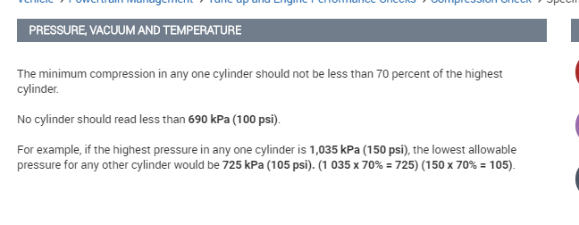

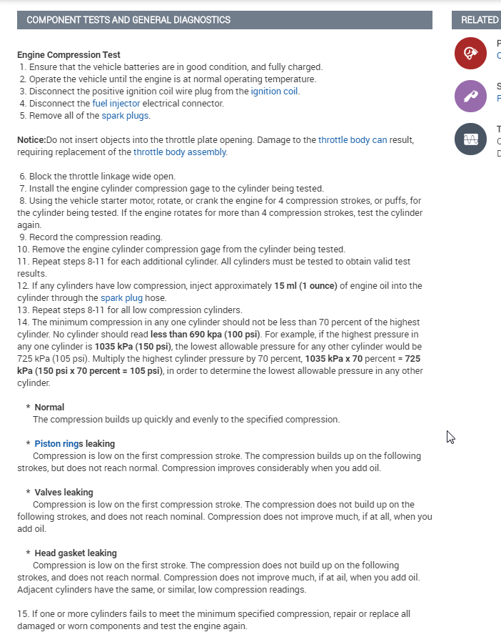

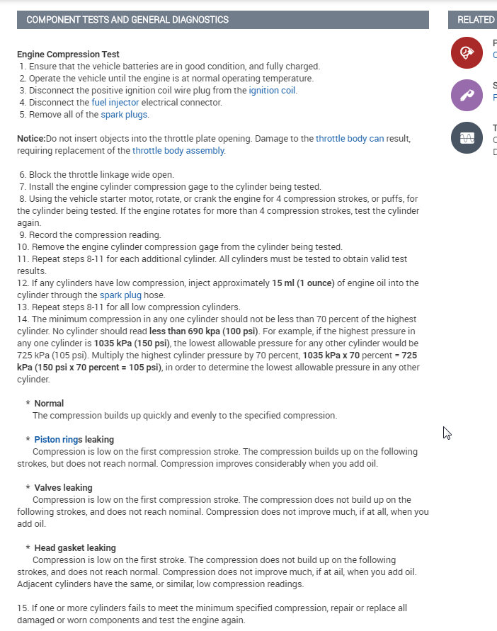

Once we know which cylinders are missing then we can dig further. However, we are going to want to run a compression check. This will ensure a valve is not hanging open causing the misfire. If compression is good then we know it is spark, fuel, or air related.
https://www.2carpros.com/articles/engine-backfires-while-running
Run through this and let me know what the compression readings are and the codes and we can go from there. Thanks

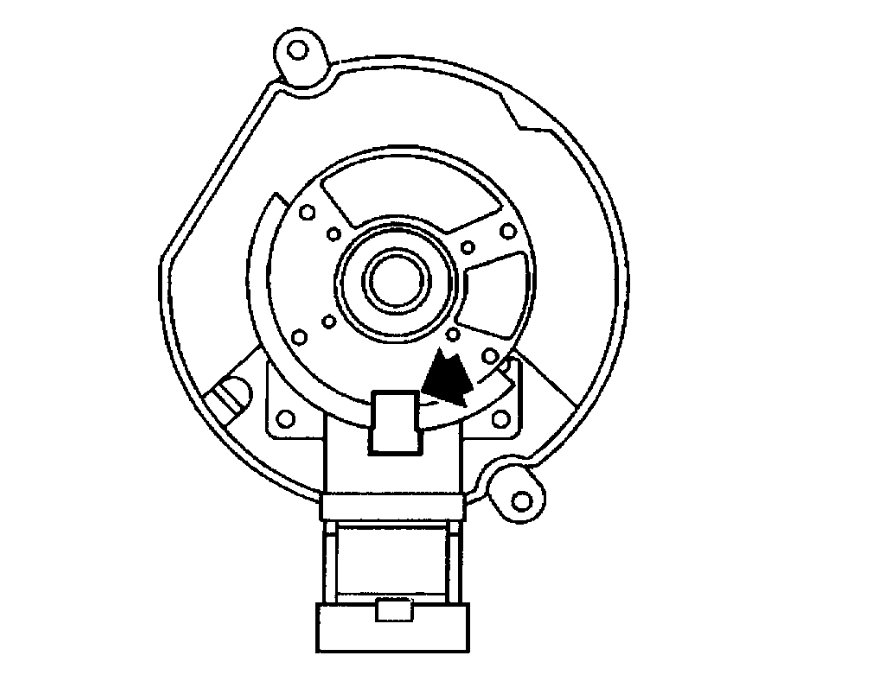

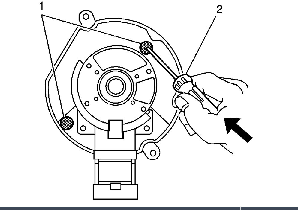

It could be corrosion build up in the distributor below the hall effect sensor. I;m attaching cleaning procedure and inspection below. Also attaching repair guide and top views of the distributor. The Check engine lamp blinking because of to many misfires. Let us know know if this was help or if you need more information.
1. Inspect the distributor cap. You may notice a white residue on the cap walls. For higher mileage occurrences, the interior of the cap may have changed to medium brown in color.
2. Inspect the distributor rotor. You may notice the presence of black streaks on the plastic surface. More typical evidence would be visible green spots on the copper surface of the rotor segment.
3. Inspect the distributor base. You may notice high levels of surface rust on the distributor shaft or surface contamination on the sensor hold down screws.
4. Inspect the distributor vent screens (1). If the vent screens are present, remove them by using a plastic-handled, long blade awl or pick (2). Insert into the airflow vent screens and pop them out. Refer to the figure for removal procedure. If the vent screens have been removed from the base of the distributor, then check the airflow inlets for being clogged with debris.

How in the heck did you figure that out? So if I take off the rotor striker underneath the white plastic piece with 2 T 15 screws holding it down. There is two screens that can get clogged? It makes sense I work by salt water every day. I appreciate the info I'll try tomorrow and let you know. Thanks

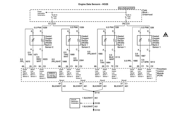

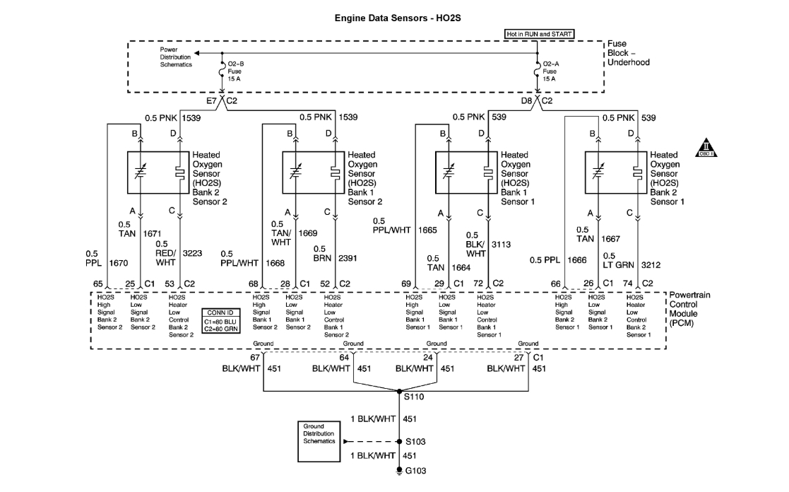

It was a lighter fuse. The scanner says catalyst mon inc. Evap system mon inc. Oxygen sensor mon inc. Oxygen sensor HTR INC? What do these mean can it be my problem?
Sunday, February 9th, 2020 AT 1:13 PM
TOUGHDIVER
  • 224 POSTS

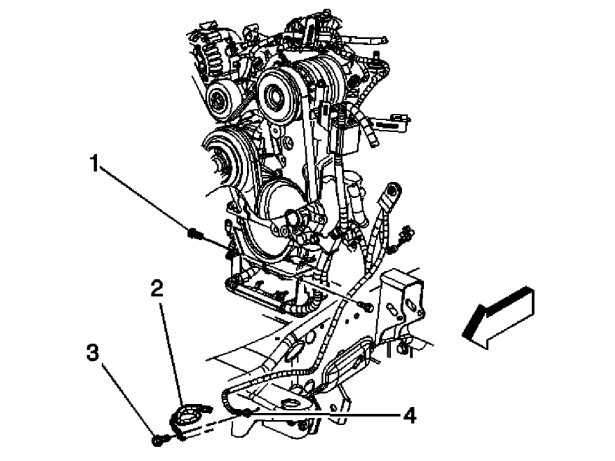

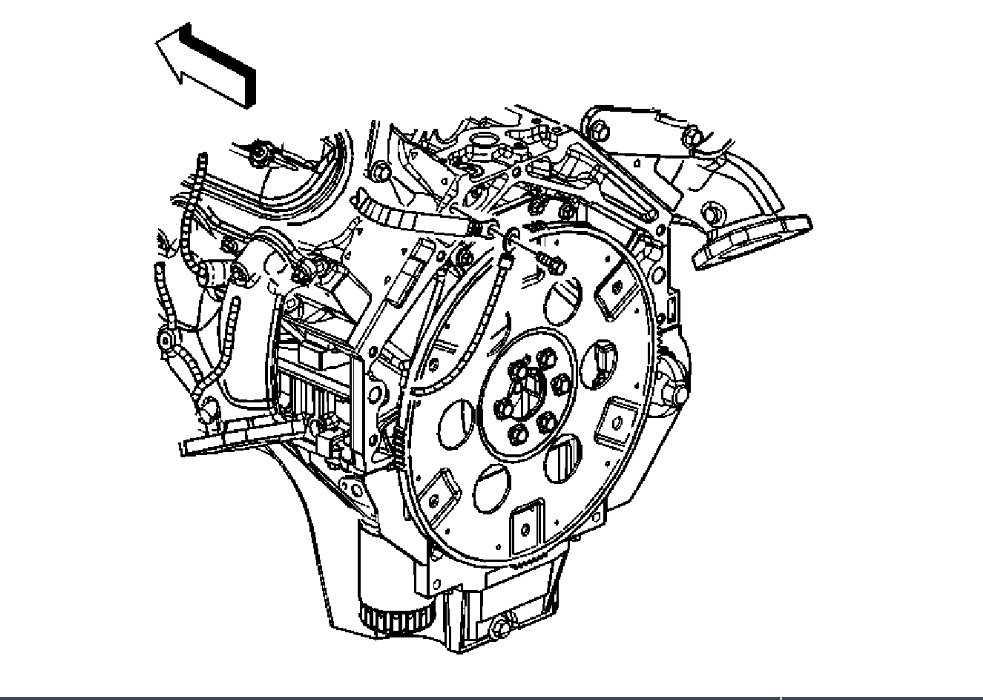

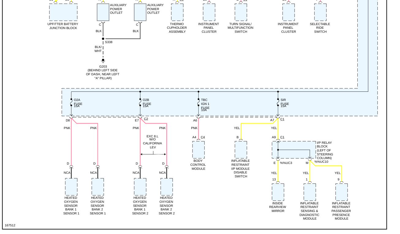

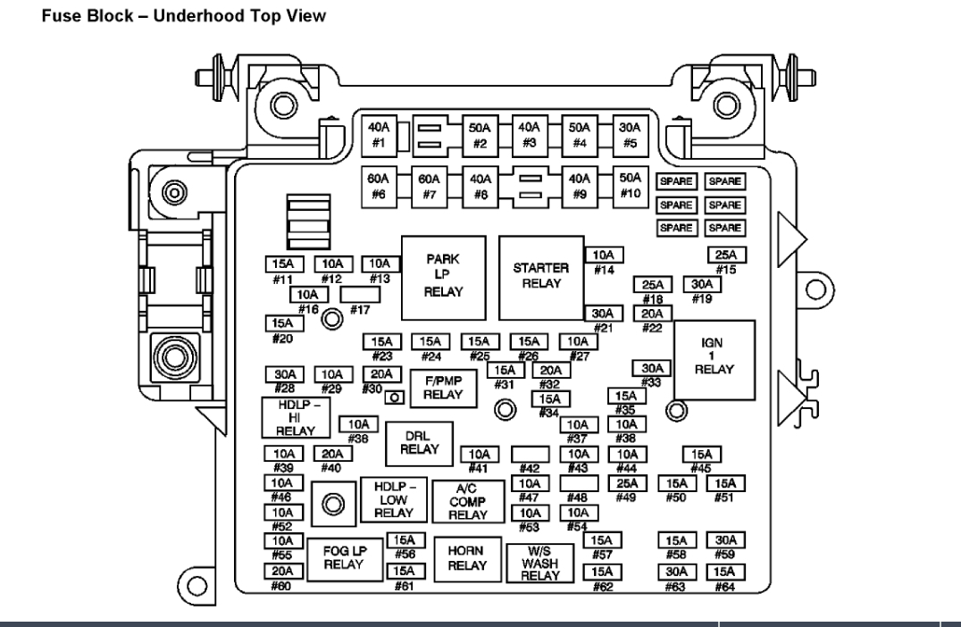

Sorry it took this long to reply back. For the diagnostic code reader information I have to say I have never seen it displayed like this and I'm use to getting diagnostic trouble codes to go on. You might have a broke or loose ground strap or cable for the PCM ground. Ground G103 and G104 are on the back of the engine. I attached views below to help you locate the connectors but check all harness connectors as well. There is one ground strap that isn't shown and it is on the back of right rear of the cylinder head very important to have a good connection. Check the heated O2 sensor fuse for sensor 1 and sensor 2 I've attached wiring schematics and fuse block view below. Let us know If this was helpful or if you need more info.
