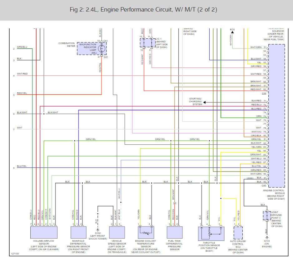

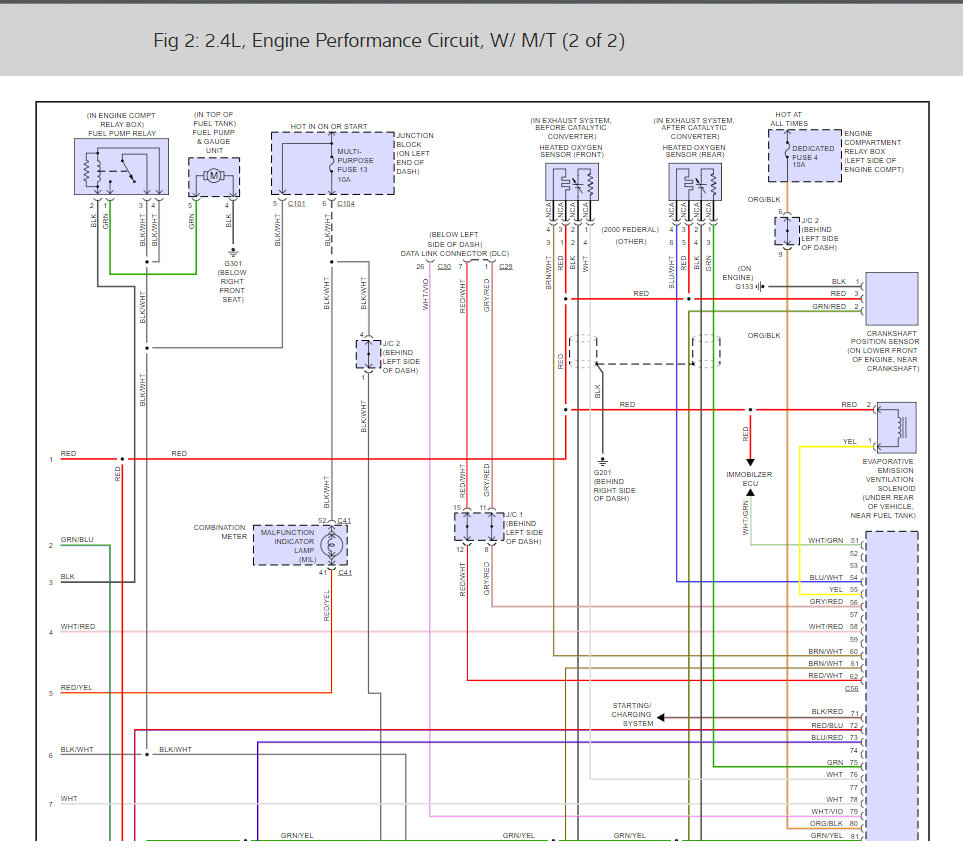

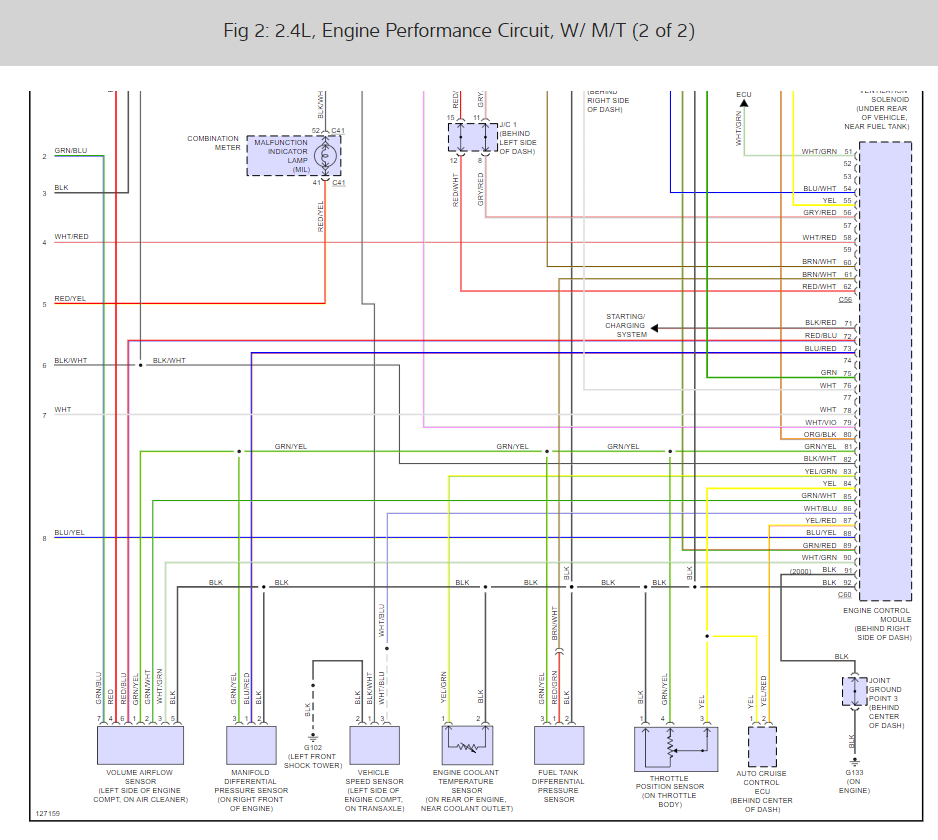

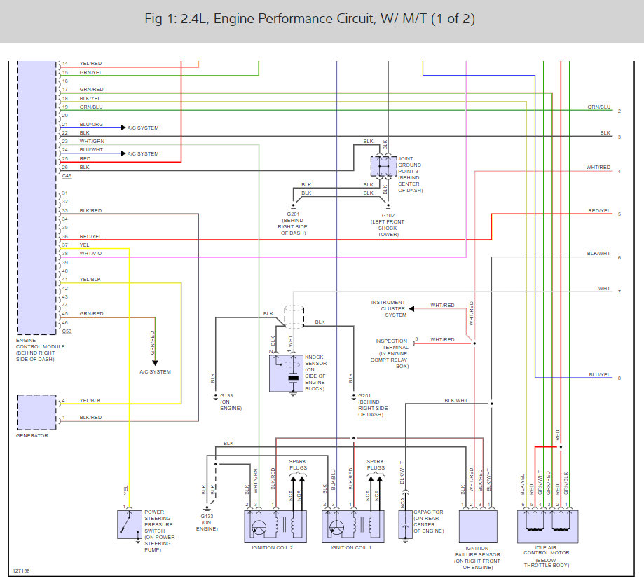

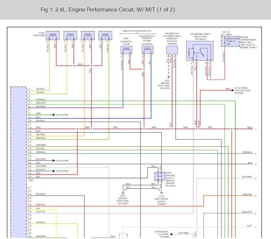

Not sure what is going on with the car. I had the ECU tested and they said it was good. Then I checked the pig tails they are fine. I could not find a wire burnt in two or any other damage. Did find a fuse on one side did not make contact but on other side did and on top made ground.
Monday, May 21st, 2018 AT 6:49 PM
KEN L
  • MASTER CERTIFIED MECHANIC
  • 55,488 POSTS
You will need to go over the wiring power ground and connection to make sure we do not have an open or shorted wire somewhere. Here is a guide to help you get the job done:
Check out the diagrams (below). Please let us know what you find.
