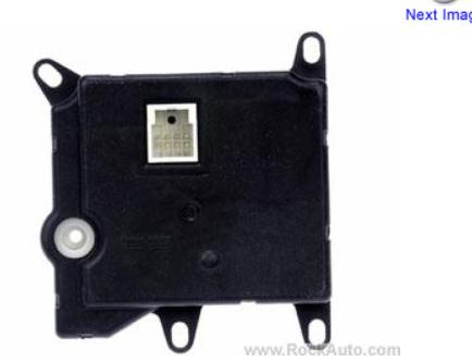

To replace air blend door actuator do you have to remove dash?
Wednesday, July 28th, 2021 AT 12:24 PM (Merged)
BMRFIXIT
  • 19,053 POSTS
NO ,NO
Disconnect negative battery cable. Remove right lower console trim panel from instrument panel. If equipped with center console, remove right, front side panel from console. Disconnect A/C electronic blend door actuator connector from actuator.
Remove 4 screws retaining A/C electronic blend door actuator to heater/evaporator housing. Remove A/C electronic blend door actuator.

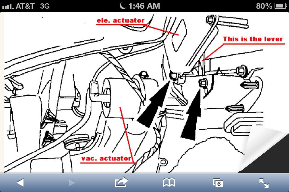

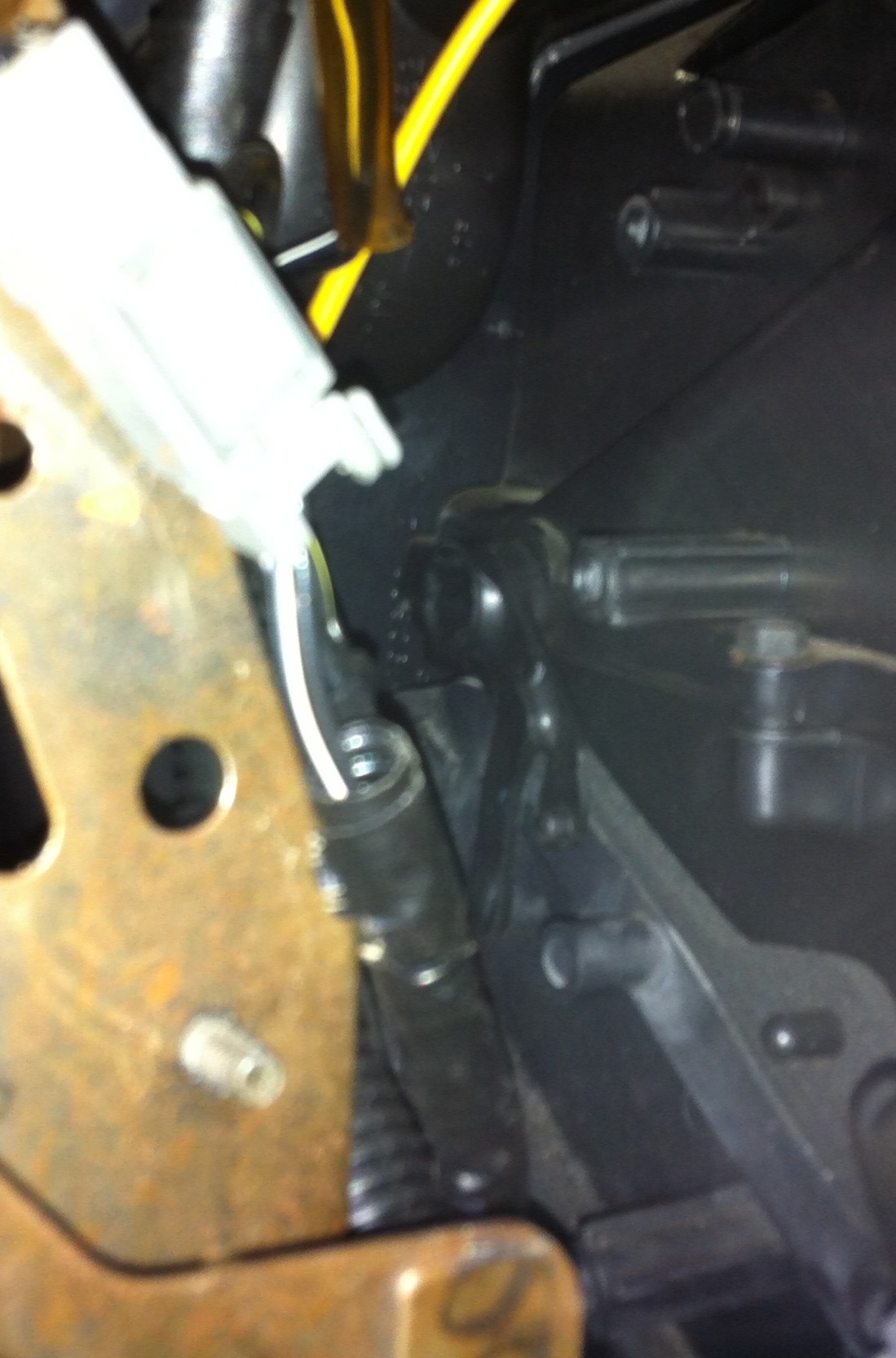

Okay so this "black box" is the control module. I removed the screw and did find lever that controls heat/AC flow behind it (second picture from last post). The control module has a electrical connection plug that is not plugged into anything (third picture from my last post). I am wondering if this could be the problem although I can't find anywhere it plugs into. Would like to find this out before going further. Is it possible this electrical connector isn't plugged into anything because it doesn't apply to my vehicle?

It may not be for your vehicle but check the control h ead the las series of pics I sent it might possibly plug into there and the guy that "Fixed" it the last time may have found out that that wold make the a/c work but nothing else. If the wires are the color f the diagram thatmay go to temp blend door actuator and may be the reason it doesn't work or the actuator is bad. If it does plug into actuator pull havac fuse for 60 seconds with key on as the sometimes will reset it.

Swivel socket and a long extension

Thank you so much. I will try your suggestions. As for the guy who "fixed" the AC thats what I was thinking, he may of disconnected it to get the AC to flow. He told my father-in-law he replaced a relay. With the control module moved aside I do remember seeing something that looked like a vacuum actuator (like the one in the first pic) but not the temp blend door actuator as the second pic shows from my repair manual. I wonder if this guy removed the temp blend door actuator and never replaced it! Would it always be located right over the lever that controls the blend door? If so its no longer there (third pic is lever in center of picture).
At least with your help I was able to find the lever for the blend door that if need be I could lock it into the position to allow heat to flow for the winter and in the summer I could "unlock" it to allow the AC to flow. Thank you again.

It still didn't load anyhow if it'snot there there should be a hole where the actuator was as well as empty screw holes. See pic for what it looks like and it seems the missing connection should go there. I have no further suggestions to give.

Picture that didn't load looks just like what you added. You have given me enough information to get it figured out. Thanks again.

The blend door actuators is no good it jam the lever and broke the piece to hook to the rotating the door.
