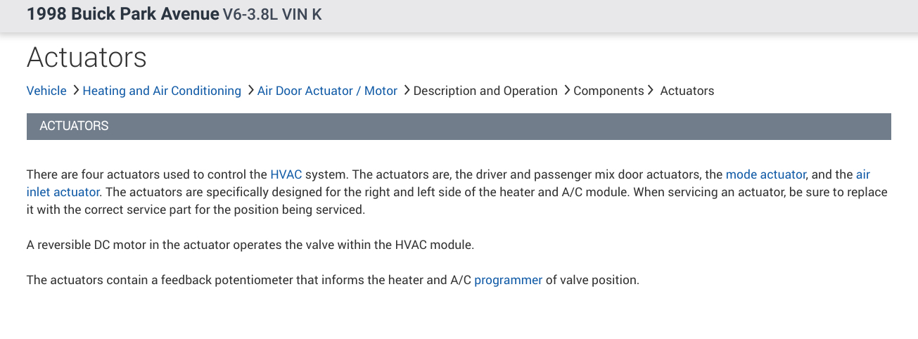

It sounds like you have a mode blend door actuator that is not working right. Here is guide to help show you the repair with diagrams below to help you with your car. Check out the diagrams (Below). Please let us know what you find.

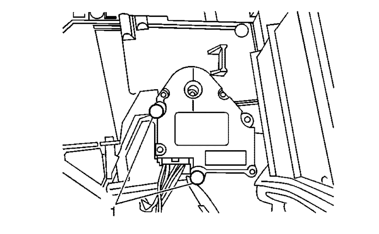

The Park Avenues (PA) of this series (1997 through 2005) have electrically controlled air doors. This is a symptom of the "mode actuator" not working. It is common for a plastic gear inside the HVAC system actuators to crack and then fail to move the doors that control the flow of air. It is also possible for the electrical connection (connector etc.) To be intermittent, or the electronic control module to fail, but not as common.
Unfortunately the "mode" actuator is the most difficult to access of the four actuators on this series of PA. It is the aft-most one of two actuators on the driver's side of the HVAC unit (under dash). It is mounted to the forward side of the aluminum dash substructure under the plastic surface pieces. The service manual recommends removal of the complete dash and steering wheel to access this actuator.
I believe it is possible but difficult to remove and replace this actuator without removing the dash completely or the steering wheel. I am in the process of trying to do that.

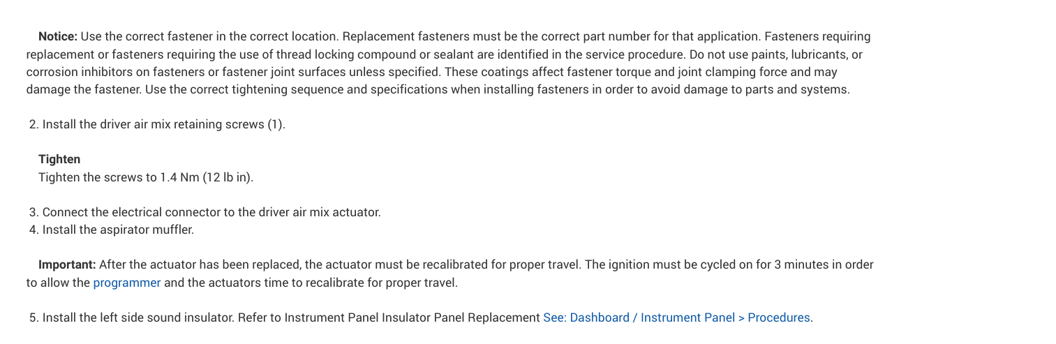

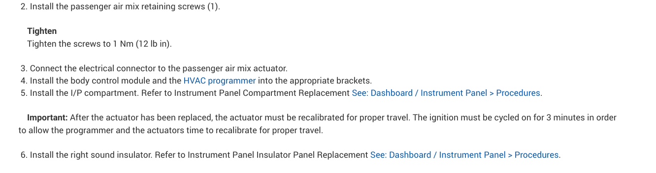

Good evening,
To calibrate the motor, remove the fuse for the AC system for one minute.
Then turn the key to on and wait three minutes. The module will set the motor to the correct position.

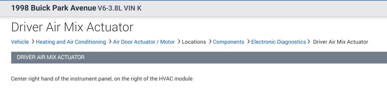

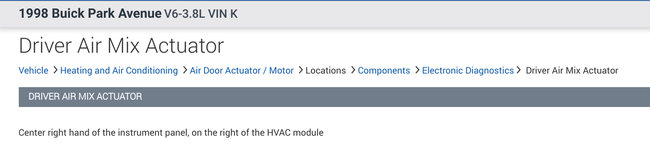

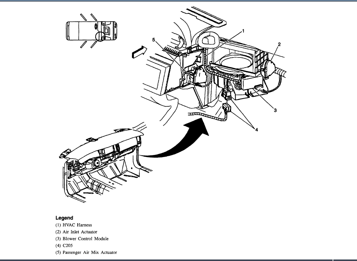

Where specifically is the actuator which controls the flow of the heater and A/C located? I have watched the 2CarPros video several times and find that it is not showing this particular vehicle. Is it indeed located behind the glove compartment?

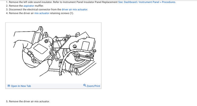

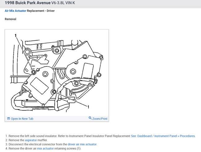

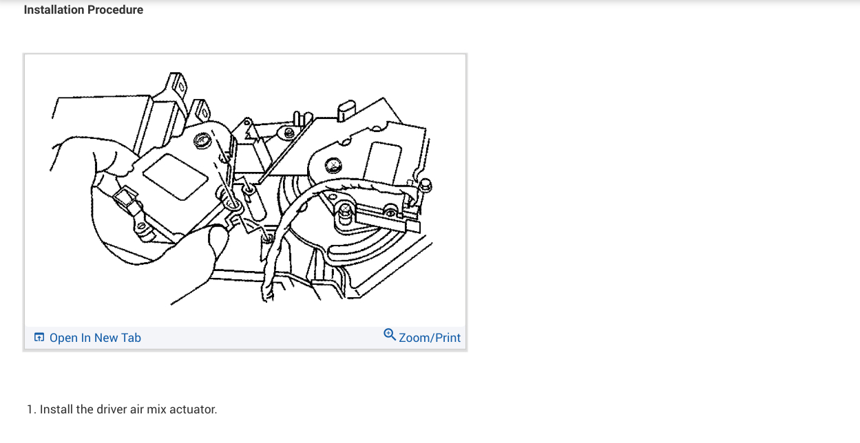

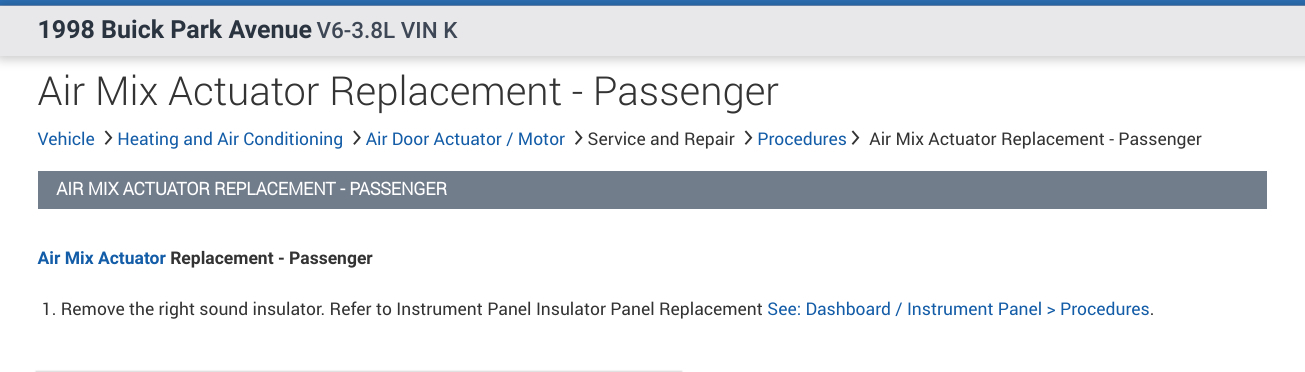

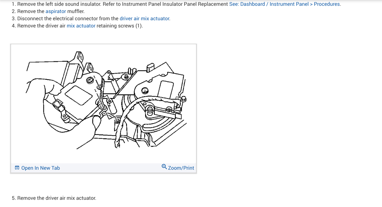

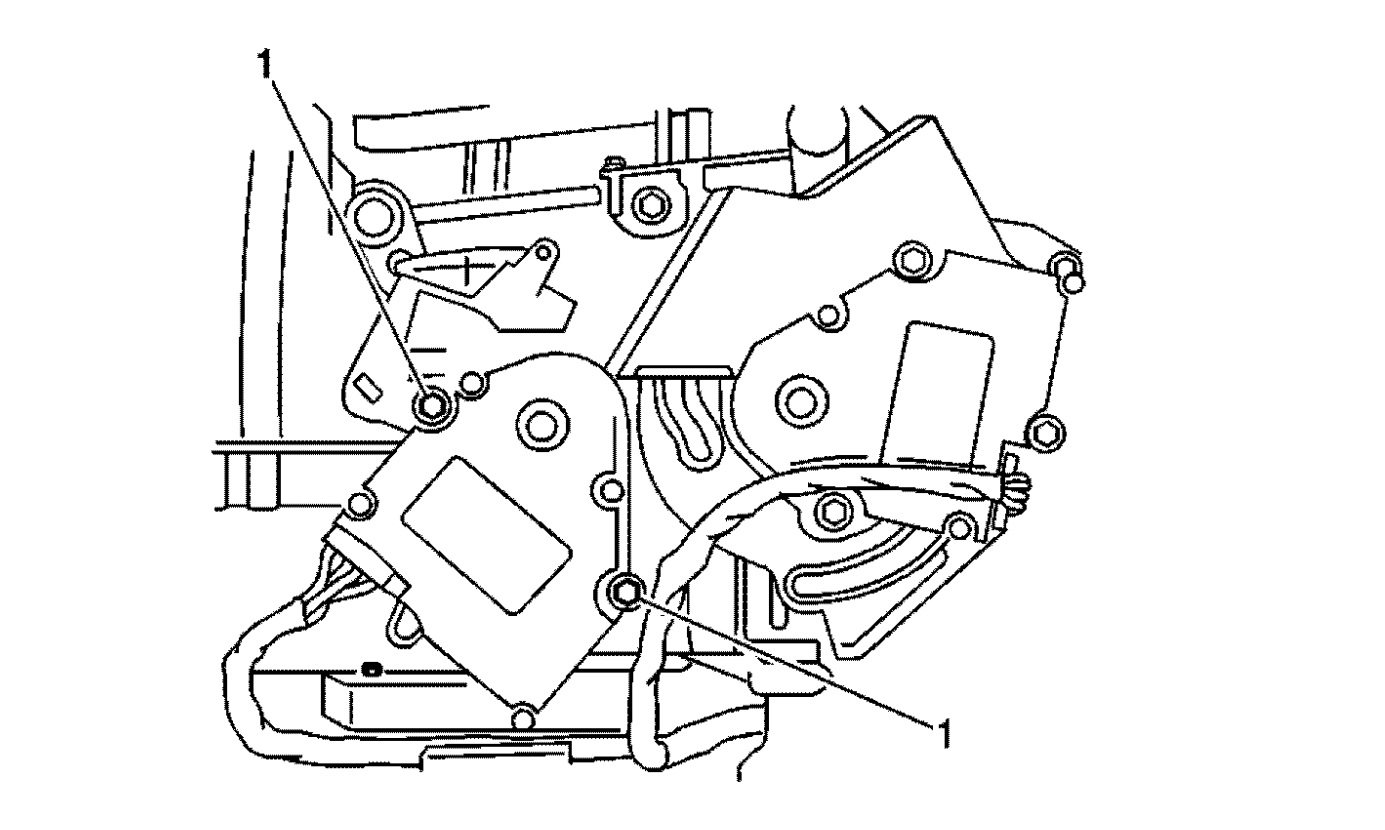

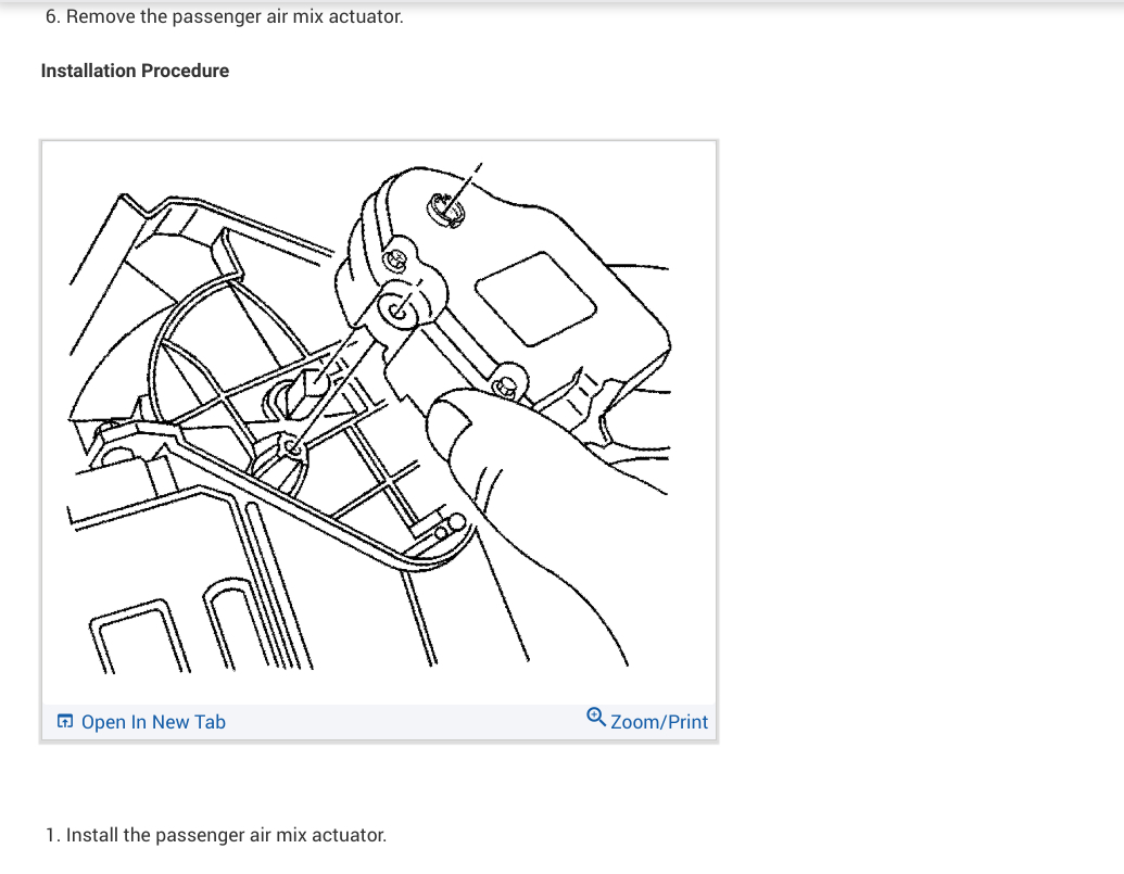

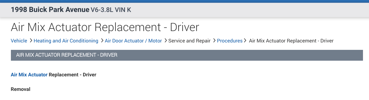

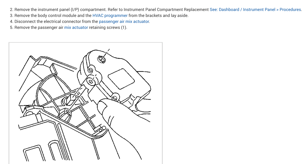

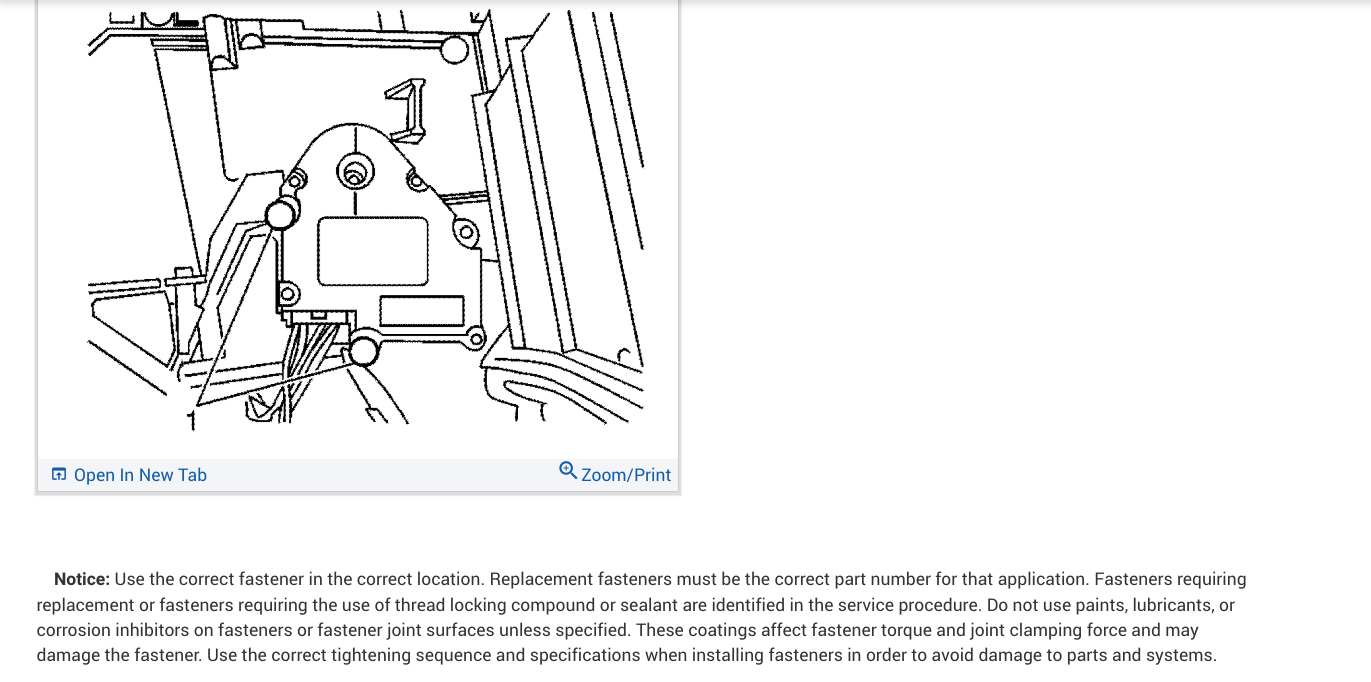

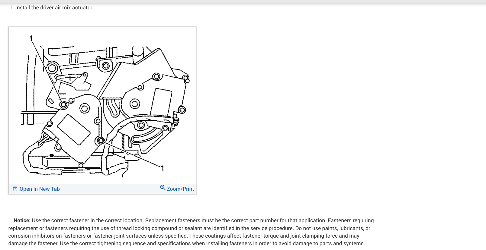

In the diagrams down below I have included the description of the HVAC actuators, their locations, and the instructions for the removal and installation of both the passenger and driver side air mix actuators for your vehicle. Please go through these guides and get back to us with how everything turns out. I hope that this helps.

I ended up disconnecting the battery to get it to reset. Then did the three minute with the key on the on position. I could hear the actuators resetting themselves. So that worked perfectly. Unfortunately the blend door actuator is clicking so i'm assuming there is something stuck inside and I'll have to pull it apart to get at the door to see whats blocking or stuck. Thanks, Don
if anyone just needs to reset Roy's directions worked perfectly. The only difference is I disconnected the battery.
Just know when you disconnect the battery the gas and temperature gauges fall behind the peg and you'll have to take a strong magnet to drag them back around.
