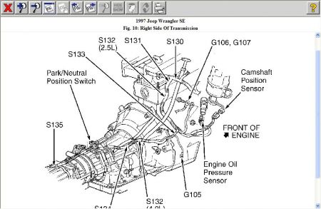

Do you have power to the coil and also did you check the camshaft position sensor in the distributor-This sensor is also used to synchronize the injectors.

I haven't checked the cam position sensor. You say it's in the distributor? I read that it was mounted on the front of the intake manifold. There is power going into the coil. I haven't checked for power at the harness of the injector. The scanner also reported no RPMs on crank.

This is 2.5L correct see below

Also, one more thing I forgot to add. I checked the repair manual that I have and it says that they didn't use the camshaft position sensor until 2000. So, if the manual is wrong and you are right PLEASE help me locate the sensor. I'm not questioning you, I just don't know where I'd find it. Thanks!
Thursday, September 24th, 2020 AT 6:20 PM
  • 75,992 POSTS
Check underneath the rotor button not there check on the upper and rear/back edge of the flywheel cover on the driver's side. 2 bolts holds it in

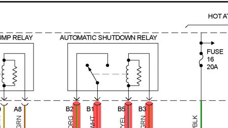

Test the auto shut down relay and get back
LIMPPEACE29
  • 14 POSTS
Relay itself is fine. But there is no power coming from it.
  • 75,992 POSTS
Check fuse no.6 30amp and test for power at B1 and B3 at ASD relay see below
https://www.2carpros.com/forum/automotive_pictures/12900_asd_2.jpg
LIMPPEACE29
  • 14 POSTS
I checked the fuse, checks out OK. I checked B3, there was constant power. I checked B1, there was almost 11V when cranking.
  • 75,992 POSTS
Turn key on and check for power at the injector/s dark green and black wire-Do you have it? If not retest the ASD relay the injectors gets its power from the ASD relay

Turn key to run at the ASD relay socket relay removed jumper B3 to B2 and recheck for power at the injector wire -do you have it-
