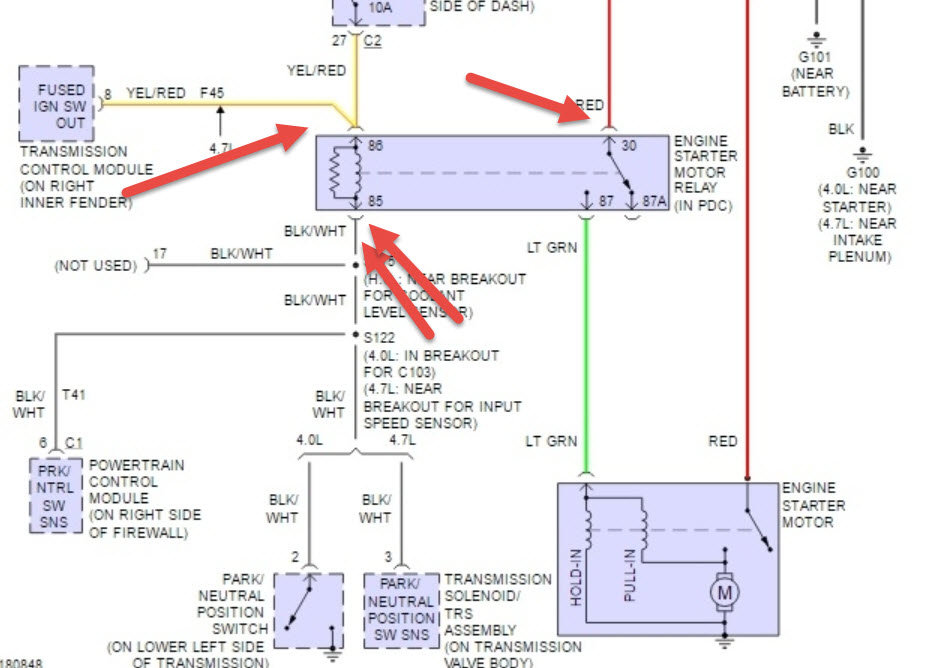

HMAC300
  • 48,601 POSTS
If you have no power going to solenoid and can jump it to start check neutral switch in CJ's drawing or the relay may be bad which you can quickly check by swapping another relay from PDC.

FLYNN-T
  • 35 POSTS
This is what I am thinking; I put a test light on the small wire from ignition to solenoid and when I turn the key to crank I have no power. Is there another way I can check my ignition switch without taking it all apart? And I hear a click coming from around the dash board by glove box when I turn the key to crank the engine, but still does not crank.
Monday, August 31st, 2020 AT 12:37 PM (Merged)
HMAC300
  • 48,601 POSTS
Get your test light and where single arrows are see if you have power with key on in those sockets. then where double arrow is have someone turn the key to start and see if that has power. it may be corrosion on relay or a PDC problem. I think the click you hear in dash is from the power-train module telling truck to start. you will need the relay out to check this and you can correspond with the the numbers which should be on bottom of relay. if you get power on all positions except where I have not marked it. It may be a fuse box problem or corrosion and it is not making good contact with relay. You may correct this by tweaking that one prong just a tad and cleaning any or all corrosion off as well as using dielectric grease on prongs for better contact. If there still is no power at unmarked position then it is either the fuse box is bad or the wire leading to starter has broken someplace which you can check with an ohm meter. i am also sending on how to check a relay along in link.
MAXIMILIAM
  • ADMIN
  • 436 POSTS
It was my actuator pin in my ignition-thank you very much-now I see my fuel tank skid plate is in very bad shape will it pass safety inspection if I put a couple of adjusting straps under my gas tank secured to the frame on each end thanks
