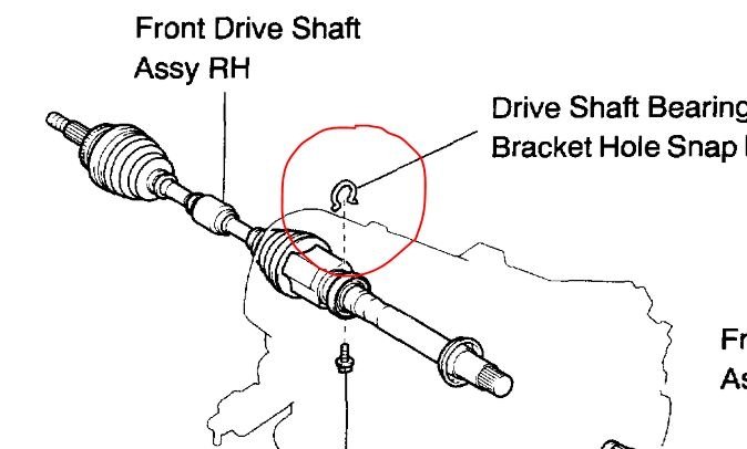

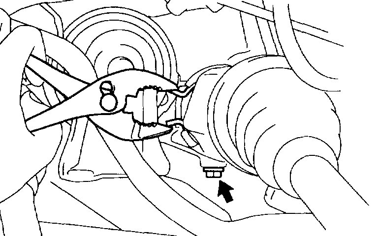

There should be a snap ring that secures it. See the attached pics. It shouldn't just come out like that. Most likely it will happen again.
Let me know if this helps.
