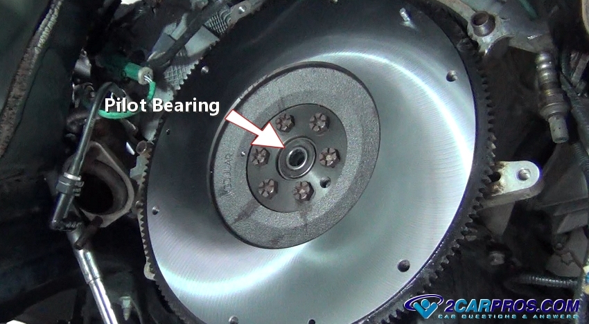

  • Pilot bearing failure: Will not allow the input shaft to stop turning, (RWD only)

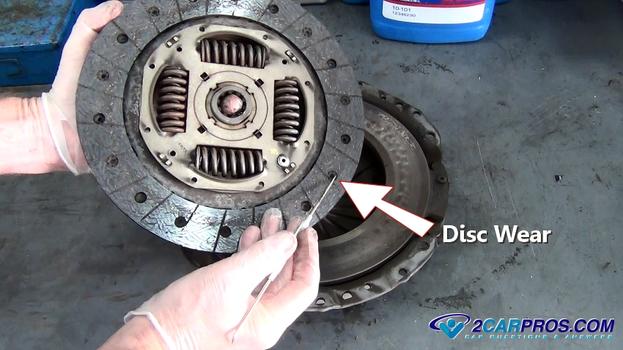

Slipping Clutch
The clutch disc and pressure plate are subject to wear over time due to friction during engagement and disengagement. A clutch is a normal wear item and should be replaced between 90k and 140k in most cases. When a clutch disc fails, the disc lining can become worn which will make the clutch slip, while not allowing the power of the engine to transfer through to the transmission. In this case, the clutch must be replaced.
clutch disc wear
