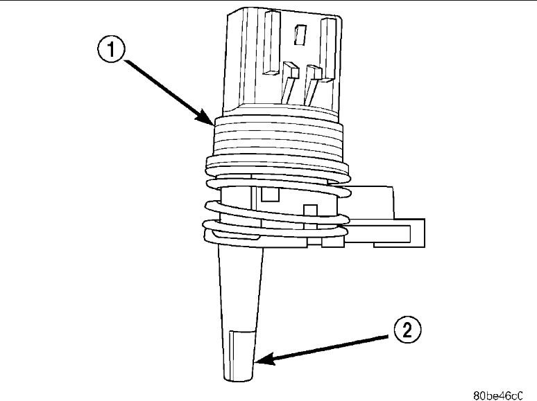

Is the range sensor and transmission temperature sensor share the same connector? Can you tell me where the transmission temperature sensor connector is at?
Thursday, July 5th, 2018 AT 8:08 AM
The temperature sensor is part of the range sensor.
Yes, they share the same connector.
Number two in the picture. The rest is the range sensor.
Thursday, July 5th, 2018 AT 8:17 AM

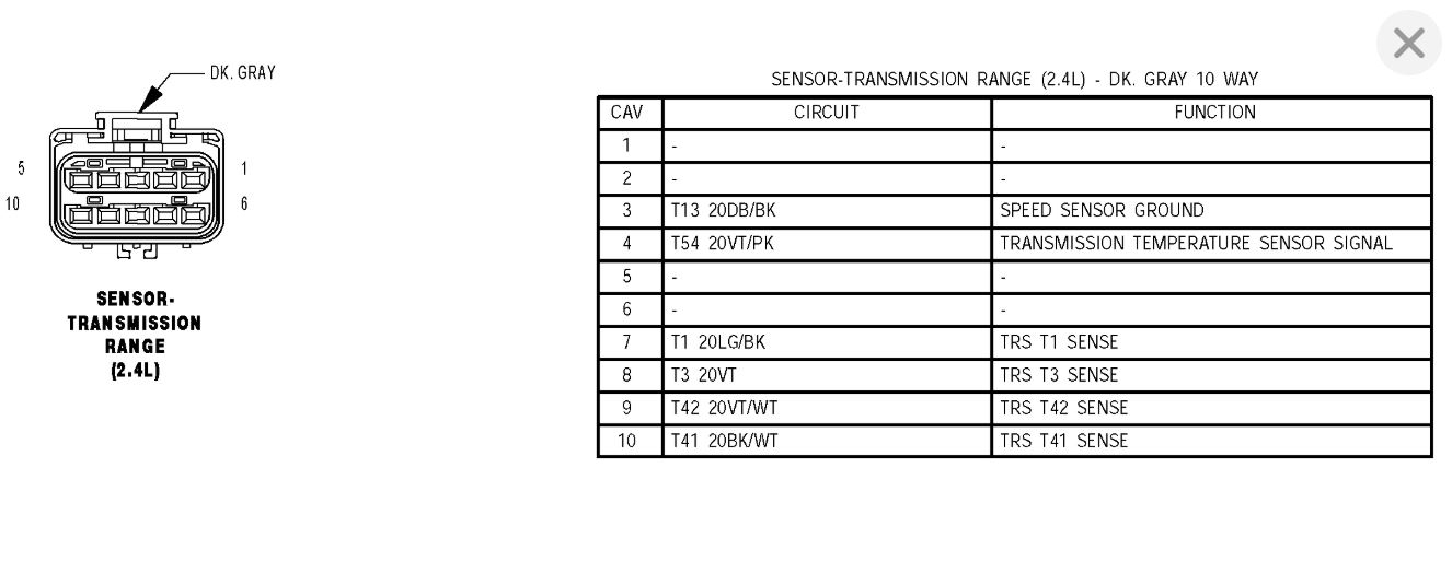

How many pins the connector has and which ones are for the temperature sensor?
Thursday, July 5th, 2018 AT 8:19 AM
Diagram attached of the connector and pins.

I have a code reader but does not show the transmission temperature. I want to check resistance of the sensor so number four is temperature signal wire and they both sensor shares a ground right?
Thursday, July 5th, 2018 AT 8:30 AM
Code reader is not a scan tool.
Check the resistance from the terminal to a good ground. Since it is a temperature sensor, it will vary according to temperature.
There is no chart for resistance according to temp that I can find. Thats why you need a scan tool to monitor the actual reading and compare to the temp of the fluid with a lazer temp unit.
