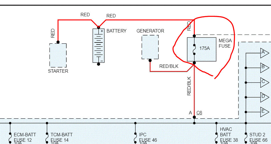

Started engine to move vehicle and it stalled after only a few seconds. Tried to start again and have no gauges working no power to starter wont even click. Where do I look now?
Mar 17, 2020 at 1:09 PM
  • CAR REPAIR CONTRIBUTOR
  • 110,190 POSTS
Since it started and then stalled, we have to assume the battery it charged. Have you checked to make sure the battery terminals are clean and tight? Also, check the mega fuse in the under hood power distribution box. See picture 1.

Switched out start relay and everything stared to work. Switched it back to see what would happen and it still is working.
Mar 21, 2020 at 12:40 PM
  • 110,190 POSTS
Remove the relay and check the conditions of the pins in the box. One may be pushed in and not making good contact or there could be corrosion.
