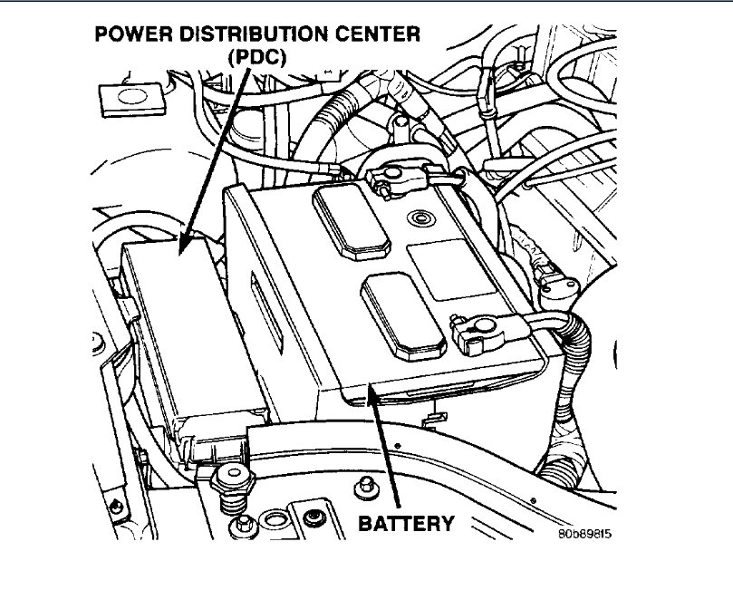

Car was working fine. I change camshaft and crankshaft sensor I put Mopar. I cleaned the idle control valve and it worked 5 minutes and stopped. Since then can't start.

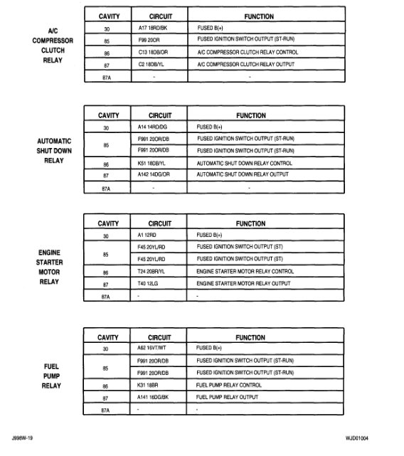

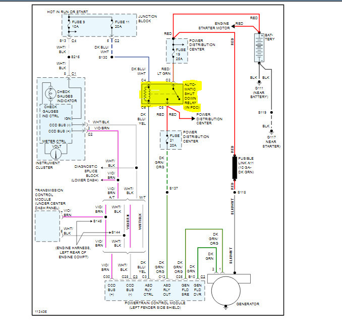

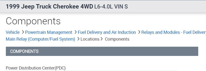

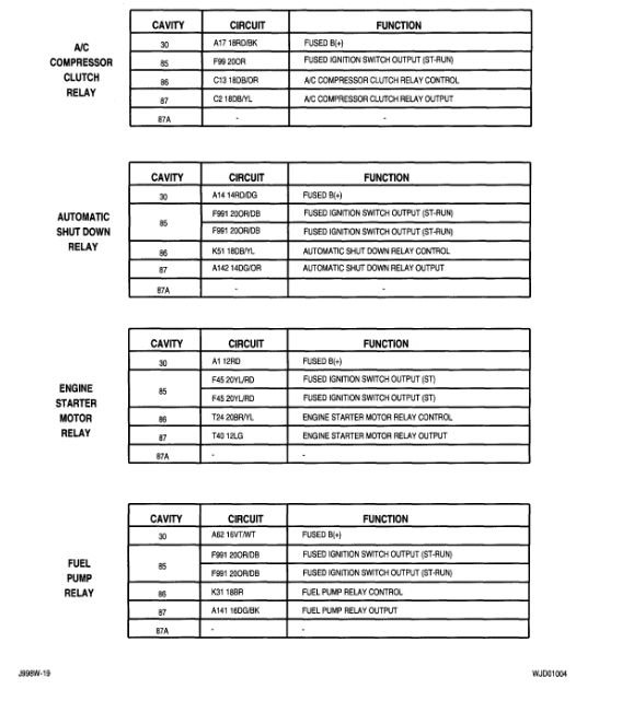

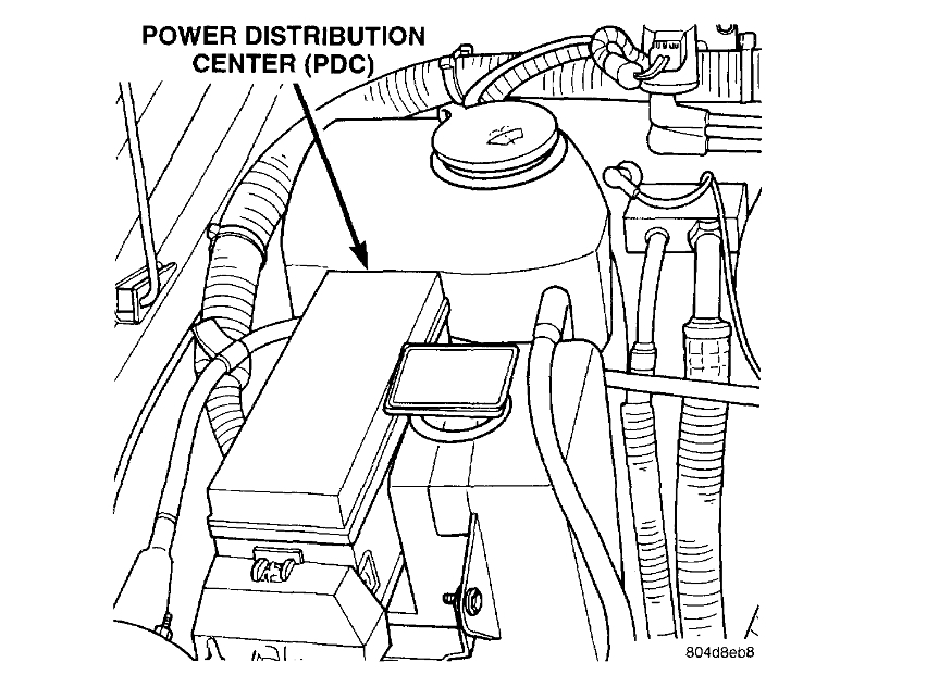

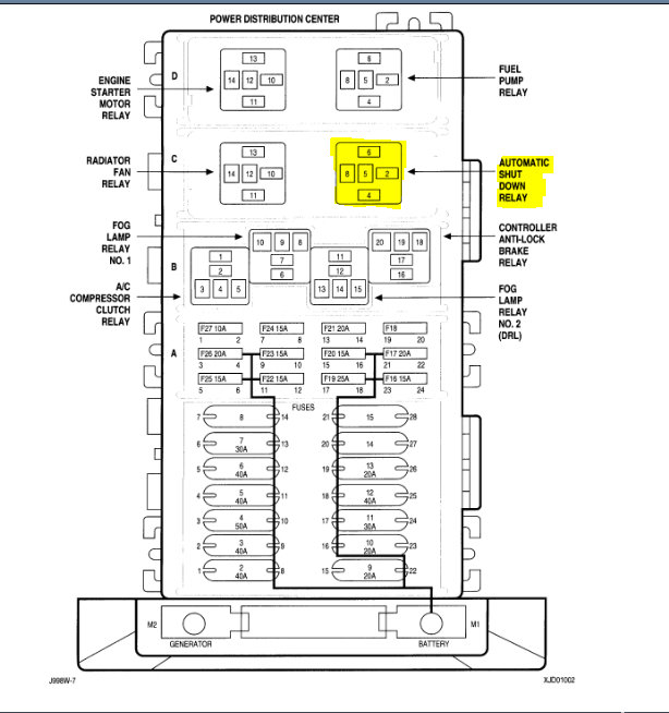

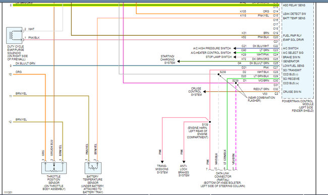

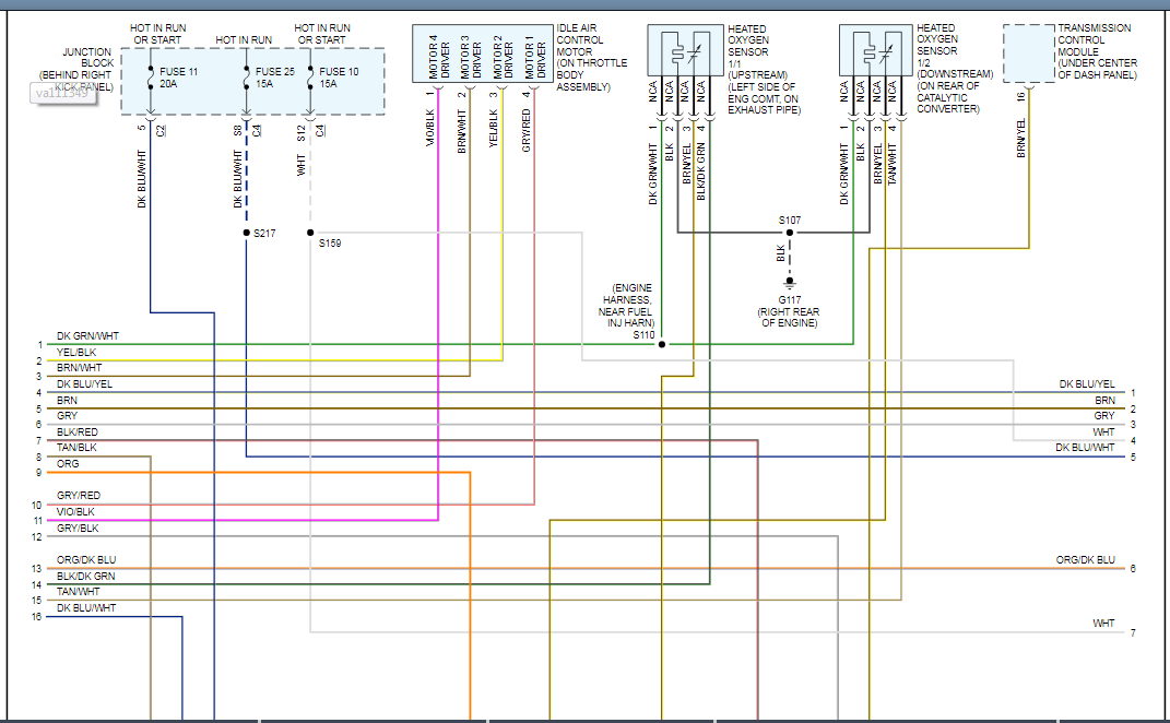

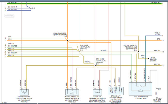

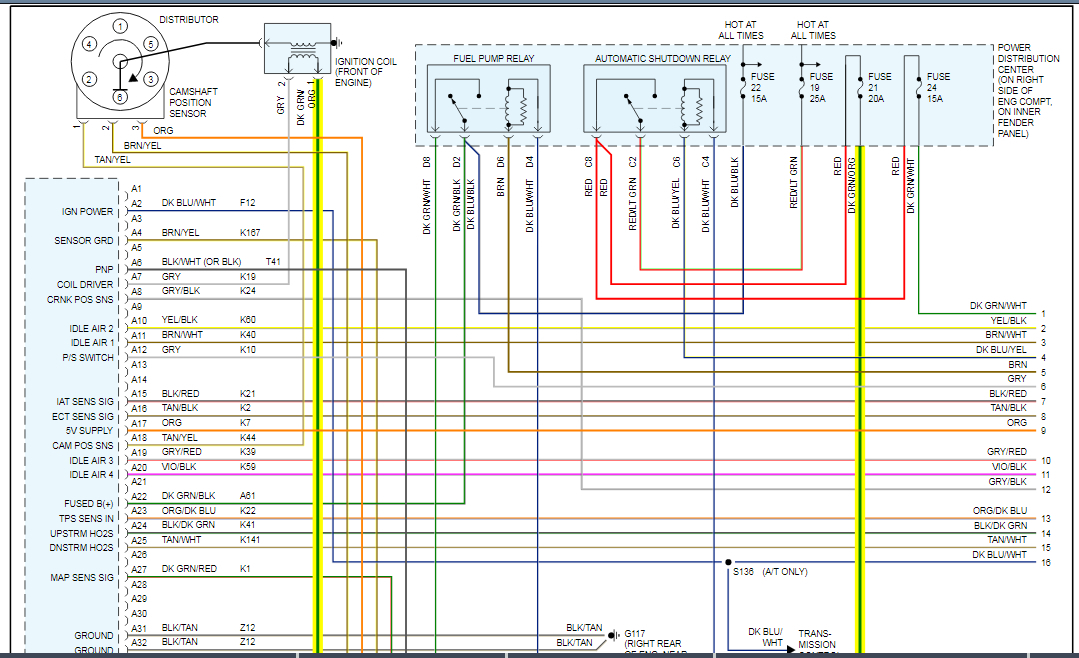

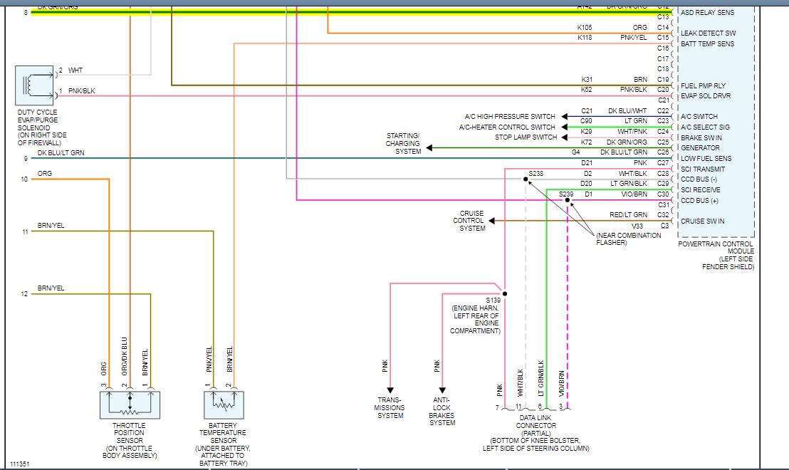

This sounds like your vehicle could be having an issue with the Auto Shut Down[ASD] Relay failing. In the diagrams down below I have included a wiring diagram of your vehicle's charging system wiring diagram, and the location of the Power Distribution Center[PDC] and a diagram with callout of the PDC[showing the ASD Relay]. Please test the ASD Relay and then report back with what you find out. Here is a link explaining how to do that below:
When you turn the key to the on position without cranking the engine over can you hear the fuel pump run in the tank for 5 seconds?
Thanks,
Alex

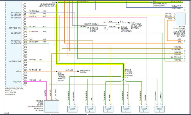

CASCHOM
  • 27 POSTS
I change the ASD relay, made most of the test check fuses =okay, still not working. The injector have no electricity and don't click when tested, have no code reading.

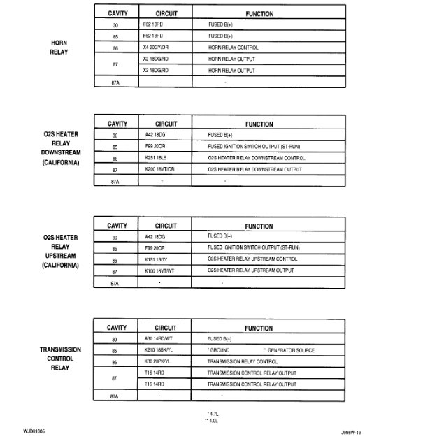

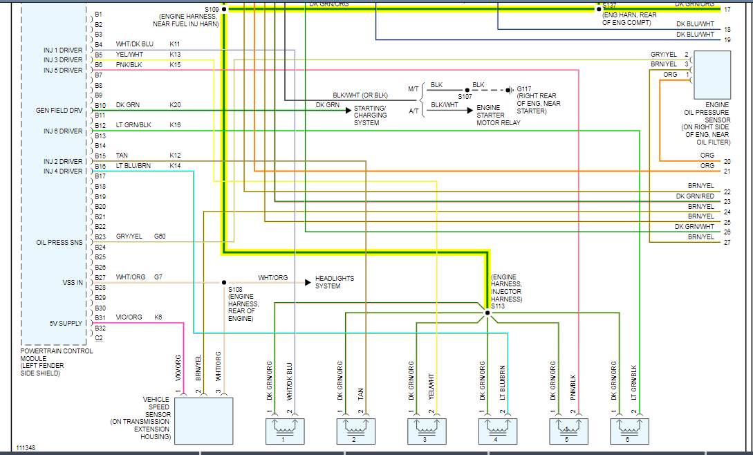

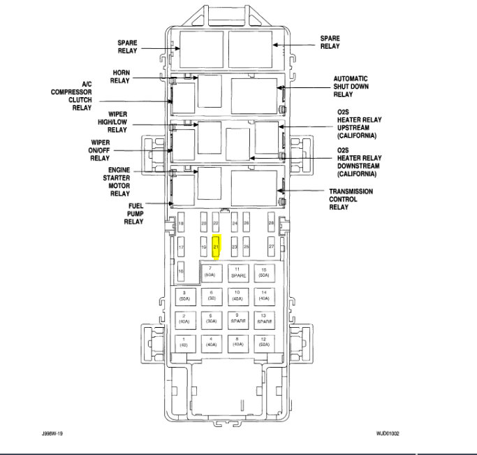

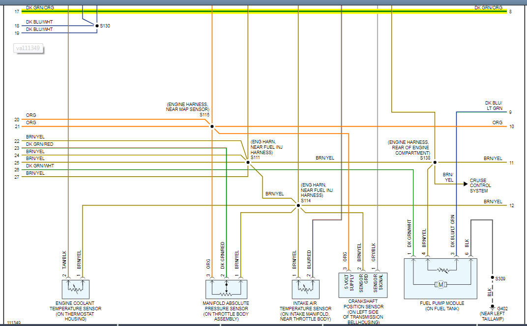

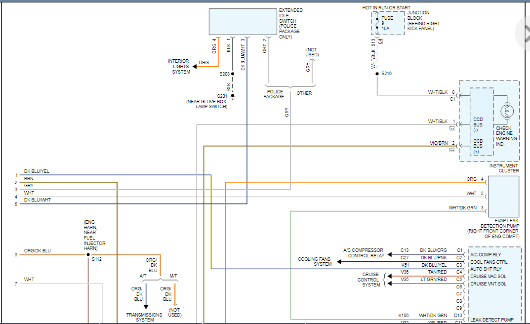

Okay, that's good. Next can you please check fuse 21 in the Power Distribution Center, which is next to the battery in your vehicle. In the diagrams down below I have included diagrams with the location, layout, and callout for the Power Distribution Center[PDC] for your vehicle, and the wiring diagrams for your vehicle's Engine Management for reference for you as well. Here is a link below, if needed, on how to check a fuse:
Please go through these guides and check fuse 21 and get back to us with what you find out. We can go from there, if necessary.

Fuse 21 test okay, good.
Monday, November 4th, 2019 AT 8:21 AM
SCGRANTURISMO
  • 4,897 POSTS
Hello again,
Okay, can you please check fuses 19 and 24 for me in the Power Distribution Center for me as well too, please.

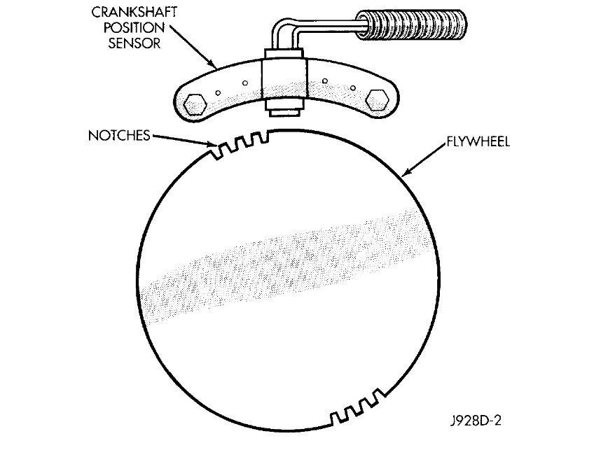

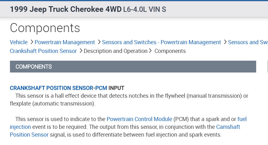

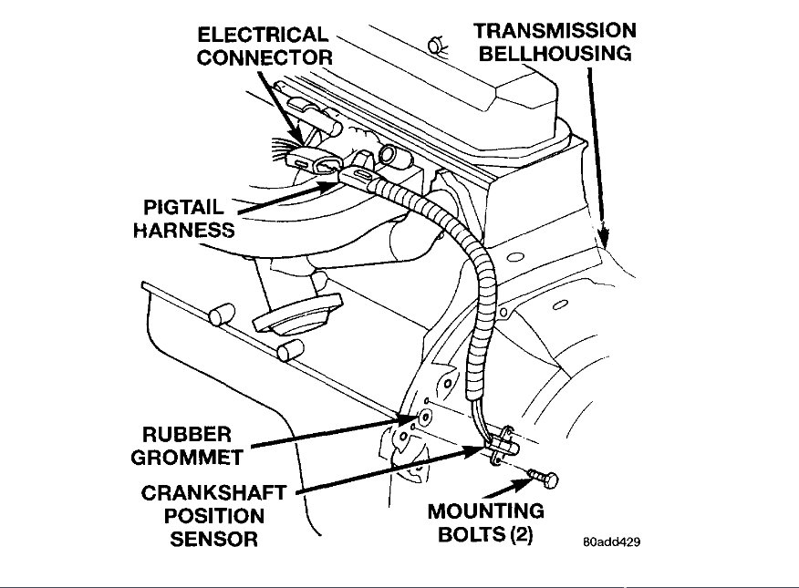

CASCHOM
  • 27 POSTS

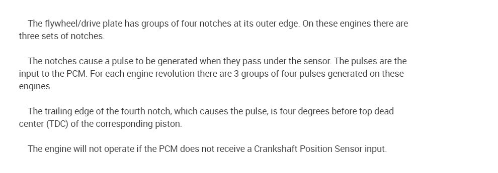

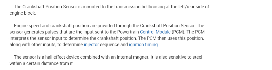

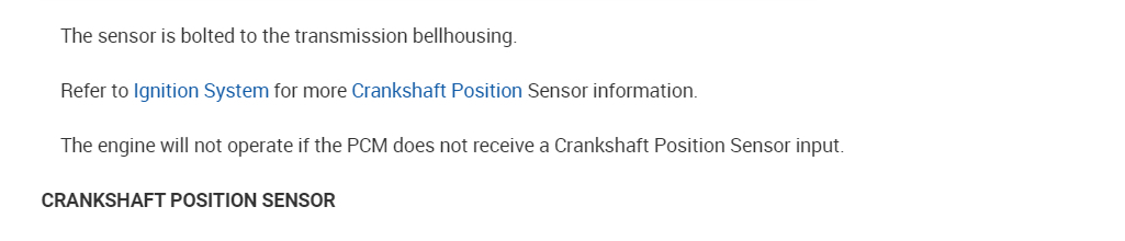

A mechanic came and found the crankshaft sensor loose, the bolt was not tight, he took it off to double check the quality of the part, and put it back, the spacer was still there but he wanted to take it off, he was insisting that the spacer glued to the sensor was not important when I remember reading the contrary, the car still didn't start after he put it back, after he left I tried starting again that's when it wont turn at all after a few try. I wonder if there is a link between the spacer maybe missing and the complete failure of the starting system. If the spacer is that important and missing where can I buy it since its a brand new mopar CKS?
Sunday, November 24th, 2019 AT 5:26 PM
SCGRANTURISMO
  • 4,897 POSTS
Hello again,
I have included in the diagrams down below the description of the Crankshaft Sensor[CKP] for your vehicle. If your vehicle is not getting the CKP signal your vehicle will not start. I would recommend replacing the CKP sensor in your vehicle. Please go through them and get back to us with how everything turns out.
Thanks,
Alex
2CarPros

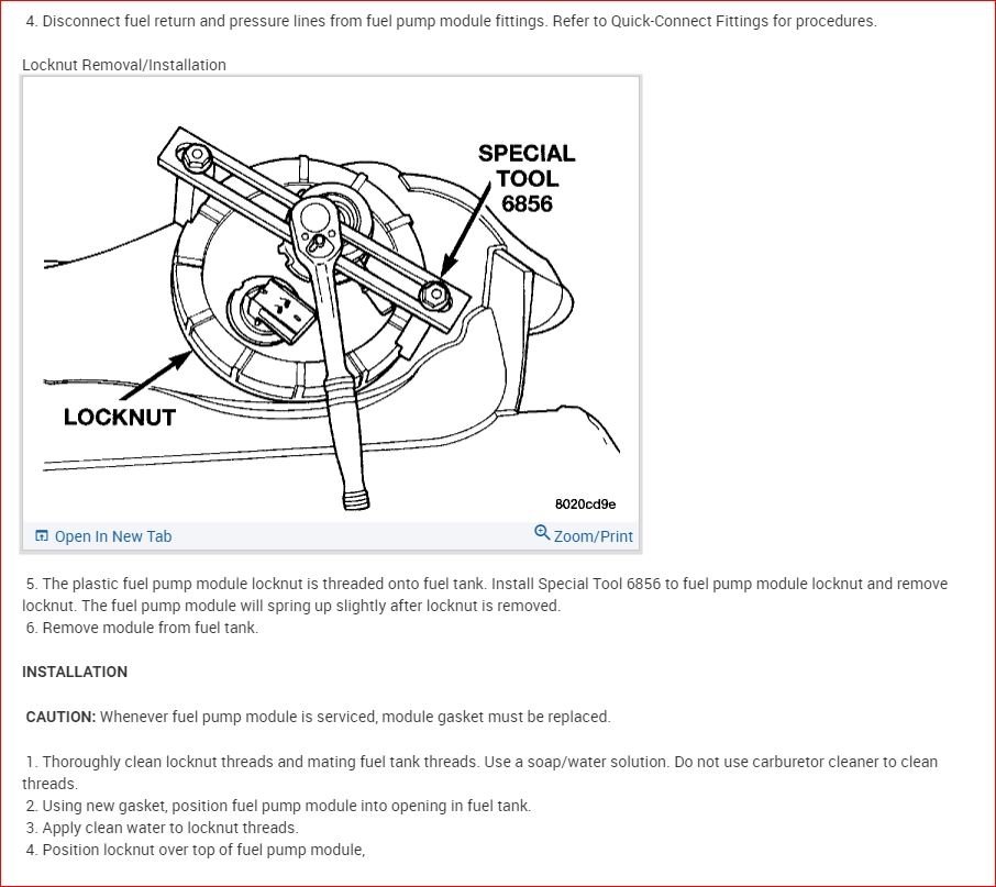

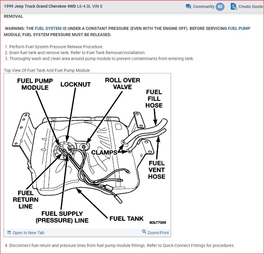

I turn her over and over. I hear the fuel pump come for a second then try and start but no start. I am wondering if may be the float stuck or the filter is clogged?
Sunday, August 30th, 2020 AT 10:49 AM (Merged)
Hi Michael,

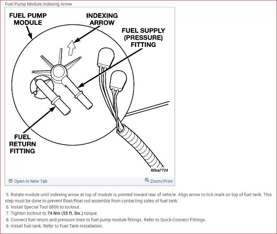

If the pump is not continuing to run then you are not building pressure. I would put a fuel pressure gauge on it just to confirm. One other way to confirm it is fuel is to spray starter fluid in the intake and see if it fires until that is gone. If so, then you will probably find low fuel pressure. At that point, it could be a plugged filter so it can't hurt in trying to change that.
Keep in mind, if the filter is clogged that could have worn out your pump. So if you are changing the pump, I would just put a fresh filter on it to be safe.
I included the procedure on how to replace it if that is what you find.
https://www.2carpros.com/articles/how-to-replace-an-electric-fuel-pump
