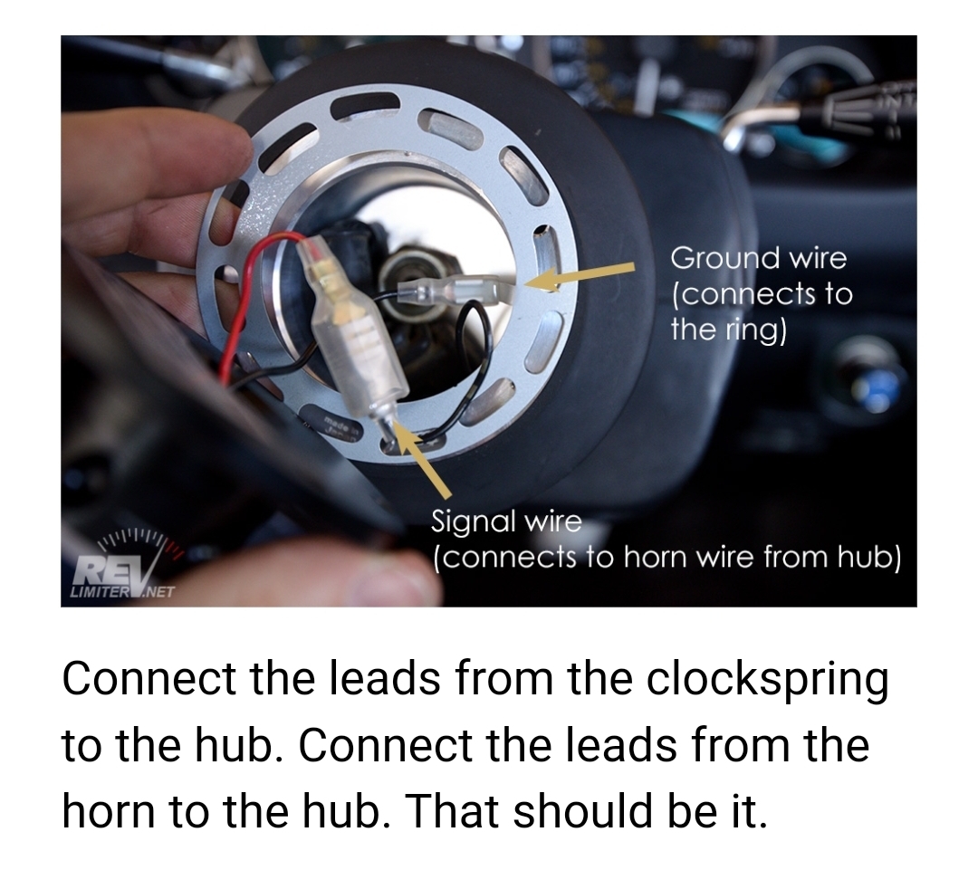

Roy, I found the pin on the clock spring for the horn signal. It was on the opposite end of where it plugs into the stationary part of the clock spring 8n the back. I made a connector and slid it onto the pin and it is secure. When I touch it to a ground, the horn sounds, but when I touch it to the ground of the hub, I get nothing. The horn should sound when even touching both wires together. I enclosed a picture that was sent to me by NRG of what the connections should look like and that is what I have. Why shouldn't I be getting a good ground where the steering wheel bolts to the column? That always works.
Friday, May 29th, 2020 AT 11:11 AM (Merged)
  • 52,797 POSTS
Then that hub is not grounded. If it was, the horn would work.

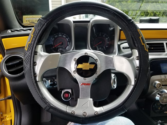

ROBERT MASELLI JR.
  • 52 POSTS
Hi Roy. The steering wheel project came out great with all your help. I was wondering if you could give me some info. On the next project. There is no rush, so take your time on finding the info. Of course I lost my cruise control going to an aftermarket wheel. I'm going to rig up a new area on the dash to wire up the cruise control. I bought 3 LED switches. One regular on/off and two momentary switches. I need to know, whether on the column or under the dash, which color wires are for cruise on/off, set, resume, accel and ignition. I believe each button needs to be connected to the ignition wire. The brake should also still turn off the cruise, but not concerned about that if I can still turn it off from a button. If you can be a help towards this, it would be fantastic. Thank you
