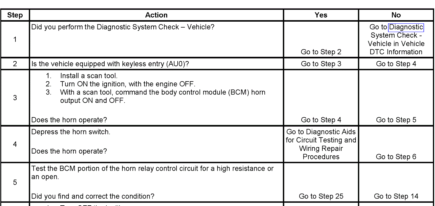

Horn does not work
2005 PONTIAC SUNFIRE
80,000 MILES • 4 CYL • AUTOMATIC
CLARA WHITMORE
i have checked the fuse and it is fine.

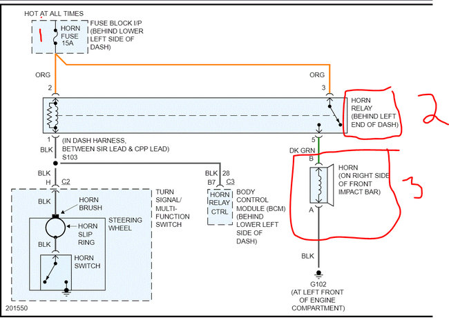

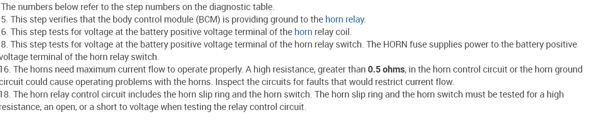

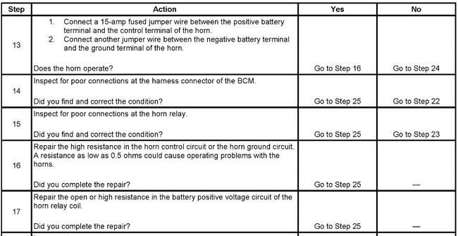

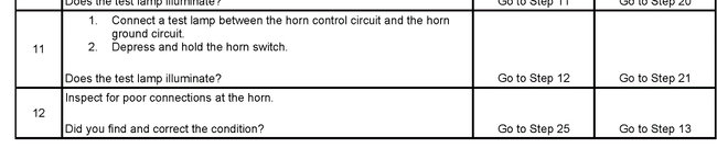

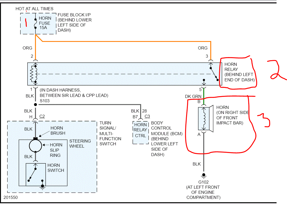

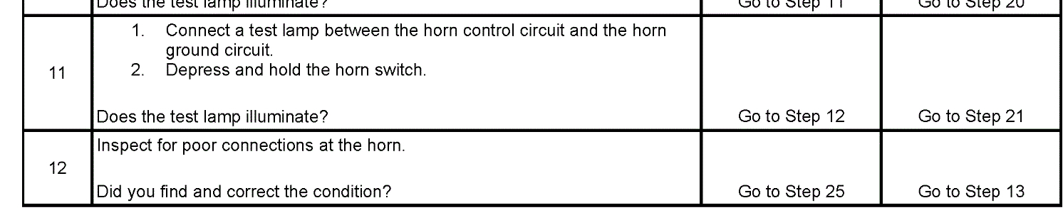

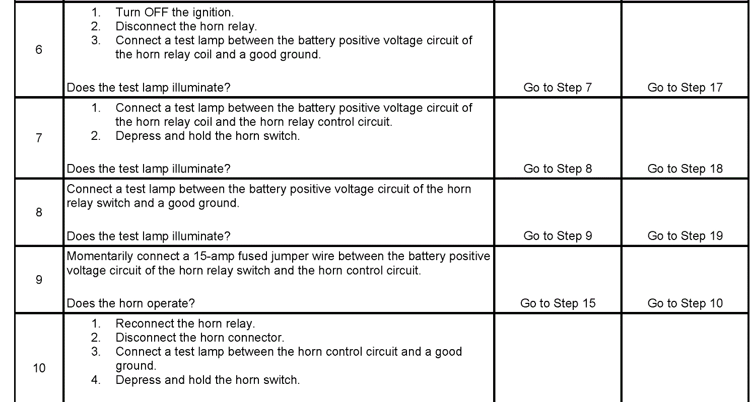

First, take a look at picture 1 and check the things in the order I indicated. Here are a few links you may find helpful:
___________________________

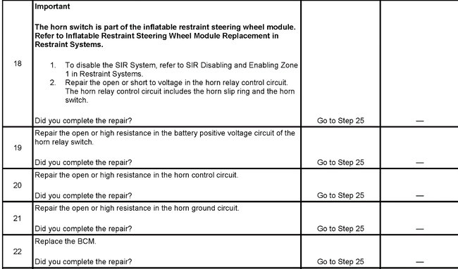

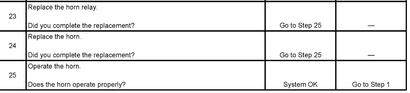

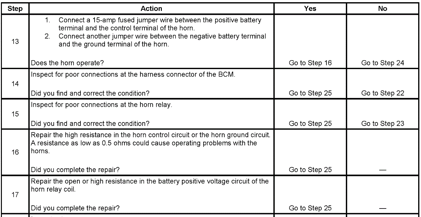

If everything checks good, then you need to follow a diagnostic flow chart. I attached all of the directions below. One of the things is suggests first is to check for diagnostic trouble codes. I don't know what kind or if you have a scanner. This will require one that is a bit more complex.
Regardless, do this and let me know what you find or if you have other questions.
