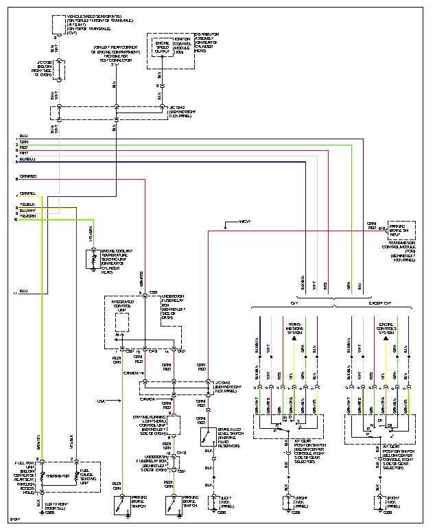

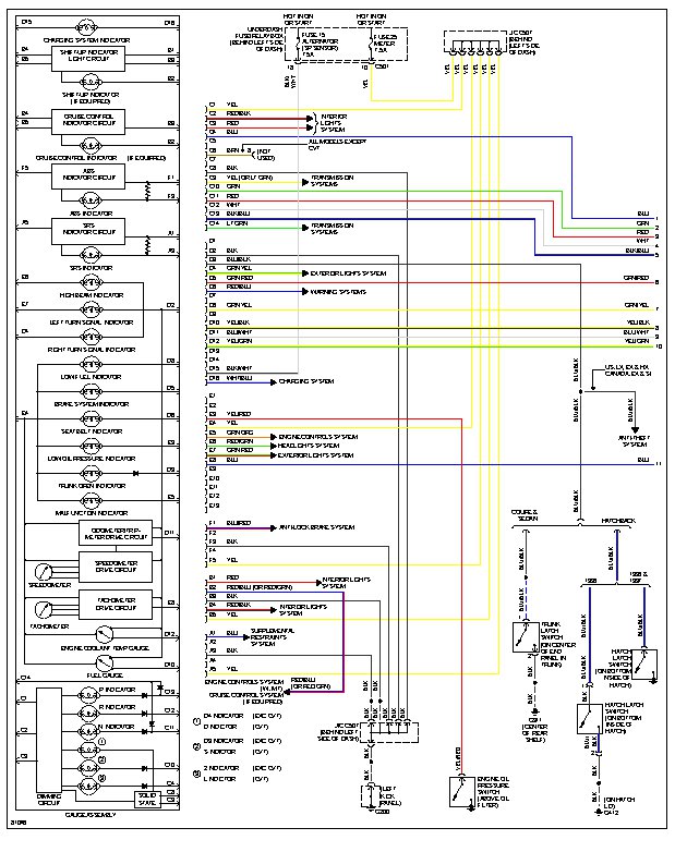

DRCRANKNWRENCH
  • 3,380 POSTS
I am giving you the wiring diagrams for the instrument panels. They are in 2 parts. Use them to look for short or bad ground.
