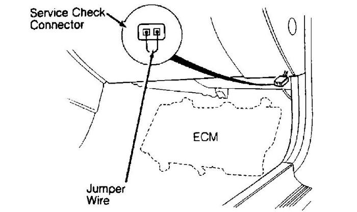

If the S mode indicator is blinking while driving, an error has been detected by the TCM.
You need to retrieve the trouble codes.
Flip up the passenger carpet under dash and locate a round sight glass.
Turn ignition switch on and note the blinking pattern to get the trouble code.
Quite often when transmission fails to shift for the year model, it is due to a faulty TCM.
Sep 26, 2020 at 11:57 AM (Merged)
GOSSMAN548

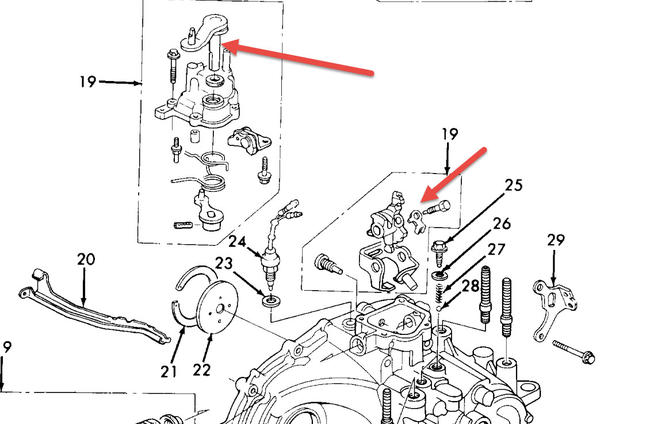

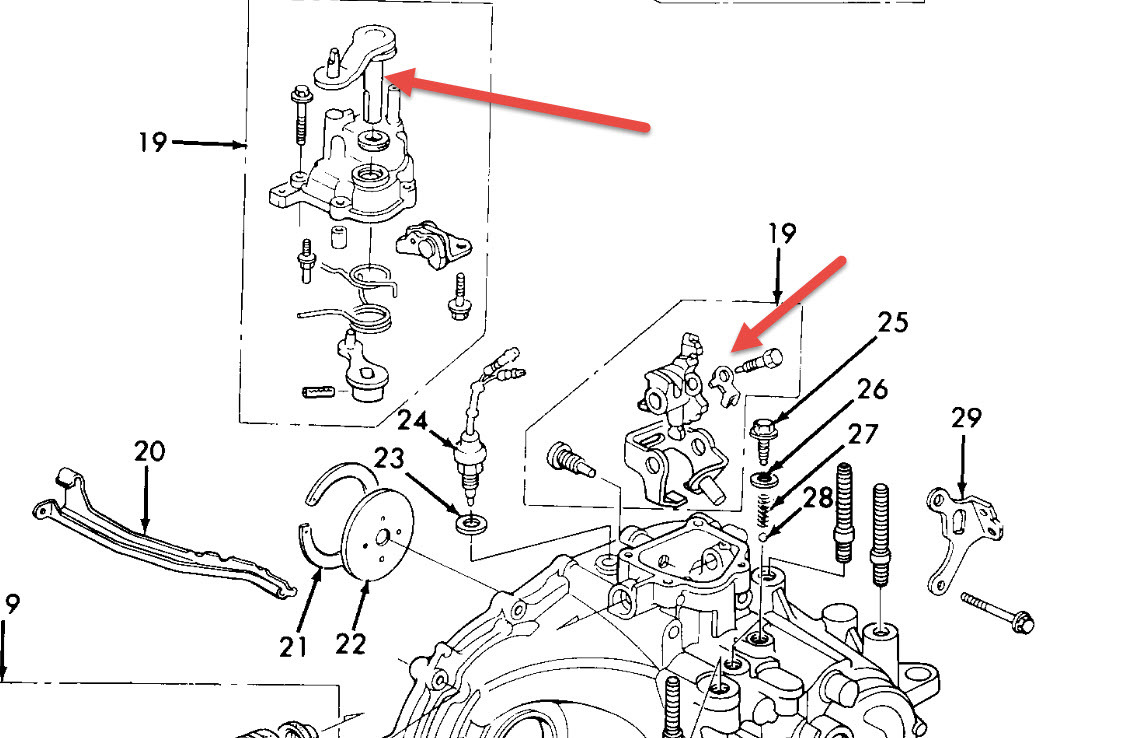

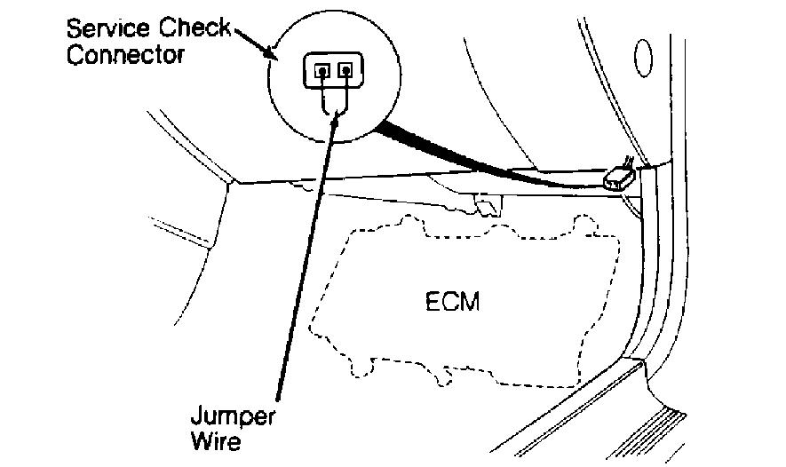

The S light doesn't blink. It's solid.I,m having a hard time finding the wire to jumper to get codes.Does the wire unplug from something, or is it a loose wire. The interlock relay and stick shift solenoid chatter, with the ignition on.
KHLOW2008
  • CAR REPAIR CONTRIBUTOR
  • 41,814 POSTS
For the year model, the TCM should have a LED light.
Flip up the passenger side carpet.
Turn ignition ON and note the blinking of the LED from the view window (round hole) on the ECM cover.
Count the blinking of the LED to get the code.
Under the shift lever there is only the interlock solenoid. Does it chatter only with the brake pedal depressed? The solenoid is not linked to TCM. Only to the brake switch and gear shift position.
Is the D4 and other indicators lights working correctly?
Erratic shifting could also be a fault with the TPS. Get it tested for smooth movement and correct voltage.
