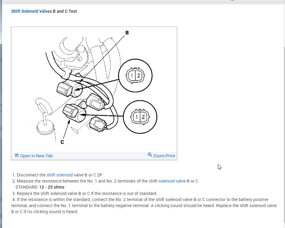

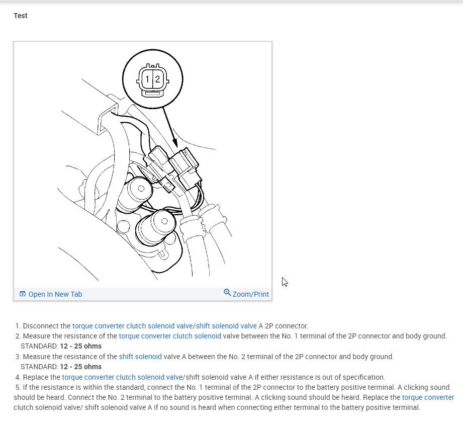

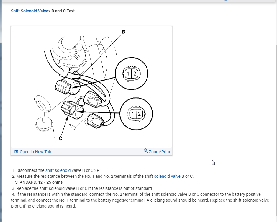

When putting the transmission into drive or reverse there is a little lag then engages hard. It shifts fine in all other gears but when coming to a stop it shifts hard again into 1st and there is a slight lag then engages hard again. So far all I did to try and rectify this was change out the transmission fluid once with recommend Honda transmission fluid. No help, still does it.
Saturday, September 26th, 2020 AT 10:52 AM (Merged)
If the fluid is okay then I would next suspect the shift solenoids. I attached the testing procedure for the solenoids. Let's run through this and we can go from there.
Let me know what questions you have. Thanks
