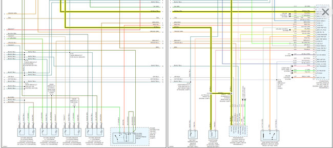

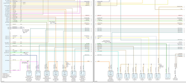

Got the crankshaft and camshaft sensors in. Still cranks, won't start, tachometer and fuel gauges don't budge. Think I may not have told you that when I'm not getting electricity to the new fuel pump. I had to rig up a bypass to the battery using an alternate fuse and relay. So for some reason no current to fuel pump (without bypass) and injectors not coming on.
Monday, October 26th, 2020 AT 7:54 AM
  • 52,797 POSTS

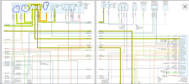

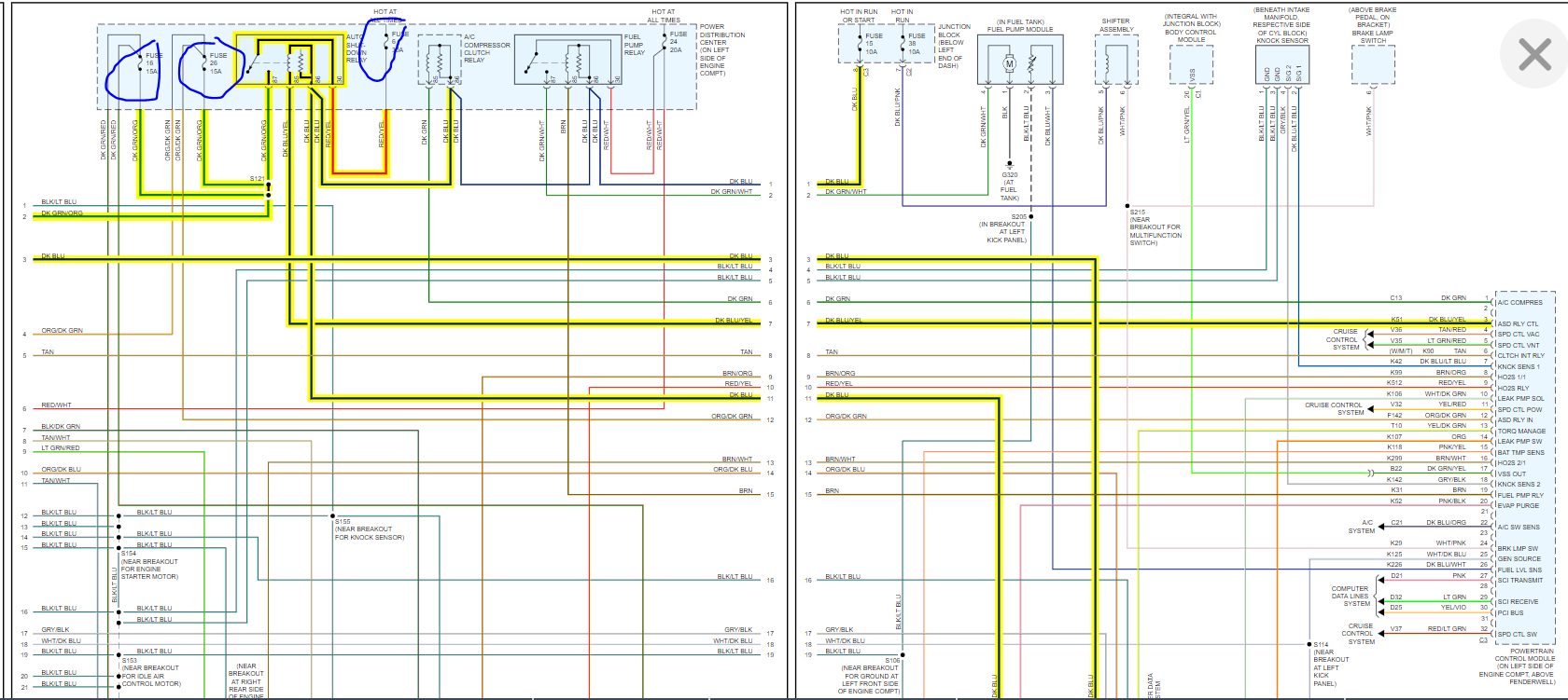

Okay, I attached the wiring diagram of the system for you.
Check the fuses I circled as they are feeding the ASD relay. That is the relay that provides power to all the ignition components.

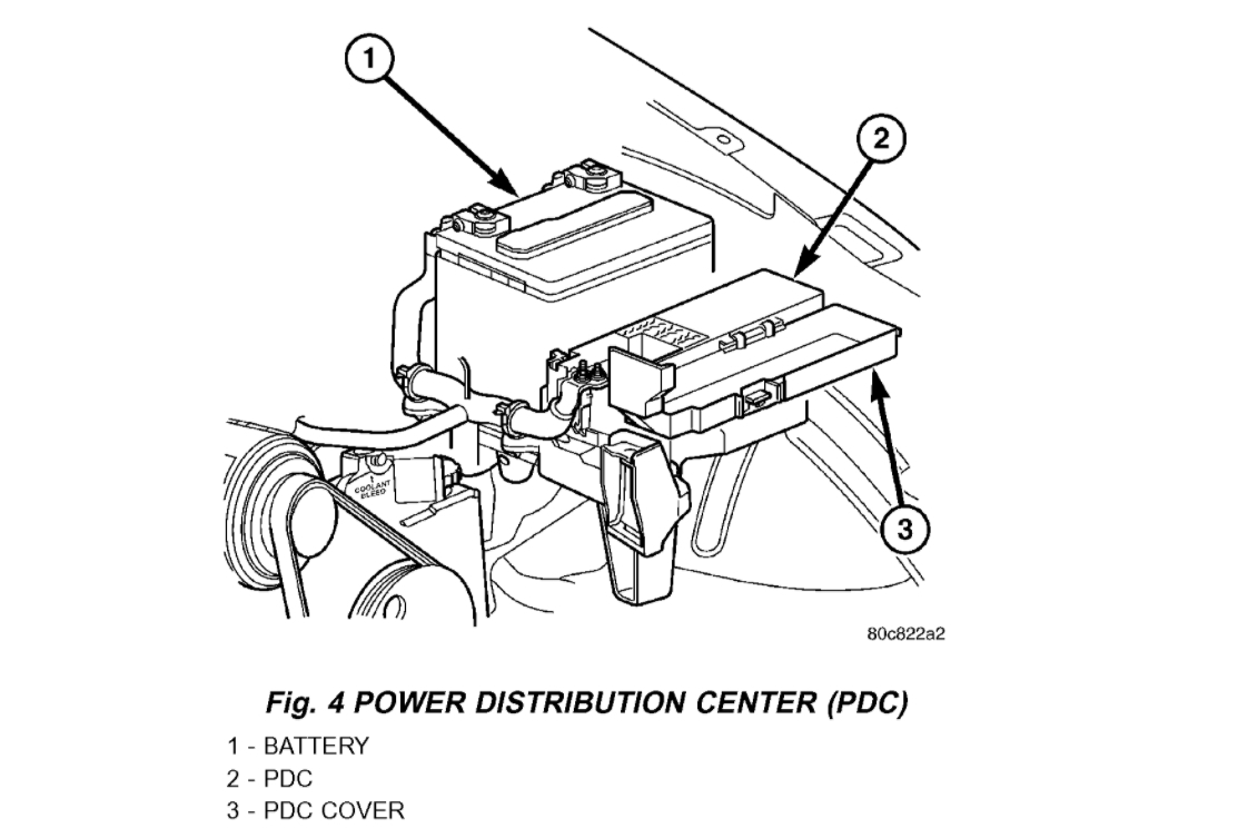

REMOVAL
The ASD relay is located in the Power Distribution Center (PDC). Refer to label on PDC cover for relay location.
1. Remove PDC cover.
2. Remove relay from PDC.
3. Check condition of relay terminals and PDC connector terminals for damage or corrosion. Repair if necessary before installing relay.
4. Check for pin height (pin height should be the same for all terminals within the PDC connector). Repair if necessary before installing relay.
INSTALLATION
The ASD relay is located in the Power Distribution Center (PDC) Refer to label on PDC cover for relay location
1. Install relay to PDC
2. Install cover to PDC

I only see 3 fuses circled. Is that correct?
Monday, October 26th, 2020 AT 9:23 AM
  • 52,797 POSTS
That is correct.
Verify power on both sides of the fuses with the key on.

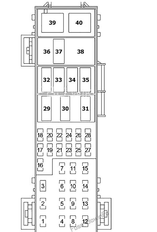

Confused. It looks as though the fuses circled are 16, 26 and 6? (Not clear). The schematic I downloaded for the PDC layout says 16 is open, 26 is injectors and 6 is the ASD fuse. My concern is that 16 is open (no fuse) according to my download.

Okay, on the same web page, the PDC diagram for the optional diesel engine says 16 is an ASD Feed fuse. Sounds like the diagrams may have been mis-labeled.
