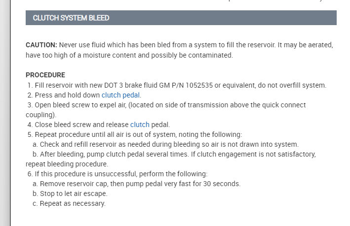

I replaced my clutch slave and can't seem to bleed properly. Can anyone help with the proper procedure? Thank you

I will attach the process below for this as it is not much different than bleeding the brake system.

Please see the attached info. If you are still having issues, then more than likely we have a defective part so let's start with this and go from there.
