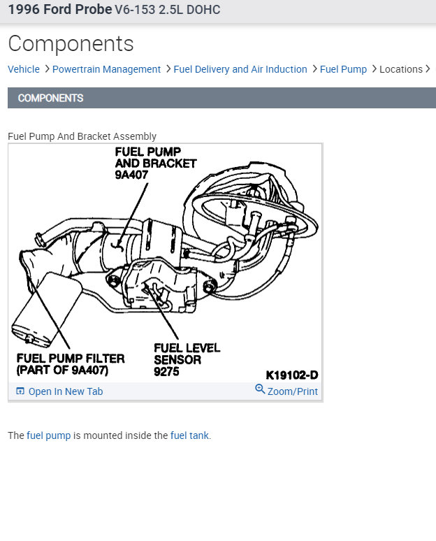

Are you able to hear the fuel pump, when the key is in the on position?
One thing you can check, spray starting fluid in the intake. Then try to start it. If it starts for a little bit and stalls, then the issue is fuel delivery.
https://www.2carpros.com/articles/car-not-running-advanced

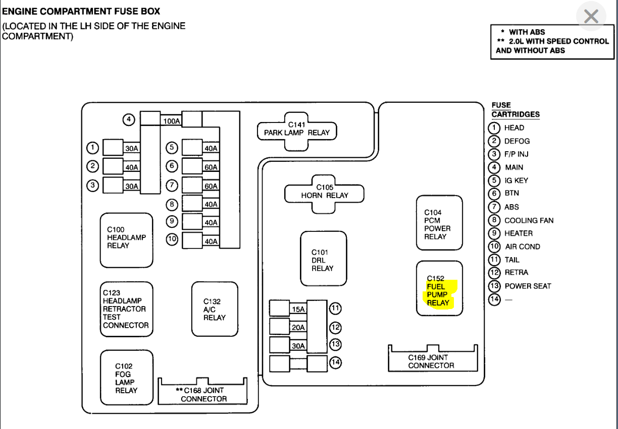

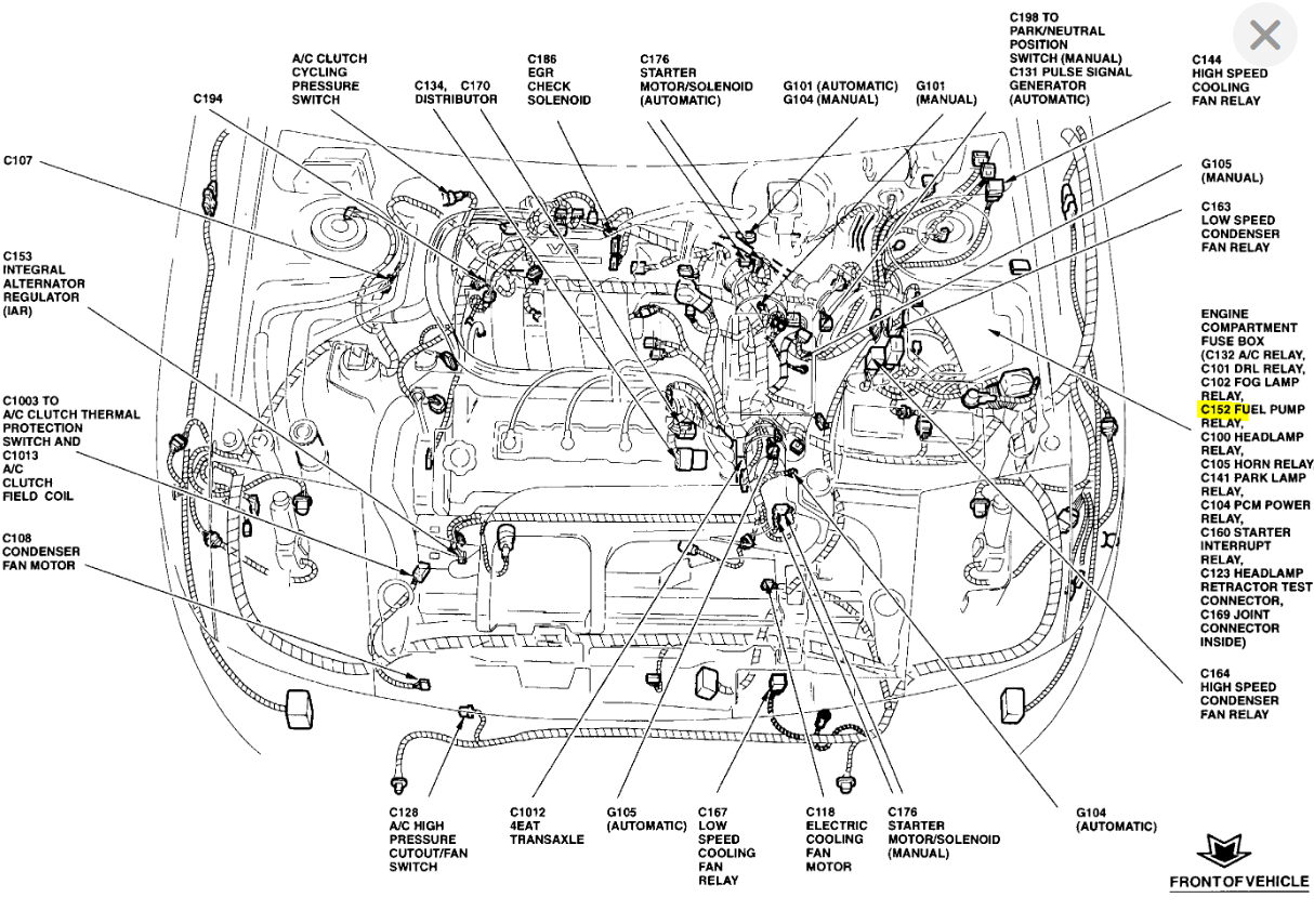

Inoperative fuel pump can be due to a bad relay, wiring issue or a bad pump itself.
First check the relay, it is located in the fuse box under the hood (see diagram below).
Check for any corrosion or burnt pins.
You can also test the relay.

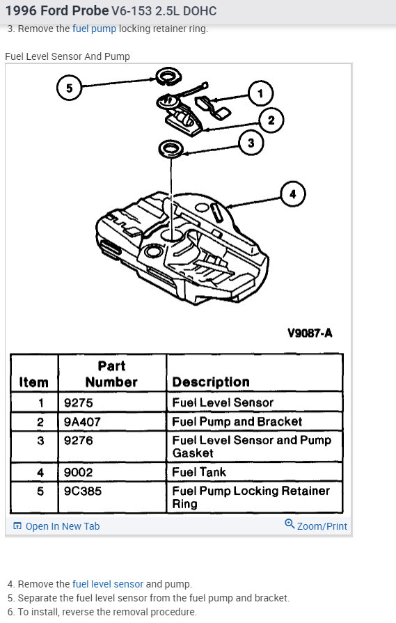

If the relay is good, check for power at the fuel pump connector.
If there is power, then the issue is likely a bad pump.

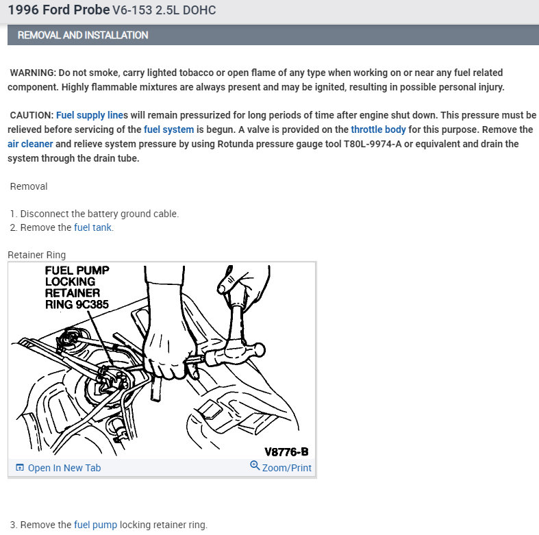

https://www.2carpros.com/articles/how-to-replace-an-electric-fuel-pump
I have attached diagrams below for your reference.
Let me know what you find or if you have any questions.

Okay, thanks for the info. I will give these a try. Sure, hope it's not the pump. I don't mind getting under the car, but I get nervous w power tools, wires, and banging around when there could be fuel or vapors all over the place.

I looked at the fuel pump relay. It didn't have any diagram. Has 4 pins. Using multimeter I get continuity across 1 pair, but none across the other pair. So, I assume the ones w continuity are the ones from the battery? I hook up 12v worth of battery to the pair w continuity and it clicks when connected. Sounds good. With some difficulty I measure continuity across the other pair after connecting the batteries and then after the relay clicks. However, there is no change in continuity across the non-battery pair. I'm guessing that the relay switch is flipping since it is clicking, but for some reason it is still not completing the connection and thus needs to be replaced. What do you think? Thanks immensely for your help.

Do you have any other relay that you can swap this with? That way you will know for sure if it is the relay. Clicking relay means it is getting power, however not necessarily if it is actually putting out the power to the component.
