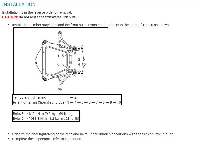

Let us know what you find. Another thought I have is the subframe (engine cradle) mounting bolts. These are often overlooked. There are 4 main bolts that hold the subframe to the car plus some smaller ones. See the attached installation guide for your car with the torques specs.

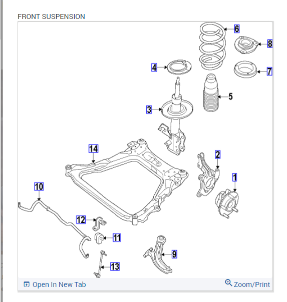

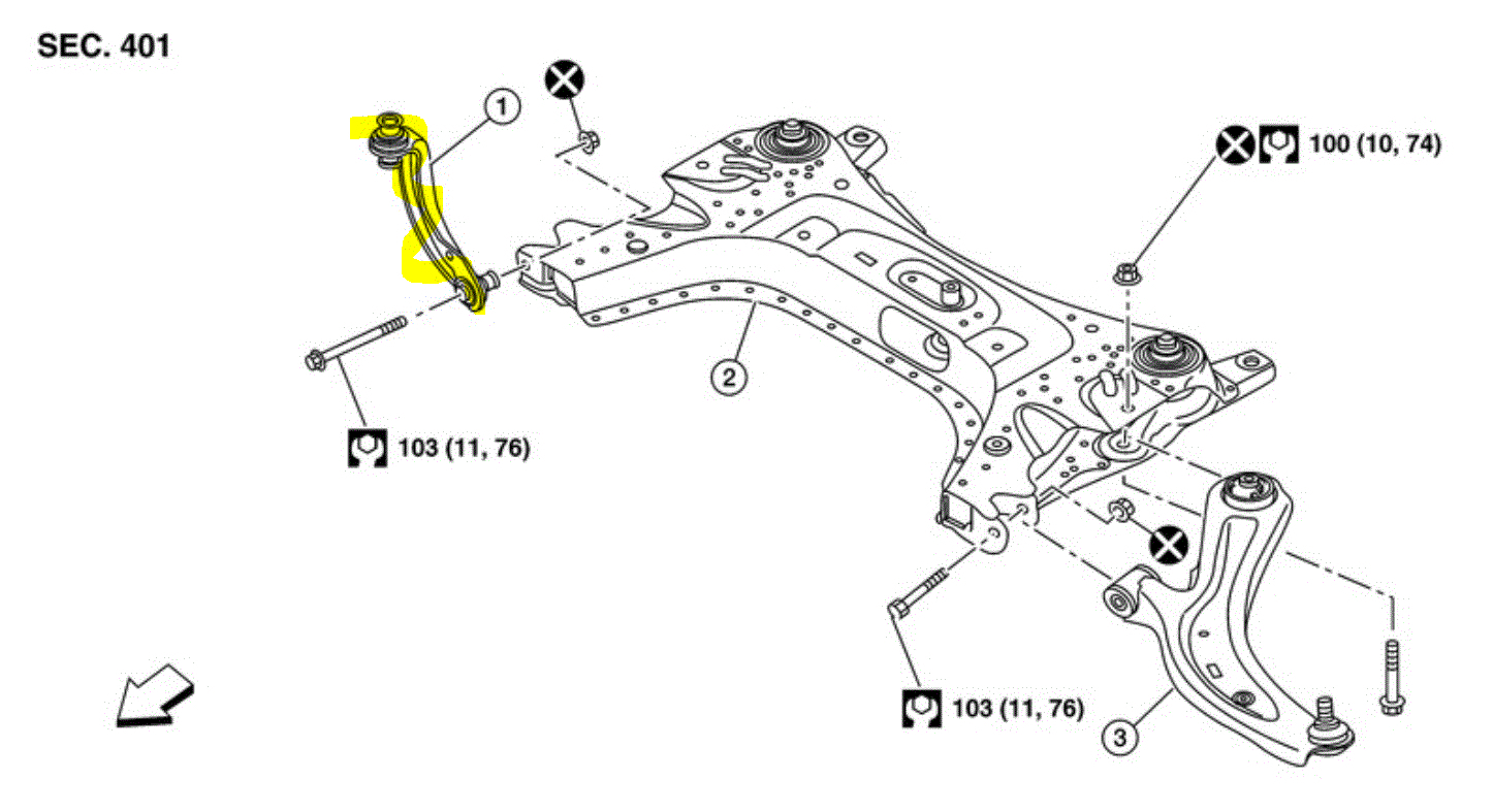

I think I’ve narrowed it down to the subframe mount that goes to the control arm (Nissan refers to it as the “right upper suspension link”). I have one on the way.
Today on my ride home I started hearing a rattle/chatter sound coming from the driver side this time. Not sure if its a coincidence or caused by whatever is going on with the passenger side. It only happens at low speeds mainly when on bumpy roads.

I noticed we haven't been in contact with you for a couple of days. Has any progress been made? Also, I attached a pic below. Is the highlighted part the one you are replacing?
Let us know.
See pic below.
Sunday, August 1st, 2021 AT 10:14 PM
BLAKE P
  • 10 POSTS
Yes, that is the correct. It did smooth out the ride, however it did not fix my clunking issue. It definitely helped out but I still get noise on some bumps/potholes. When you say the subframe bolts, are you saying the bolts are defective or that they could be loose?

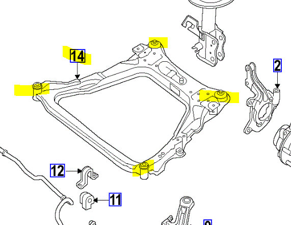

When you replaced the struts, was it a complete assembly? Is the noise loud enough for you to record and upload for me to hear?
As far as the subframe, he was referring to the cross member under the engine. See the attached pic. I highlighted where there are bushings that could be bad or loose.
You did check things related to the sway bar, correct? There are bushings on them as well as stabilizer links.

I checked the bushings for play with a pry bar and nothing looked loose.

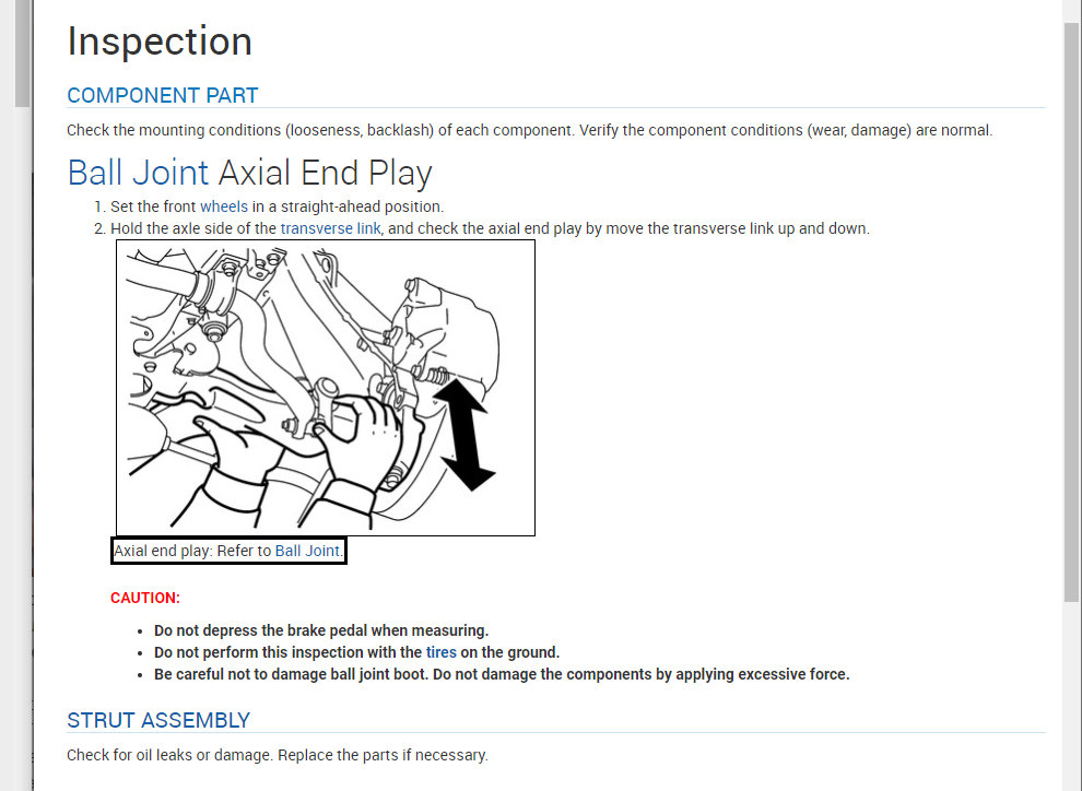

Usually the tie rods cause a feeling of wander or looseness in the steering wheel, but they could make a noise also. With the car jacked up, drip the wheel at 3 and 9 o'clock and shake lightly side to side to feel for clunking or looseness.

I suspect the lower ball joint may be the issue. An eye test will tell you nothing.
You need to jack up the car and use a pry bar under the tire and see if there is up and down movement or side to side.
Check that for us and let us know.
