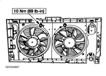

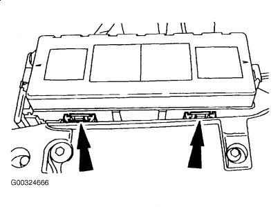

RFRANCE
  • 2002 FORD TAURUS
Engine Cooling problem
2002 Ford Taurus 6 cyl Front Wheel Drive Automatic
How can I replace the coolinf fan on the right side of the engine
Tuesday, August 25th, 2020 AT 10:59 AM (Merged)
BMRFIXIT
  • 19,053 POSTS
Remove the distribution box and position aside. See Fig. 1 . Disconnect the fan electrical connector and detach the retainer. Remove the bolt and the electrical cooling fan. See Fig. 2 . To install, reverse the removal procedure. Tighten bolt to specification
https://www.2carpros.com/forum/automotive_pictures/99387_Graphic1_654.jpg
https://www.2carpros.com/forum/automotive_pictures/99387_Graphic2_308.jpg
