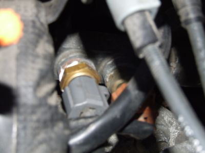

MERLIN2021
  • CAR REPAIR CONTRIBUTOR
  • 17,250 POSTS
Check the fuse for the fan, then if it's ok replace the ECT elctronic coolant temp sensor, runs about 20.00 do it when engine is cold...if you do it fast enough, you won't loose but a few drops of coolant! It's located just above the tranny on the right side of the motor, as seen from the front of the car...there are 2 sensors replace the one on the left.
https://images.2carpros.com/forum/automotive_pictures/62217_ECT_1.jpg

BRIANBIGB1265
thanks for the quick reply, i know it is fuse #10 from manual however the top of the box is missing not sure which fuse it is or if missing all fuses are good but there are empty spaces
Aug 25, 2020 at 10:35 AM (Merged)
MERLIN2021
  • 17,250 POSTS
Change the sensor...

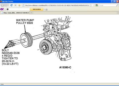

HATESFORDTAURAS420
Engine Cooling problem 1997 Ford Taurus 6 cyl Front Wheel Drive Automatic 200k miles ok so my roomates car is a 97 ford taures gl and has a coolant leak right behind one of the pullies that holds the serpentine belt. it is coming out of a hole that looks pre drilled. when I put coolant in the resivour in about 3 seconds I will see the coolant start to leave through this hole. I would like to know if it is fixable and if so how. if any further info. is needed ask I will provide to the best of my knowledge.
https://images.2carpros.com/forum/automotive_pictures/566025_stupid_tauras_1.jpg
Aug 25, 2020 at 10:36 AM (Merged)
SATURNTECH9
  • 30,869 POSTS
https://images.2carpros.com/forum/automotive_pictures/416332_1997_ford_tarus_water_pump_1.jpg
Is it coming from behind the water pulley you see in the diagram?
