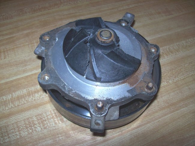

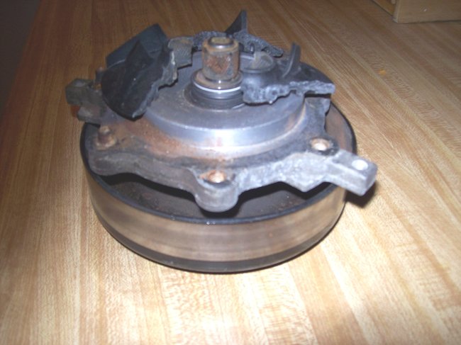

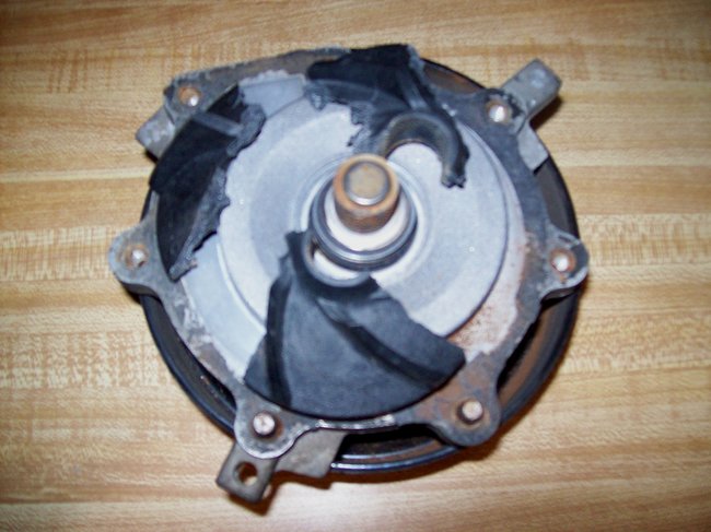

originally I did not have any heat, we thought the heater core was bad because one hose was hot and one hose was not. That did not help so wwe then found the water fins were gone, replaced water pump. The car still overheated, we then replaced thermostat, still overheated, we then removed thermostat, still overheated. Replaced the radiator and all hoses, still overheated, purchased a kit that tests for exhaust in cooling system and passed. Replaced expansion tank and cap also, and both coolant temp sensors. The car will overheat sitting in garage after about 20 minutes. Any help would greatly be appreciated.
