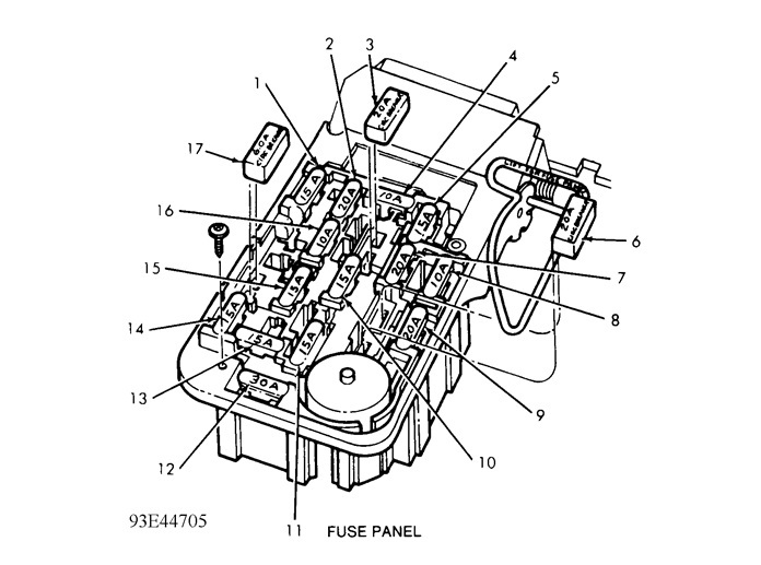

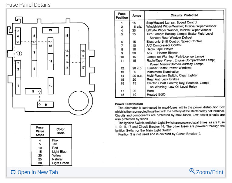

I do not have a manual for this truck that I bought used. Can someone pls scan one or give me a link to the diagram for the fuse panel for this truck? I am needing to check the fan for the heater/defrost. Thanks so much for your promptness and help.
+1
Wednesday, February 3rd, 2021 AT 1:37 PM (Merged)
IMPALASS
  • 3,112 POSTS
Here is the fuse panel (below) for your truck with a guide to help you check for power.

GCMOM7
Seems like these should do it. Thanks, again. :-)

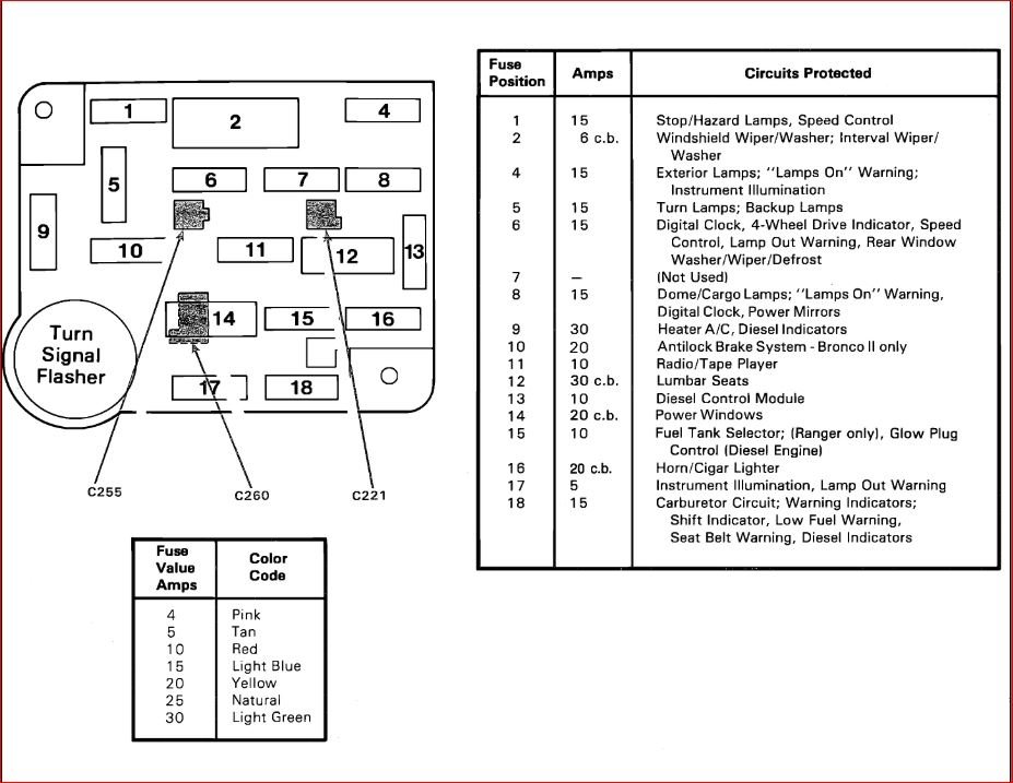

I've repeatedly attempted to do a Google search for my fuse diagram on my truck and it simply does not pull up the one that I need. It pulls up every other year but mine. I've even looked on manuallib. Com and it just gives the size fuse needed for each component but not the diagram. Why wont it just show me a picture with a legend? I am going crazy trying to find this on line. I don't have owners manual. Please help me! Am I doing something wrong? 1988 Ford Ranger 2.3 leader throttle body 2wd.
+1
Hi BKM,
Looks like you only have one panel on the driverside under the dash?
Here is the diagram for it. Let me know if this doesn't look right but it appears it is.
BKM97423
  • 51 POSTS
Thank you so much Kenny. This is the correct diagram. Having this fuse box diagram for my Ranger has been extremely helpful. You guys are awesome! I appreciate you at 2carpros. Com. Sincerely, Brenda M. Southern Oregon Coast

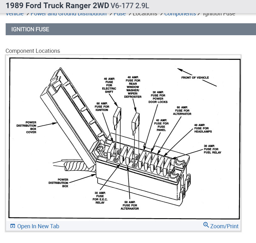

Where can I find a diagram for the fuse box for a 1989 Ford Ranger? I do not have an owner's manual.
Wednesday, February 3rd, 2021 AT 1:38 PM (Merged)
  • 75,992 POSTS
Here you go have a nice day
https://www.2carpros.com/forum/automotive_pictures/12900_fuse_16.jpg
https://www.2carpros.com/forum/automotive_pictures/12900_fuse1_4.jpg
https://www.2carpros.com/forum/automotive_pictures/12900_fuse2_4.jpg
https://www.2carpros.com/forum/automotive_pictures/12900_fuse3_2.jpg
+2

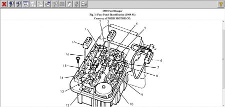

Brake light not working, changed bulb, still did not work. Changed fuses in fuse box because the blinkers quit working also. Need diagram to see if I put the right fuses in the correct location.
+1
JDL
  • 16,098 POSTS
Fuse 1--15 amp is for stop lamps.
