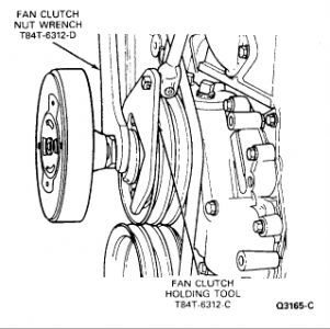

First time replacing this, what is the proper way to remove fan an fan shaft assembly? The fan has a spring in front and I'm not sure how to remove the fan shaft. The new one is threaded where that goes on.

Removal
Remove the fan shroud or finger guard.
http://www.2carpros.com/forum/automotive_pictures/248015_1_32.jpg
CAUTION : This nut has a left-hand thread and must be rotated clockwise for removal.
Remove the large nut which attaches the viscous clutch to the hub of the water pump shaft using Fan Clutch Holding Tool T84T-63 12-C and Fan Clutch Nut Wrench T84T-63 1 2-D.
Remove the fan and clutch as an assembly.
Remove the bolts attaching the fan to the clutch, if necessary.
Installation
http://www.2carpros.com/forum/automotive_pictures/248015_2_22.gif
For installation, follow removal steps in reverse order.
Tighten the fan-to-clutch bolts to 6-8 N.m (53-70 in-lb)
CAUTION : This nut has left-hand thread and must be rotated counterclockwise for tightening.
Tighten the fan clutch assembly nut to 40-135 N.m (30-100 ft-lb) .
