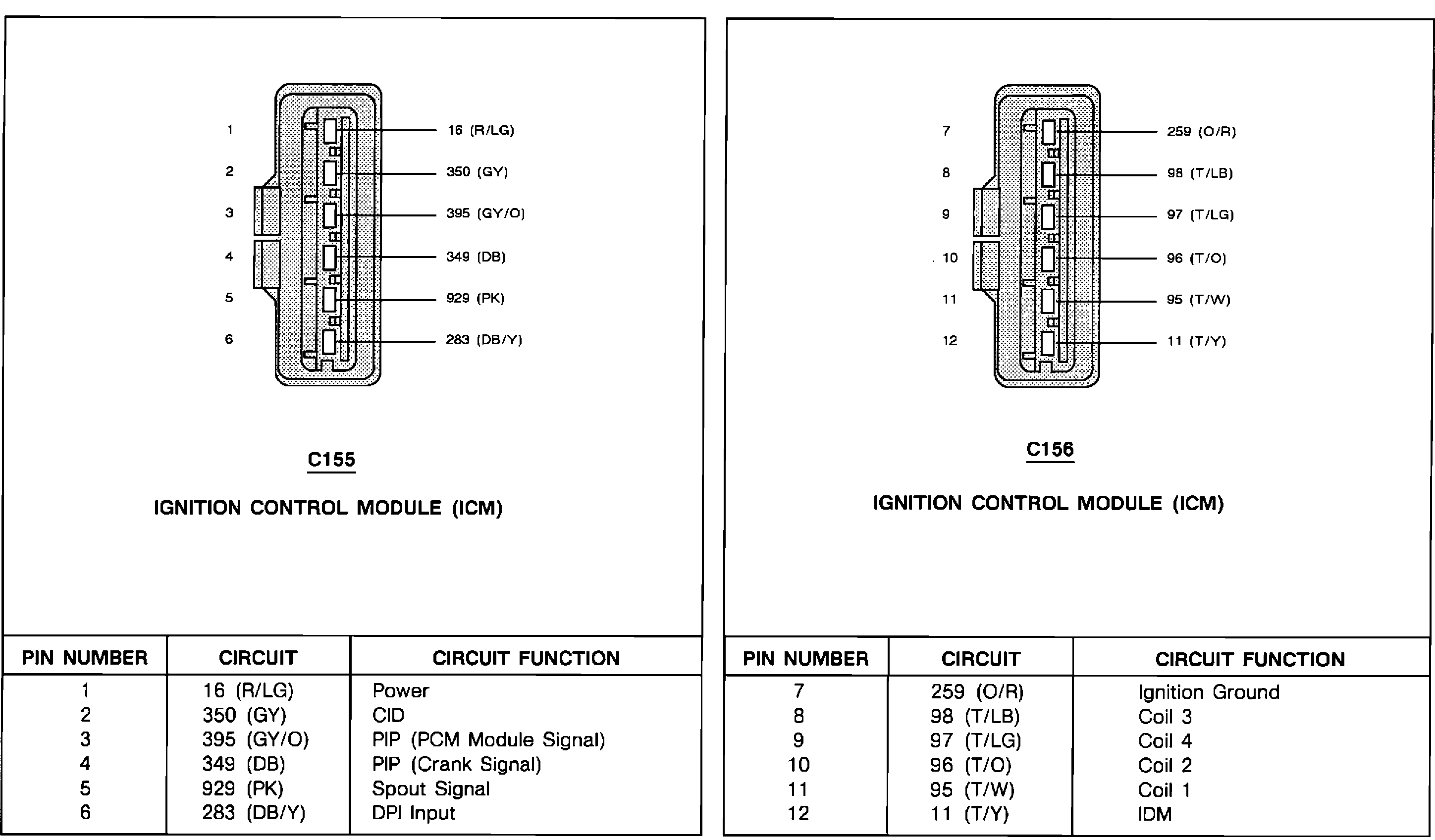

Mr. Steve awesomeness thank you. I will change out ICM and let you know how it goes. Lee!
Wednesday, July 29th, 2020 AT 11:45 AM (Merged)
WILLIAM PENDLEY
  • 15 POSTS
Mr. Steve, would a bad relay in the fuse box under the hood cause this kind of issue? I don't know that's why I come to you.
STEVE W.
  • 15,676 POSTS

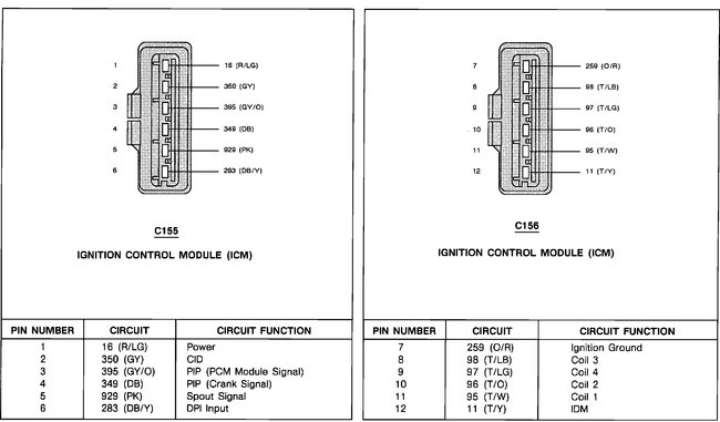

Nope, The ICM controls it all when it comes to the spark plugs. It determines which plug and when to fire. A bad relay would knock out the entire module so you have no spark at all. Same if it was a bad crankshaft or camshaft sensor, they would shut off all spark.
The wiring diagram is the modules connections. Notice the pins saying coils 1-4? Those are what tells which coil to fire. Check them over to be sure there is no corrosion or bad connection for the one labeled coil 1 (pin 11) That would be the only spot other than a bad coil, plug wires or plugs that would stop spark on cylinder 1.

Mr Steve. Sorry it took so long to get back with you. I put another ICM in and seems to be working okay. Also put new relays in. Now I have a hard time starting it. It cranks awesome just so very hard to get it started. First ignition key turn motor jumps like it going to start then doesn't. I have to turn key off wait a few sec then turn the key again. I do this about 15 to 20 times be for it starts. When it does start the fumes from exhaust burns my eyes. Any ideas?

The inertia switch would shut the fuel pump off and the engine wouldn't run at all so I doubt it is the issue. I would recheck the firing order and wires. It sounds like there is an issue with the timing or firing order. That would push fuel fumes out as well and in a cold engine they would cause some nasty fumes.

I went a head and did all of them this morning. It was 38 here cold. I turned the key and it started right up and no fumes. Purrs like a kitten. You are awesomeness. Thank you so much. If ever I have any problems again you are the one I want to talk to. You truly know your stuff. Thanks again my brother. Lee !

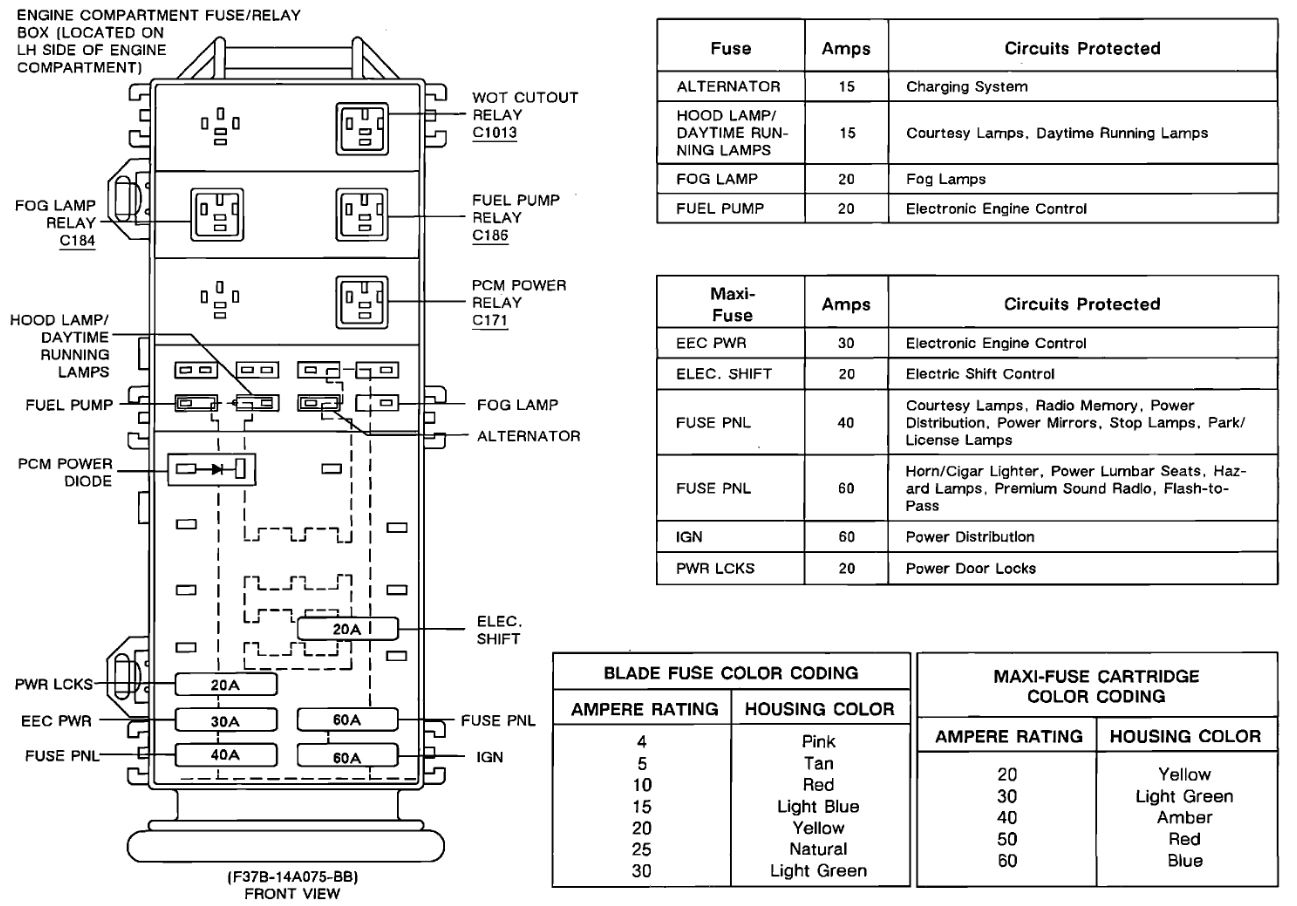

Could be a relay that is starting to fail. The way the circuit works is simple, When you turn the key on, the PCM then turns on the pump relay for about 2 seconds, this is to bring the fuel pressure up in the event that any has leaked down while it sat. Then the relay turns off. When you turn the key to start it turns it on again and once the PCM sees an RPM signal of more that 120 rpm it turns the relay on full time and the engine runs. If the PCM sees that RPM signal drop below 120 or stop it shuts the pump relay off. If the relay contacts get bad they can stick. Another reason they can fail is if the fuel pump itself is starting to go bad and it's drawing excessive current. When that happens the contacts can spot-weld themselves together. That isn't hard to test but it takes an ammeter that can read up to 20 amps. Then you put it between the power feed and the pumps power lead. If you see around 5-8 amps it should be fine. Higher than that could be a bad pump. Personally I'd just replace the relay and see how it acts. If it has never been changed it's probably just worn out.

When you turn key on do you have check engine light on
if no light check fuses and relays

With key on and check engine light comes on, that will suggest that the computer is powered and its fuse and relay in working condition
