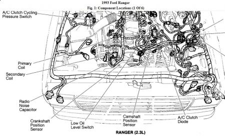

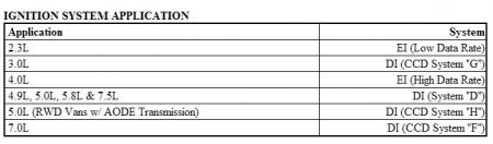

Crank Position Sensor. Used on 2.3L and 4.0L and mounted on front of engine behind vibration damper, sensor is a dual hall effect type with 50 percent duty cycle and an amplitude ranging between 0.4 and 13.0 volts. There are various systems so the correct data is important.
https://images.2carpros.com/forum/automotive_pictures/192750_IgnitionSystemApplication_1.jpg

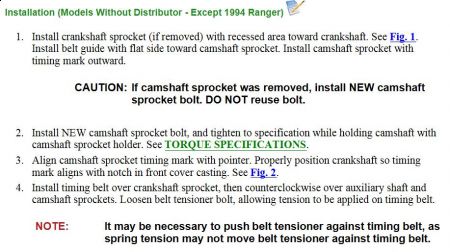

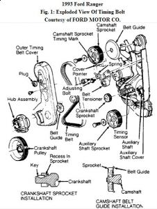

Ok got a better look at it and it appears that the timing belt has torn and is extremely worn out.Can a person take a standard timing light and check the timing?It looks like the power stearing, alternator, harmonic balancer, all have to come out?How far would the belt slip to make timing stop an engine?Or would it be catastrophic?Their are no signs of severe damage but I will check compression just to be safe.
So I ordered a timing belt, and when I get it off I will check the crankshaft position sensor to see if it is Ok or bad.
Would one set the piston for top dead centre, and check for another mark elsewhere?

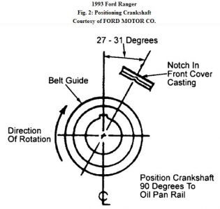

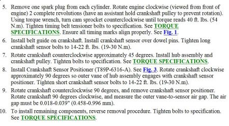

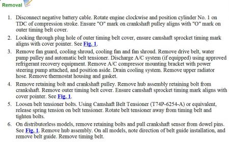

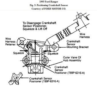

Hi again, You did not tell me the engine type and from the info, I guess it is a 2.3L as it has a timing belt. Some timing lights would not work on a DIS system. The belt did not slip. The most common fault would be missing tooth on thebelt and it usually happens at the crank sprocket. Anything more than 2 tooth out of position would cause non starting. Yes, you have to remove the external beltings and pulleys to replace the belting. Here are the removal and installation procedures. Since you have a broken belt, turn the crankshaft away from TDC before attempting to get the camshaft pulley marks into position.
https://images.2carpros.com/forum/automotive_pictures/192750_TimingBelt93FordRanger0a_1.jpg
https://images.2carpros.com/forum/automotive_pictures/192750_TimingBelt93FordRanger0b_1.jpg
https://images.2carpros.com/forum/automotive_pictures/192750_TimingBelt93FordRanger0c_1.jpg
https://images.2carpros.com/forum/automotive_pictures/192750_TimingBelt93FordRanger0d_1.jpg
https://images.2carpros.com/forum/automotive_pictures/192750_TimingBelt93FordRanger01_1.jpg
https://images.2carpros.com/forum/automotive_pictures/192750_TimingBelt93FordRanger02_1.jpg
https://images.2carpros.com/forum/automotive_pictures/192750_TimingBelt93FordRanger03_1.jpg

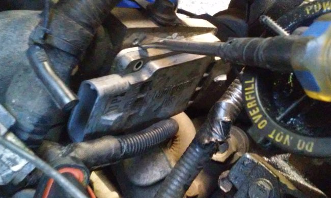

New coil packs two. new spark plugs eight. New spark plug wires eight. Still no spark on passenger side cylinder first plug closest to belts. Does camshaft sensor have anything to do with this problem? Every now.and then it would get spark and motor would run right but short lived. Please help if you may know what's going on because i am stumped. Thanks. Lee.
Jul 29, 2020 at 11:45 AM (Merged)
STEVE W.
  • CAR REPAIR CONTRIBUTOR
  • 15,154 POSTS
Welcome to 2CarPros. The cam sensor would shut down all of the plugs not just one. Your description sounds more the the ignition control module having a bad transistor driver for cylinder one. It is the only part that controls which cylinders fire at what time. I would start by removing it, cleaning the areas around the screws (they ground the module) then apply some dielectric grease and re-mount it. See if the cleaning of the grounds and reseating the connectors cleared up the problem. If not you will want to replace the module.

Mr.Steve thank you so kindly. Will let you know.the results tomorrow!! Lee..
WILLIAM PENDLEY
  • 15 POSTS
Mr.Steve goodmorning. Here is a photo! What do you think?
WILLIAM PENDLEY
  • 15 POSTS
Mr. Steve my brother. I followed your steps and i want to thank you for taking time out of your life to help me. Just to let you know. My truck listed above is running better than it ever has. Thanks again. Lee!
STEVE W.
  • 15,154 POSTS
Great to hear. The pictures looked like it had a lot of corrosion. Please return anytime with your automotive questions.

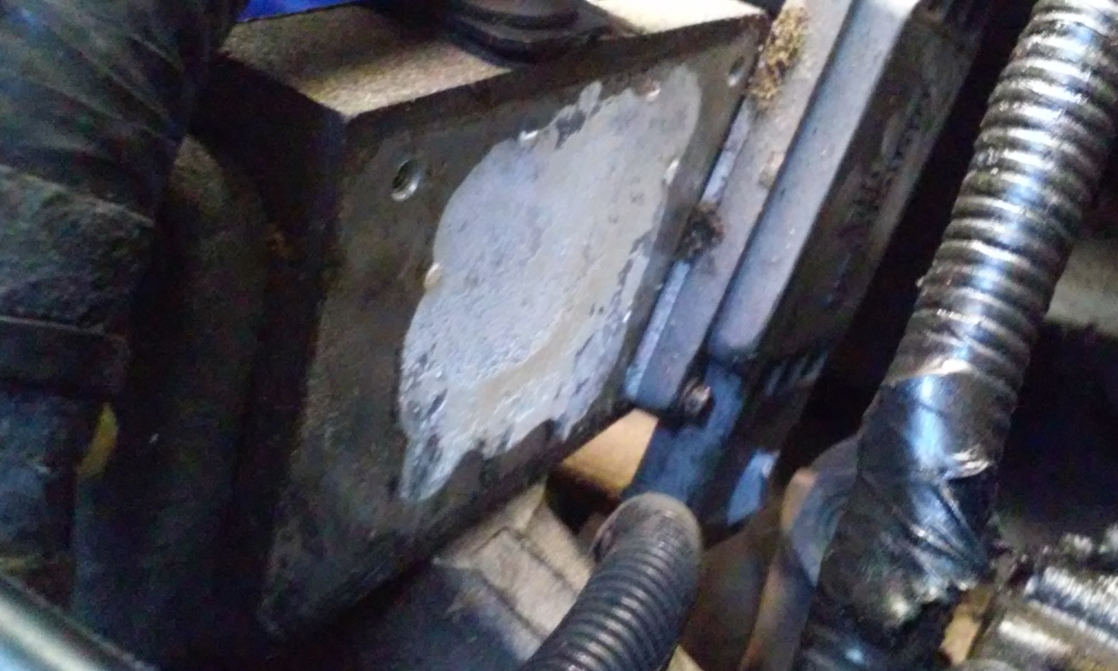

WILLIAM PENDLEY
  • 15 POSTS
Hi Mr.Steve. the truck is doing it again. This time the spark to that cylinder is staying longer then stops sparking. What do you think? Could it be the ICM going bad or something else?
WILLIAM PENDLEY
  • 15 POSTS
Mr.Steve, i didn't put any dielectric grease on it before i put it back on. would that be the cause and why?
WILLIAM PENDLEY
  • 15 POSTS
Mr.Steve my ICM has only 3 screws . There are 4 holes on the ICM but on the manifold there is only 3 screw holes.
STEVE W.
  • 15,154 POSTS
Sorry to hear that, more than likely it is failing because it didn't have a good ground for a while and it started damaging the transistors that are in the ICM. The cleaning showed it had an issue but it was a bit late to fully cure the problem. Replacing it should take care of the misfires and give you back a running truck. As for the 3 mounting screws, that isn't a problem, the two that ground it would be on the side where your screwdriver is pointing. The "missing" one isn't really needed. It's another of those "cost savings" items companies are famous for. The grease is there to allow for better heat transfer between the module and the manifold, leaving it off wouldn't be good for the long term but your module was already showing signs of failure so it wasn't the cause. When you install the replacement you can coat it with a thin layer. There will usually be some included with the new module. Check before you leave the store.

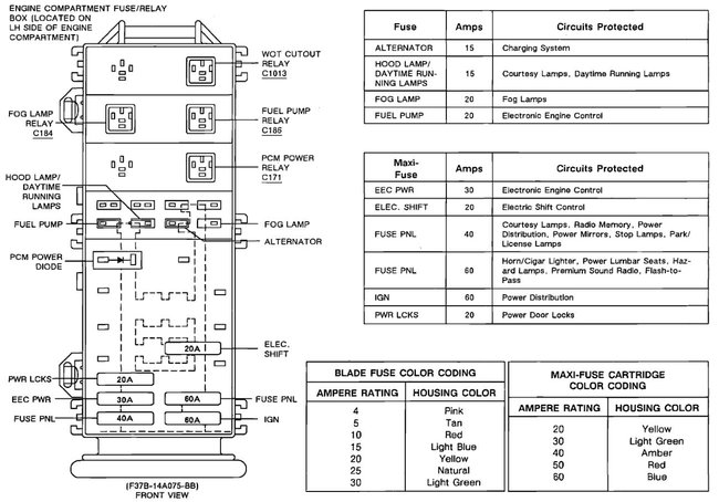

Mr.Steve, would a bad relay in the fuse box under the hood cause this kind of issue? I don't know that's why i come to you.
STEVE W.
  • 15,154 POSTS

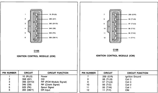

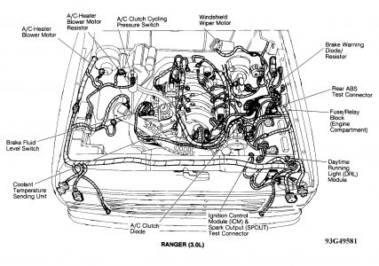

Nope, The ICM controls it all when it comes to the spark plugs. It determines which plug and when to fire. A bad relay would knock out the entire module so you have no spark at all. Same if it was a bad crankshaft or camshaft sensor, they would shut off all spark.
The wiring diagram is the modules connections. Notice the pins saying coils 1-4? Those are what tells which coil to fire. Check them over to be sure there is no corrosion or bad connection for the one labeled coil 1 (pin 11) That would be the only spot other than a bad coil, plug wires or plugs that would stop spark on cylinder 1.
Here is the theory of operation for your DIS system.
The Distributorless Ignition System (DIS) module performs the following important functions:
- provides a ground for the ignition system through two of the module mounting screws
- selects which ignition coil within the coil pack to fire
- contains solid-state electronic switches that control current to the coil primary circuits within each coil pack
- limit current flow in each coil primary circuit to a maximum of 5.5 amps
- generate the Ignition Diagnostic Monitor (IDM) signal; this provides diagnostic information about the ignition system to the Powertrain Control Module (PCM).
- provide Failure Mode Effects Management (FMEM) operation.
The second item in that list is the important one in your case. The module selects which coil to fire and when based on the signals it gets.

Could be a relay that is starting to fail. The way the circuit works is simple, When you turn the key on, the PCM then turns on the pump relay for about 2 seconds, this is to bring the fuel pressure up in the event that any has leaked down while it sat. Then the relay turns off. When you turn the key to start it turns it on again and once the PCM sees an RPM signal of more that 120 rpm it turns the relay on full time and the engine runs. If the PCM sees that RPM signal drop below 120 or stop it shuts the pump relay off. If the relay contacts get bad they can stick. Another reason they can fail is if the fuel pump itself is starting to go bad and it's drawing excessive current. When that happens the contacts can spot-weld themselves together. That isn't hard to test but it takes an ammeter that can read up to 20 amps. Then you put it between the power feed and the pumps power lead. If you see around 5-8 amps it should be fine. Higher than that could be a bad pump. Personally I'd just replace the relay and see how it acts. If it has never been changed it's probably just worn out.
