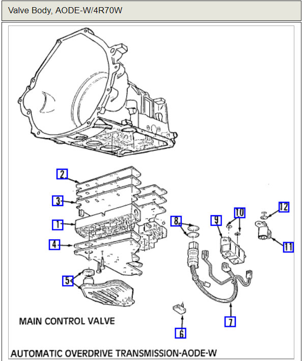

Hi my 1997 f-150 5.4v8 has had a few weird shifting problems that are starting to get worse. My check engine light is always on. I checked the codes and there's always the same two.
P0755 - Shift Solenoid B Error
P1728 - Tran Slip Error
They come back very quickly after I clear them. For a while now my truck doesnt want to shift from first to second very easily. It revs really high in first and I have to let off the gas and then it shifts into second. It does this about 50% of the time.
The second, and more serious thing, is that quite often (say maybe 3 or 4 times a week with regular driving) my overdrive "OFF" light starts flashing on my shifter. When its doing this the truck shifts very rough. It doesnt go away until I turn off the ignition and then start it again. Then its good. Sometimes for a week and sometimes for a half hour. Is this just a sensor or is something more serious like my tourque convertor? I've asked my mechanic but he doesnt give me a straight answer so I though I'd ask rather than have him spend a few hours doing exploratory work.

I would start by taking care of the P0755 - Shift Solenoid B Error which sounds like you need to replace the shift solenoid B.
Here is a guide to help you see what you are in for when dropping the pan.
Here is a guide to help you test the solenoids
Here are the locations (below)
