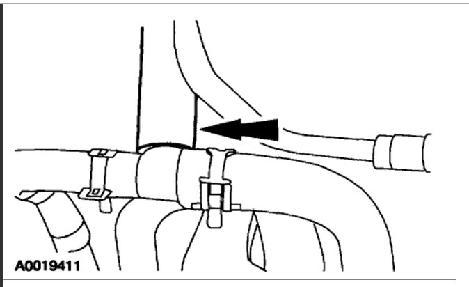

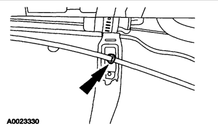

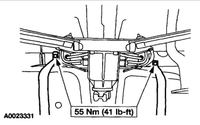

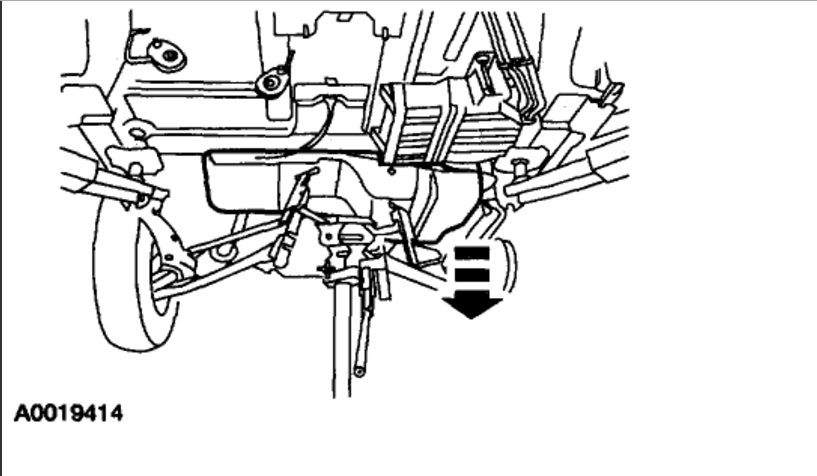

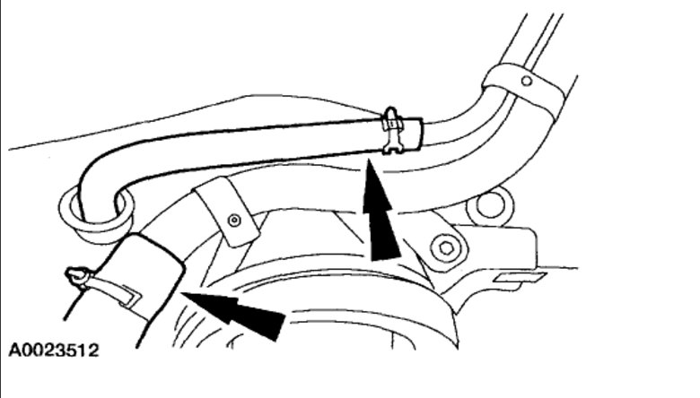

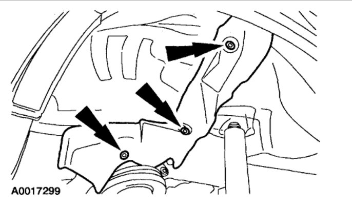

This is a common problem when the fuel pump is starting to go out.
Here is a guide and some diagrams (below) that will show you what is needed to replace the fuel pump:
https://www.2carpros.com/articles/how-to-replace-an-electric-fuel-pump

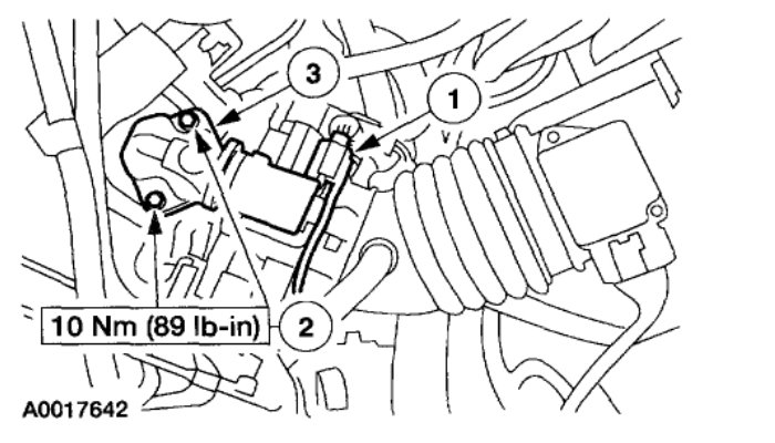

ADDIED25
I have a 2002 Ford Escape with 100082 miles on it and a V6 engine. My engine cranks but my car will not start unless I have the gas pedal down. It will not idle. If I remove my foot from the gas pedal the car turns off. I revved the engine for a moment and when it got up to about 4000 rpms it makes a strange whipping noise and the car shakes. I just put over 3000 dollars into a new transmission. I am poor college student and I really don't have the money to spend another large repair. Please tell me this is something simple or what I can start to check.
Aug 12, 2020 at 1:38 PM (Merged)
MERLIN2021
  • CAR REPAIR CONTRIBUTOR
  • 17,250 POSTS
Is the check engine light on?
  • 54,350 POSTS
I have seen this problem before its the idle air control valve making it stall at idle and it is making the noise.
Here is a guide that will help.
https://www.2carpros.com/articles/how-to-replace-an-idle-speed-control-motor-iac

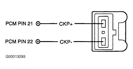

LARRYE

RACEFAN966

You have fuel but no spark? What have you checked? What have you replaced? Do you have a digital multi meter to test a few things? I am wanting to test the cam and crank shaft sensors. Get back to me with as much info as you can so I can be of better help. Thanks

LARRYE
  • 7 POSTS
This is to "racefan966".
Like I stated in my post, I have fuel and spark with 4 of the 6 coils. I replaced the 2 bad coils with 2 known good coils and all 6 spark plugs are now new. It still will not start. I tested all 6 coils with a test plug and all six coils produced what looks to be a good spark. So right now I have 6 good coils with 6 new spark plugs and fuel, but it still will not start. It does turn over, but it doesn't sound like any cyl. are trying to fire.
Yes I have a digital multimeter. Thanks

RACEFAN966
  • 5,029 POSTS
Ok so lets check the crankshaft sensor. The crankshaft sensor is on the front of the engine. What you need to do is unplug it and check the resistance should be 5 ohms or less (do this on the connector, see pic below). Now I need you to use the pic below to check for voltage at the CKP- circuit. To do this with the sensor unpluged hook up you meter to the CKP- term on the plug and turn the key on engine off and check voltage. Should be 1 to 2 volts. Let me know what you find here and we will take it from there.
https://images.2carpros.com/forum/automotive_pictures/249564_Graphic_144.jpg

LARRYE
  • 7 POSTS
I have 1.5 v at the plug but more than 5 ohms on the CKP. On the auto scale I show .356 K ohms, but on the manual scale for just ohms I get no continuity. Am I safe to assume that the CKP sensor is bad? What about the two coils that didn't show any spark? Thanks

RACEFAN966

Ok as for the ohms if it is out of spec then yes it should be bad. I am not there so I must assume that the test was done correctly. As for the coils that don't fire this sensor tells the computer when to fire the each cylinder as the crankshaft turns it see's the crank movement (there is a wheel on the crankshaft for it to read) and then the computer fires the coil at the correct time. Now if the crankshaft sensor fails this won't happen so you may get spark at the wrong time or not at all. So with the info given I would say the sensor is bad. Before replacing it I would check the ohms of the new one to the old one because once you plug it in it is non returnable. Let me know how it goes.

LARRYE
  • 7 POSTS
OK, I changed the CKP sensor and it still will not start.
What's next?
RACEFAN966
  • 5,029 POSTS
Ok check if you have spark and what cylinders do not have spark to. Now I would also like you to check the ohms of the wires to any plugs that you don't have spark to. Get back to me with ohms and length of wire. Let me know what you find. Have you checked fuel pressure to see what it is?
