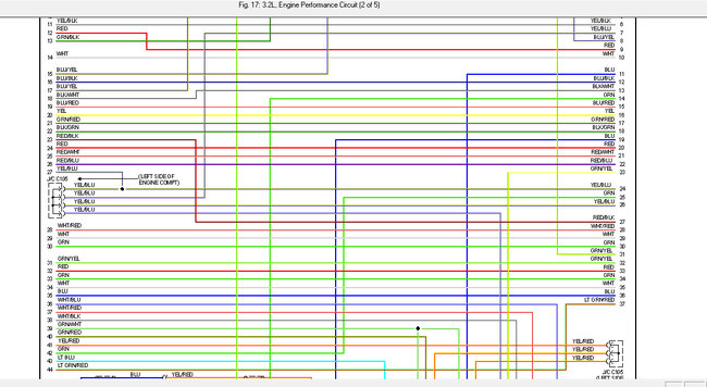

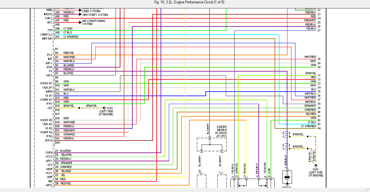

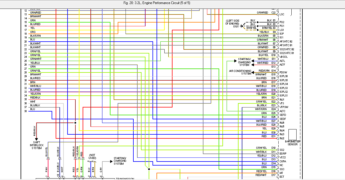

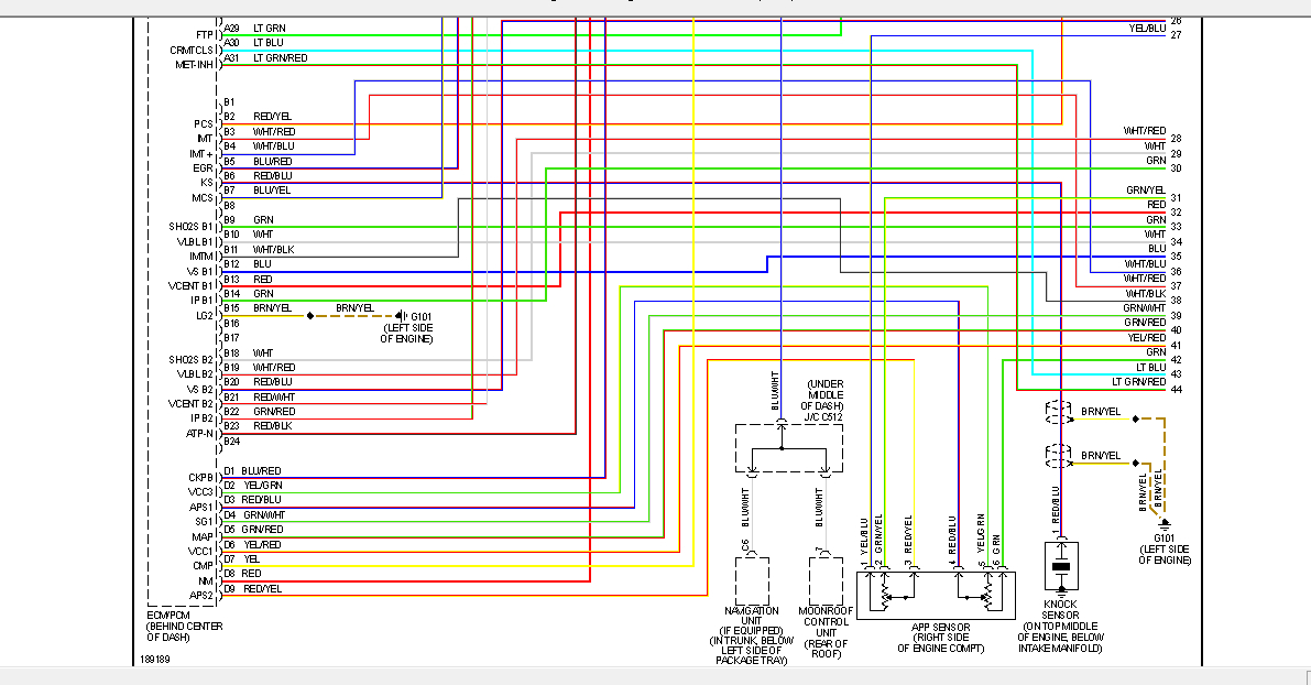

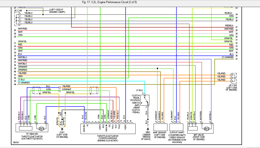

I don't hear the fuel pump prime. Tried replacing the fuel pump relay under dash fuse box but that didn't fix the problem. I replaced practically every relay (including main relays igp 1 and 2) and all fuses both under the dash and under the hood. FYI, obd2 scanner is unable to communicate with ECM. Also, the immobilizer key is flashing. I tried to start the car using the Brake Code from dealership, the immobilizer key went solid (that should be indication that immobilizer is temporarily disabled) but I still don't hear the fuel pump prime and still left with crank no start condition. Can someone suggest a solution and also provide me with the wiring diagram from engine computer (similar to the figures in this link? https://www.2carpros.com/questions/2001-acura-tl-32-wiring-harness-diagram-for-the-engine-and-transmission). Thanks

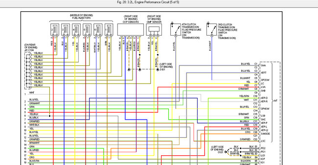

Let's try an anti-theft, security system reset first. Here is the tutorial:
https://www.2carpros.com/articles/how-to-reset-a-security-system
After reading just scroll the page to find Acura.
Here is a tutorial showing how to test wiring:

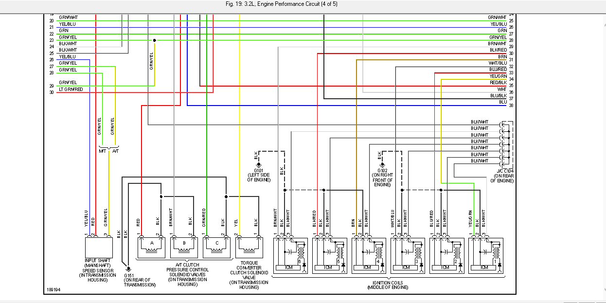

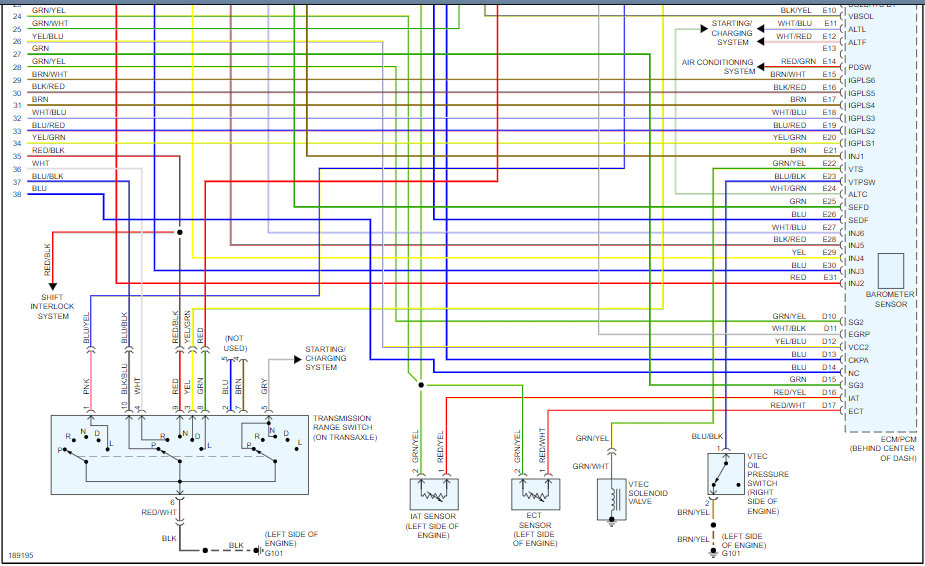

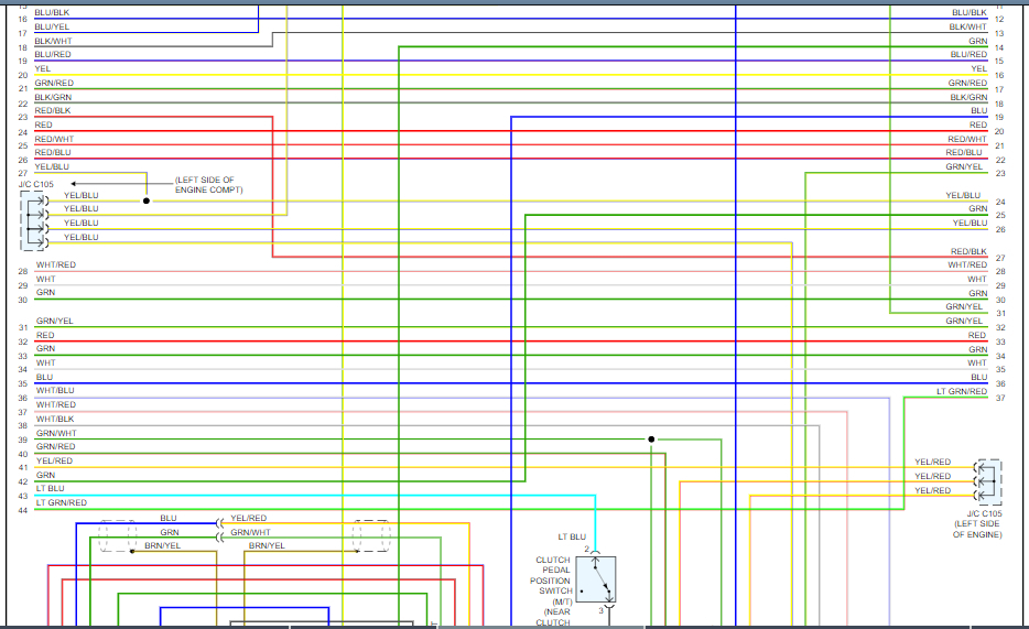

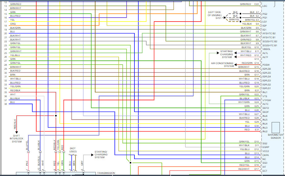

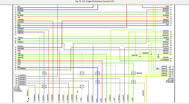

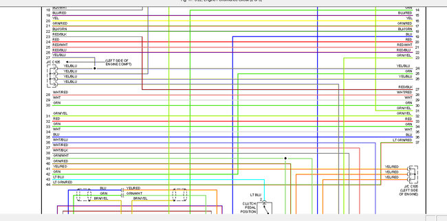

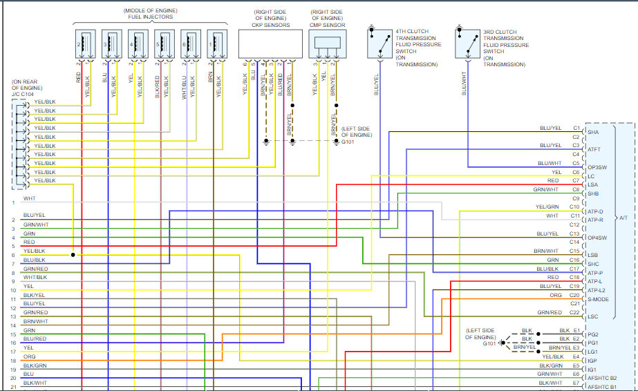

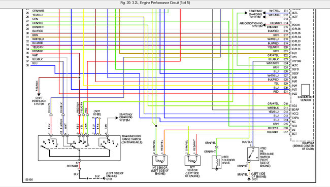

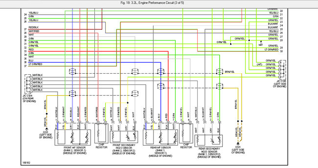

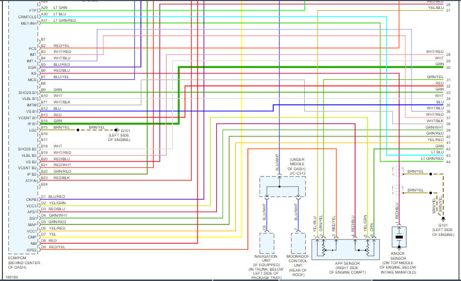

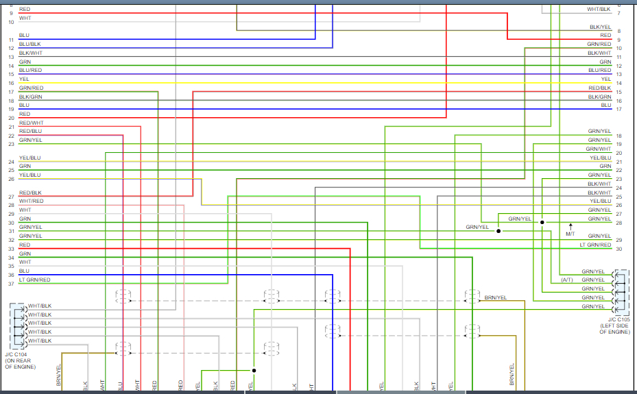

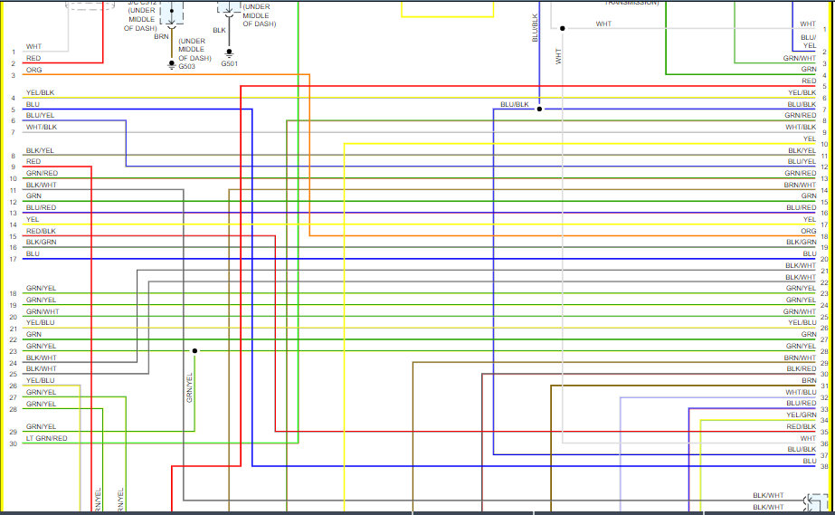

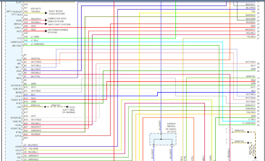

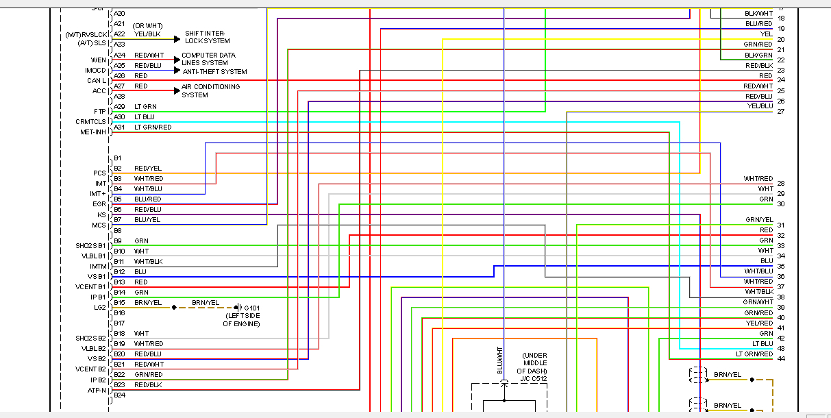

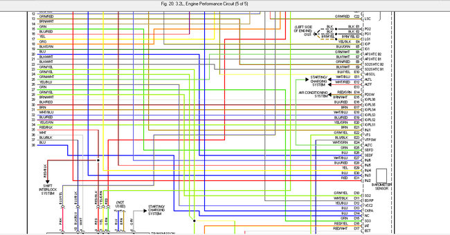

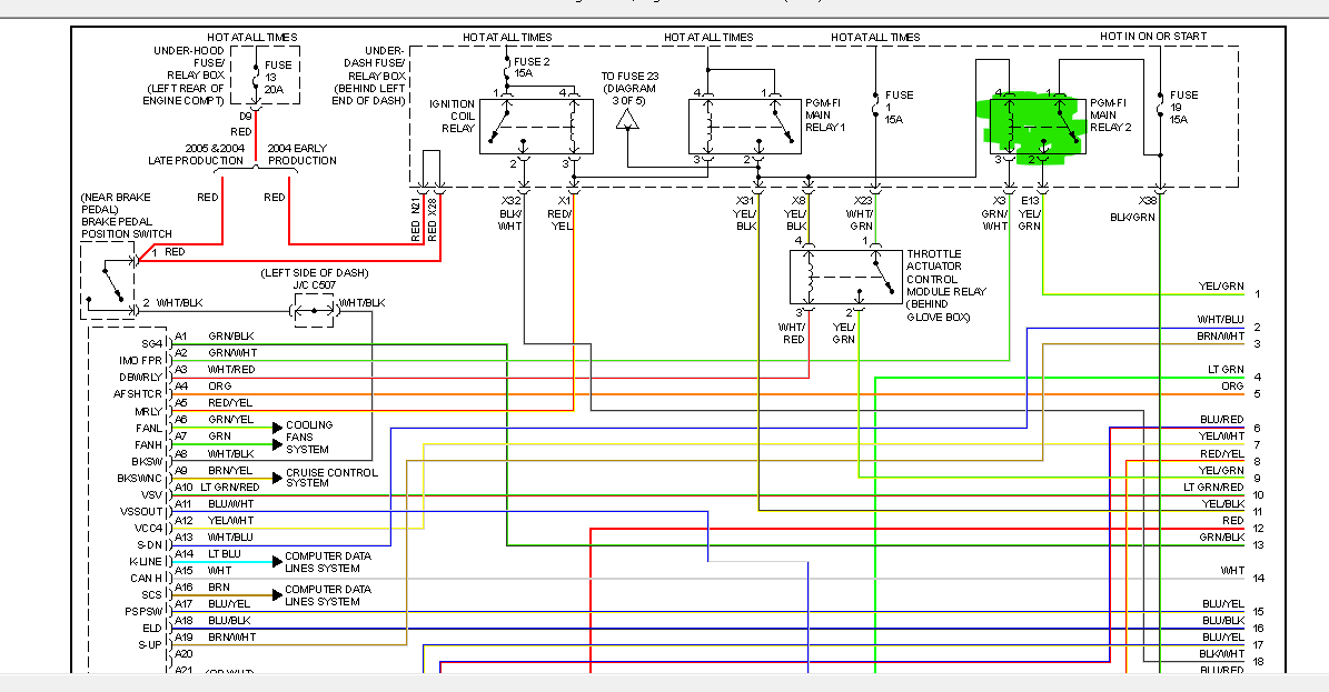

I've attached the ECM-PCM wiring diagram you requested below for your vehicle. I've cut each picture into 3 pieces so you can view larger. Let us know if the security reset works and get back to us. Hope this helps and thanks for using 2CarPros.

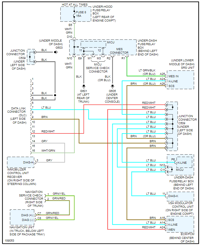

Another question that I have is, should pin 16 of the data link connector have 12 volts at all time (regardless of whether or not the immobilizer is activated)?

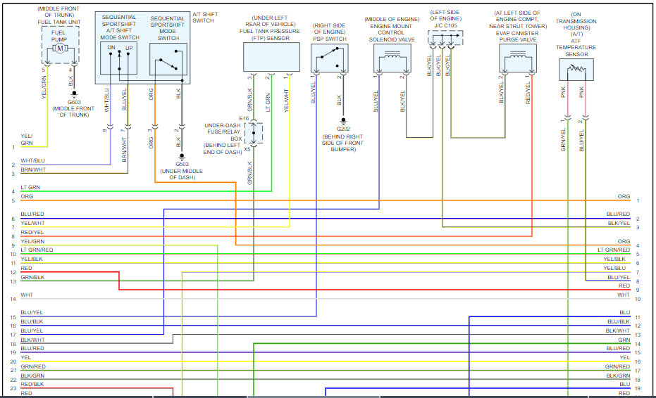

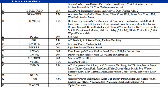

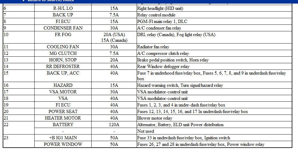

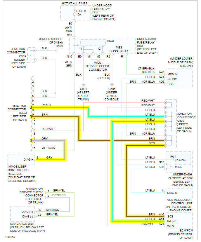

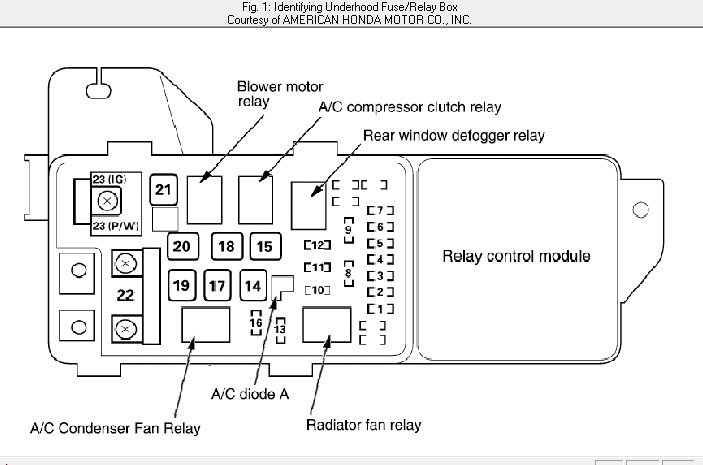

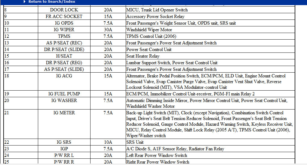

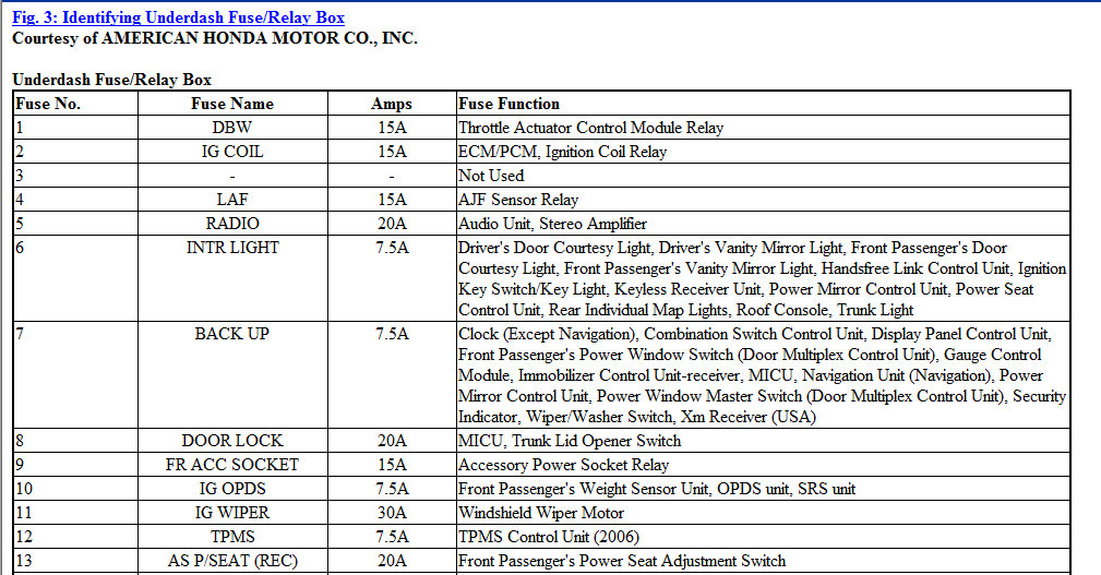

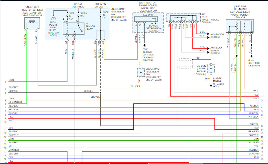

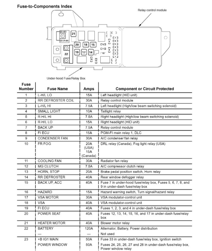

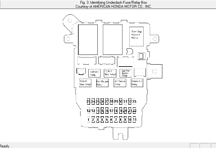

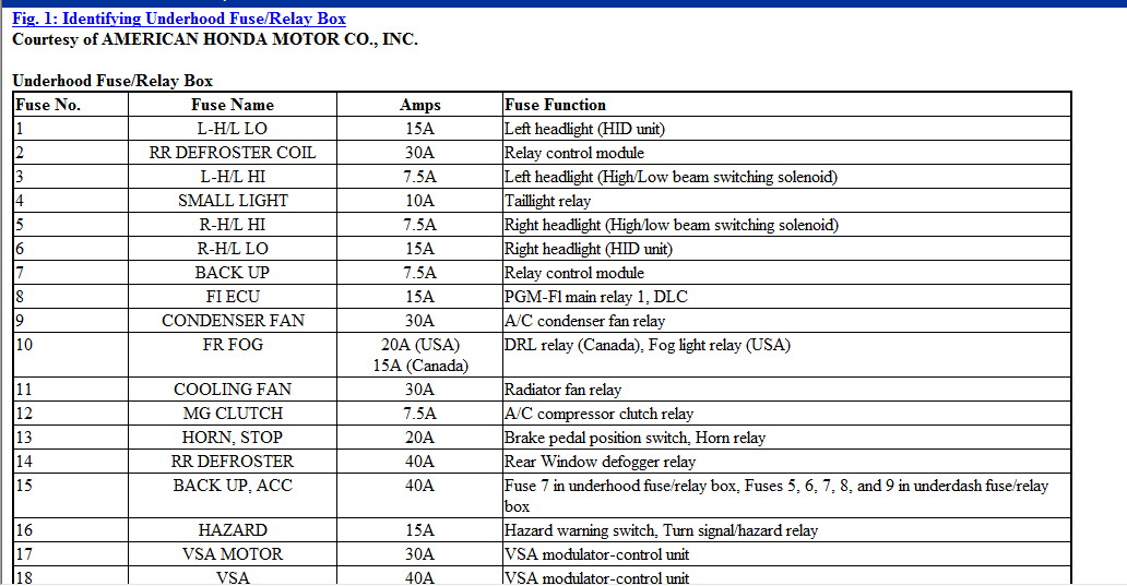

Yes, we should have power at the connector. let's check the # 8 fuse 15 amp in the under hood fuse panel. here is a guide and the fuse location in the diagrams below:

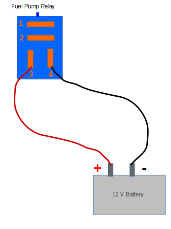

Per Acura's service instructions, the procedure for testing 4-pin relays for the 2005 Acura TL is to connect power to pin 3 and ground to pin 4 and test for continuity. There should be continuity between pin 1 and 2 when power is supplied, and no continuity when no power is supplied.
I tested a lot of the 4-pin relays on the vehicle without any issue (as soon as power and ground are supplied to pins 3 and 4, I heard the relay click and was able to check for continuity between pin 1 and 2).
However, when I tried to test the Fuel Pump relay (which is also a 4-pin relay), as soon as power and ground were connected to pins 3 and 4, instead of hearing the relay click, I got a spark/arc and the alligator clip/wire almost melted from heat within one second. I tested about 6 different fuel pump relays that I got from the junkyard (All were Mitsuba relays, which were known to fail) and they all caused a spark instead of clicked. Is it possible that all the fuel pump relays I tested were defective (very unlikely or extremely bad luck) OR is the fuel pump relay supposed to be tested differently from all other 4-pin relays? And if so, please tell me how to test the fuel pump relay. Thank you.
Wednesday, March 10th, 2021 AT 1:52 PM (Merged)
SEVAG P
  • 406 POSTS

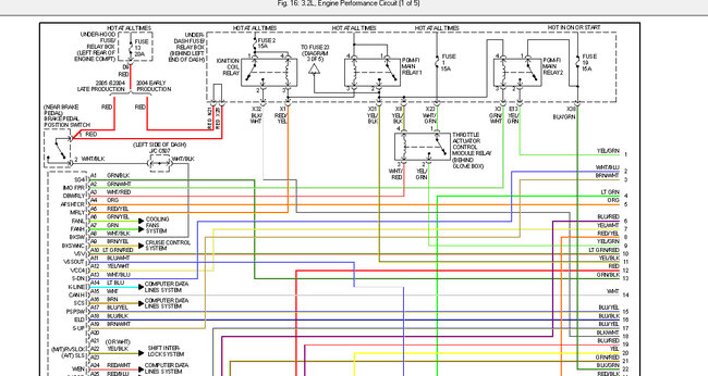

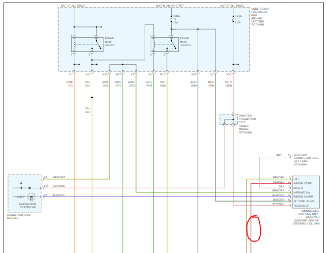

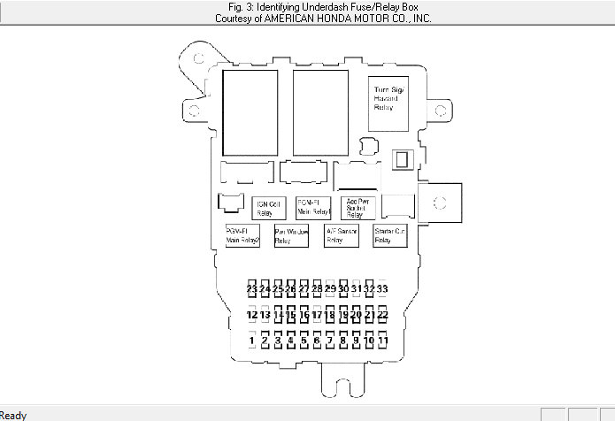

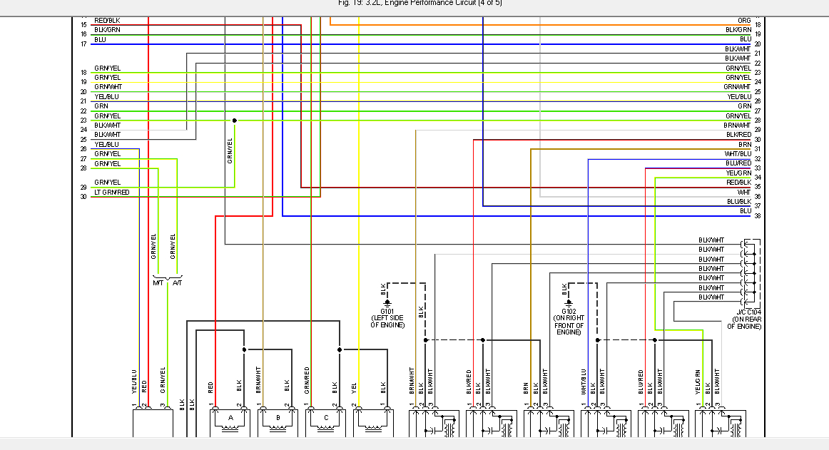

When you get spark when you supply 12v at pin 3 and 4 which means relay coil is shorted,

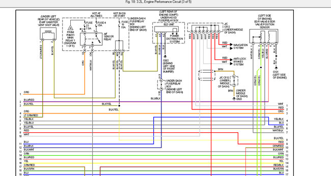

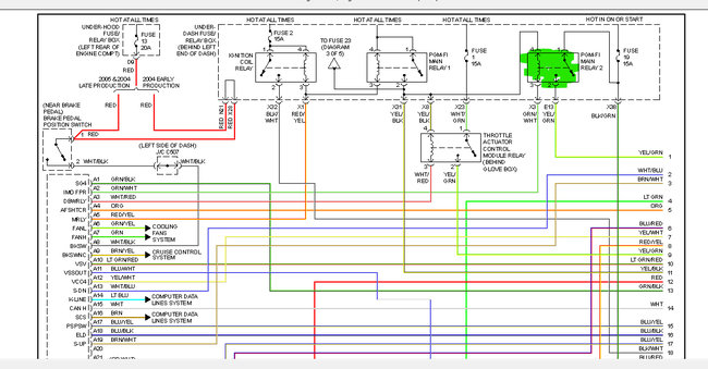

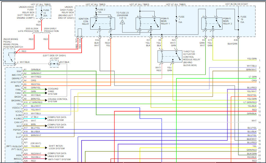

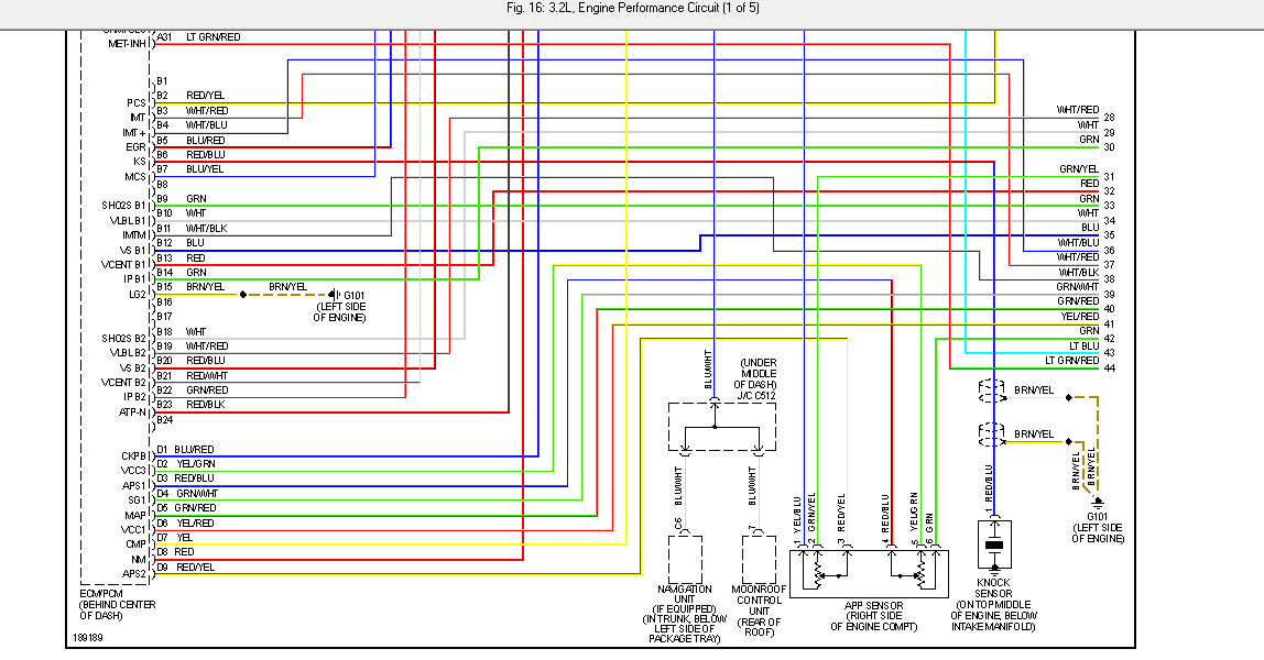

fuel pump relay is called main relay 2 in the diagram. its 4 pin normal relay, between relay 4 and 3 you must read from 40 to 120 ohms, between 1 and 2 infinity, when 12v applied at 3 and 4 pins click noise must be heard and continuity must be between pin 1 and2.
check our link below how to test a relay.
Check the diagrams below each page is cutted for 3 section for clear picture.
let us know what happens with you.
thank you.

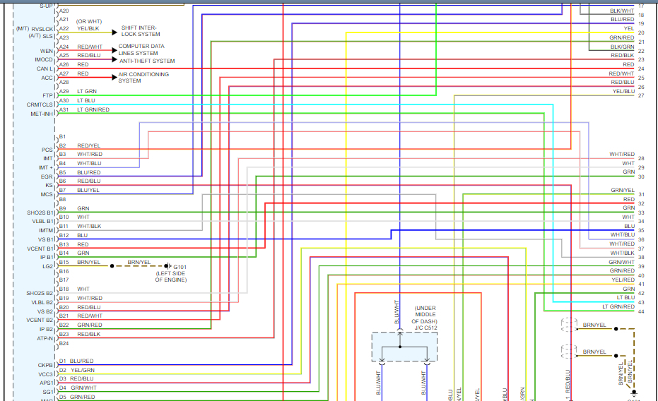

Please can you tell me in details what's the problem? engine does not start, you don't have fuel, but did you check if the spark present?.
check our link below how to check spark.

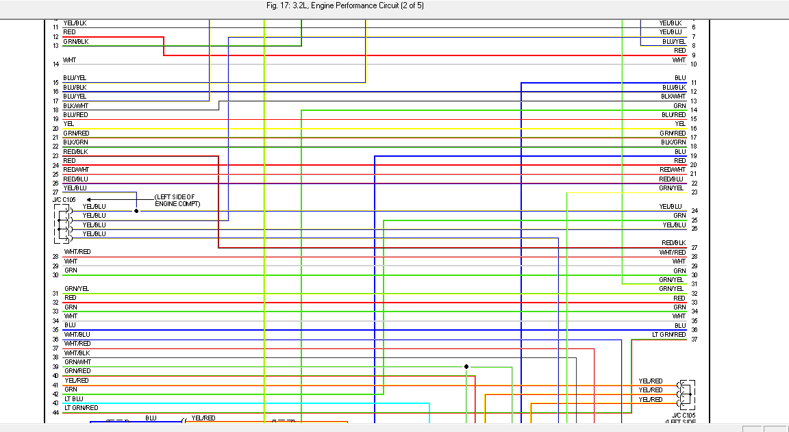

1.no main relay 2 (fuel pump relay ) just triggers the fuel pump refer to wiring diagram, fuse 19 (15A)under hood supplies positive to relay 2 pin1 and the immobilizer control unit.
check the main relay 1 which triggers the main relay 2 at pin 4.
check for positive at relay pin 1 you must get 12v from fuse 19(15A).
check pin 4 you must get 12v ignition on.
pin 2 is the positive voltage that activates the fuel pump. when the relay energized.
pin 3 is the ground that the engine control unit activates the relay2.
2.OBD port is not related to the relay2,check the fuse 8 (15A) which supply voltage to DLC, and relay 1.
3.yes for just testing purpose you can jump a wire between pin 1 and 2 fuel pump must be activated.

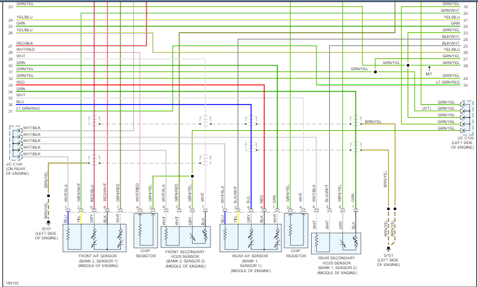

4.check the full engine wiring diagrams below which are 5 pages, each page i cutted to 3 sections for clear reading. also check the fuse box location.
please update us after the tests .
thank you.

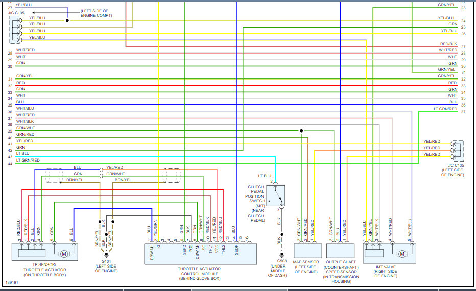

I tested the 5V reference at the MAP sensor connector and it did have 5v at the yellow/red wire and 0.02V at the green/white wire (ground). So, the ECU seem to provide the proper voltages to the MAP sensor.

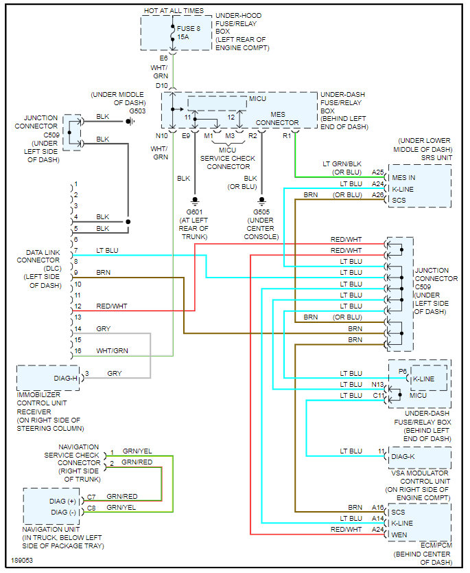

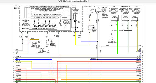

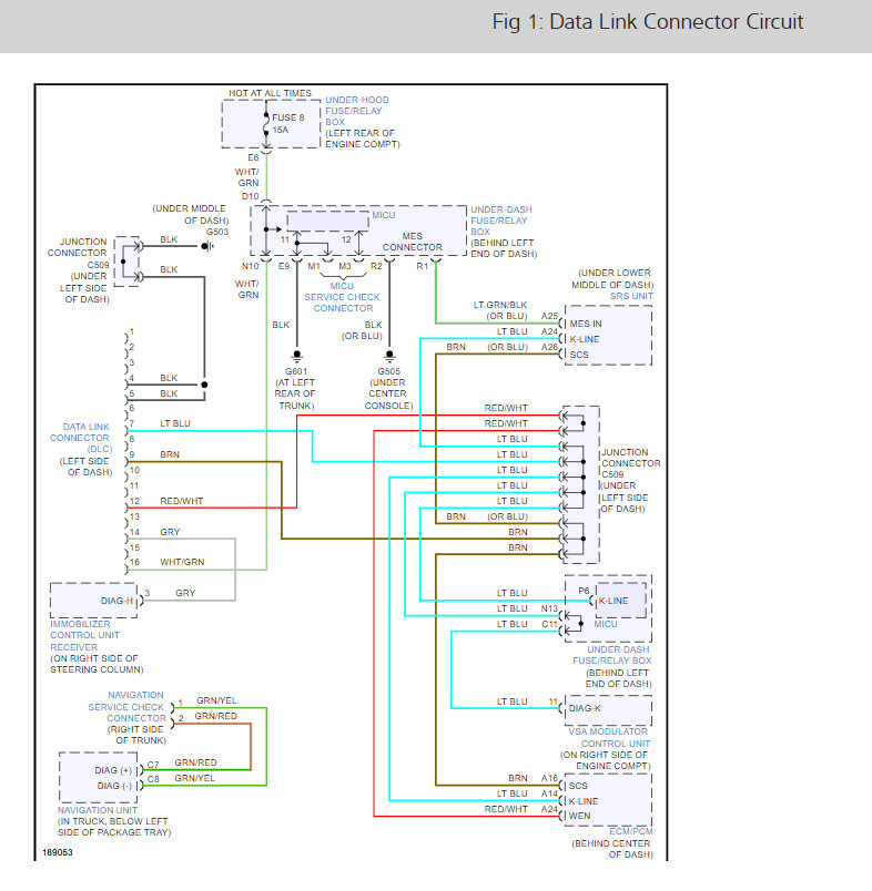

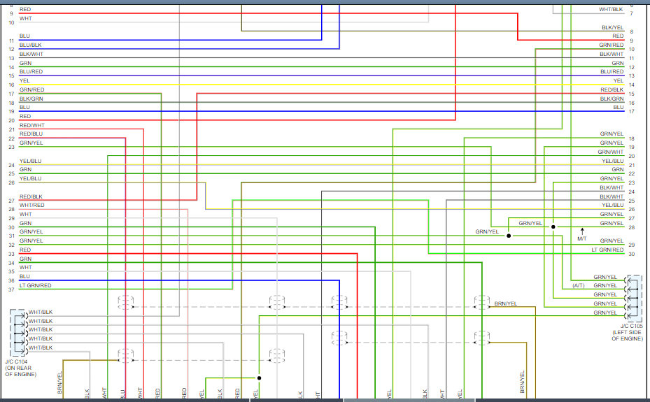

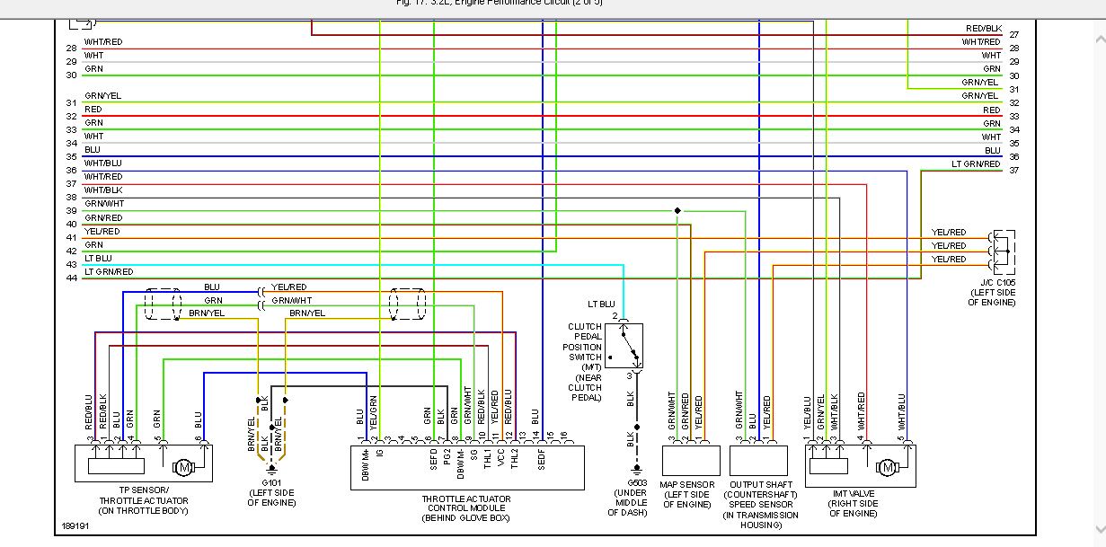

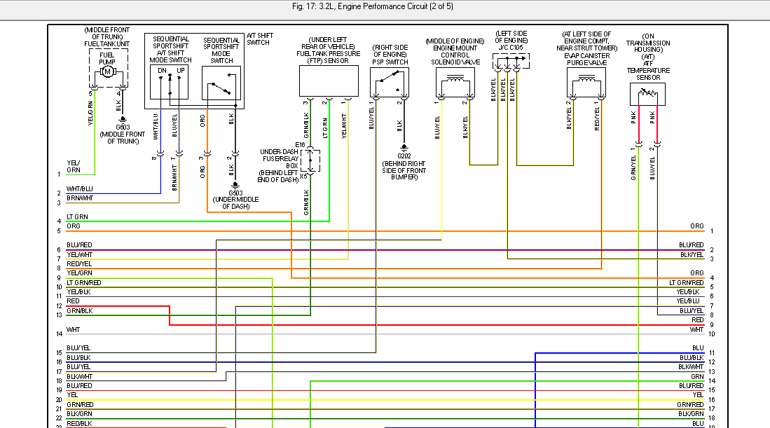

Let's take a step back here because I think you have a couple issues going on.
If you have a flashing key then you have an active theft system issue which is what we need to start with.
Are you able to scan for codes? I imagine not if you are saying you have DLC issues.
If you are not getting codes then you may have a ground issue with the DLC. I am not sure why you were checking voltage between 6 and 14. Take a look at the wiring diagram below. You don't have a wire in 6 but 14 is your diag high line.
6 and 14 are used in CAN bus systems but you don't have a CAN network so if you are not getting any voltage, this is why.
Let's start with this and go from there.
Thanks

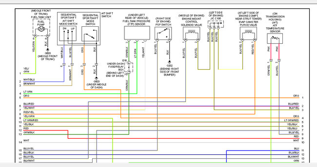

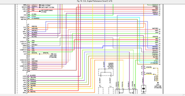

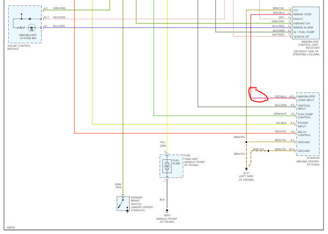

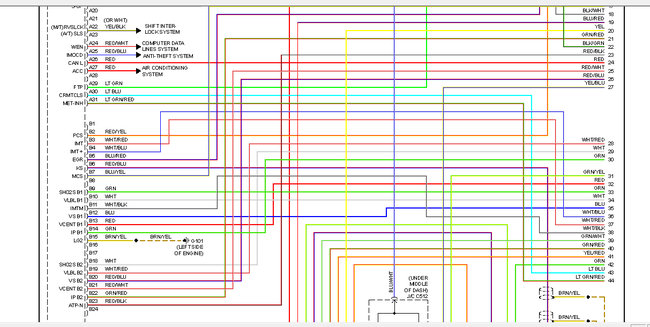

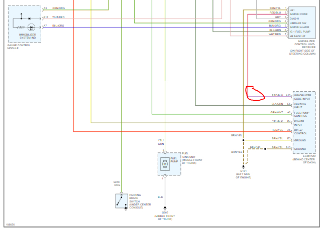

I was just curious to know since you've been doing a lot of wiring testing to see if you've checked the red-blue wire from the immobilizer control unit to the ECM/PCM? I've attached the diagram below. Let us know and get back to us. Hope this helps and thanks again for using 2CarPros.

I didn't test the red/blue wire that you mentioned. What do I test for: voltage, continuity, or resistance? And what value(s) should I be looking for? Thanks
Friday, April 30th, 2021 AT 12:12 AM
Okay. Just to be clear, you want to test the voltage using a ground so I would use both pins 4 and 5 when you are testing this voltage just to be sure the supply voltage is there and the ground is good. If you have good voltage then both are good. If you do not, then you need to test each separately.
To do this, you test the supply voltage by using a known good ground like a bolt on the engine. If you have proper voltage then the supply is good.
Then test the grounds by supplying a known good 12 volts from the battery and test each pin 4 and 5 and make sure your meter reads 12 volts. If it does then the grounds are good.

As I mentioned in a previously, I tested the 5v reference circuit at the MAP sensor, but based on the wiring diagram there seem to be 3 different 5v circuits (they may be internally connected) so I will have to test the other 2 circuits to see if they are alive. I learned that a bad sensor could cause the no communication error with the scanner. So, I will try to connect the scanner with as many sensors unplugged and see if that fixes the communication problem. But other than that, do you have any more suggestions? Thanks

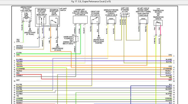

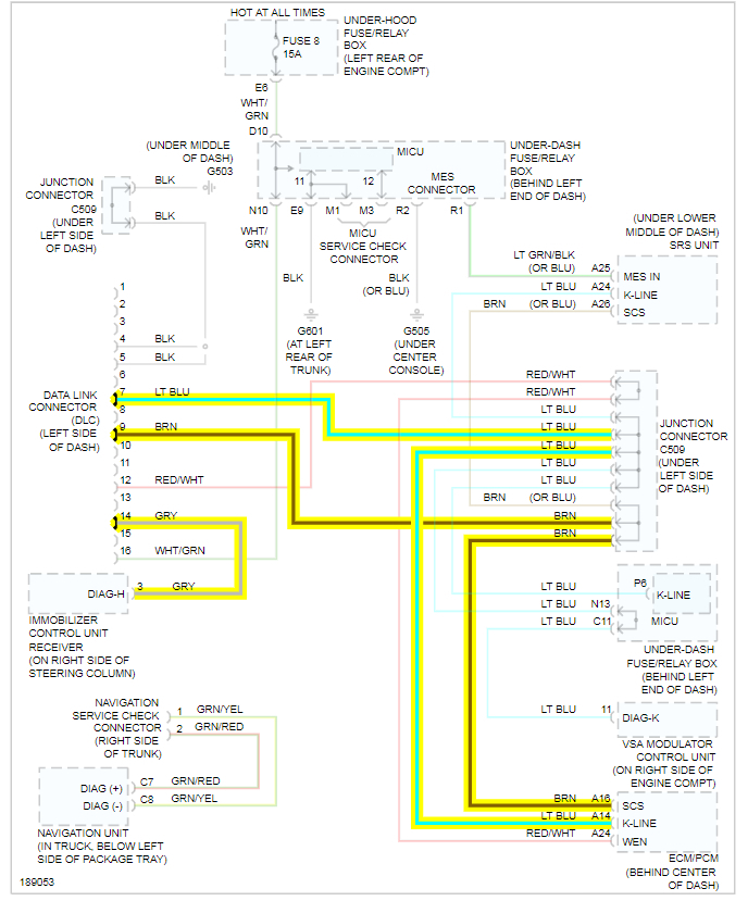

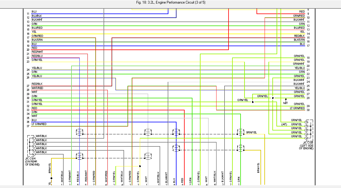

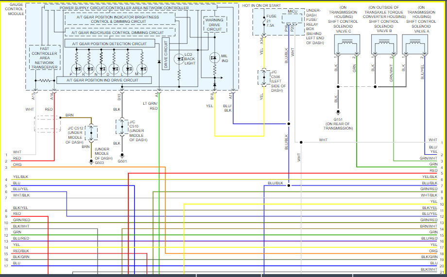

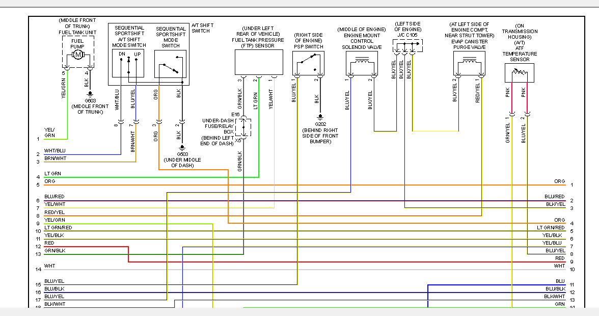

Okay. Clearly those voltages and pins look good. I suspect you have a communication issue with either the circuits highlighted below or the ECM has failed.
I understand what you are saying with the 5v signal issues however, I have not seen that cause a loss of communication issue with the scan tool.
However, just because I have not seen it doesn't mean it is not possible but it would be a new one on me.
If it were me, I would check continuity and resistance of the wires below from the DLC to the ECM just to make sure there are intact.
If they are, I suspect you have an ECM issue.
