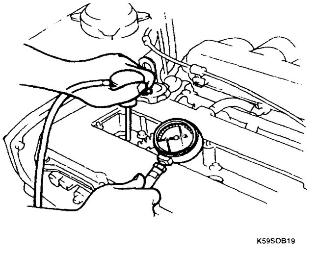

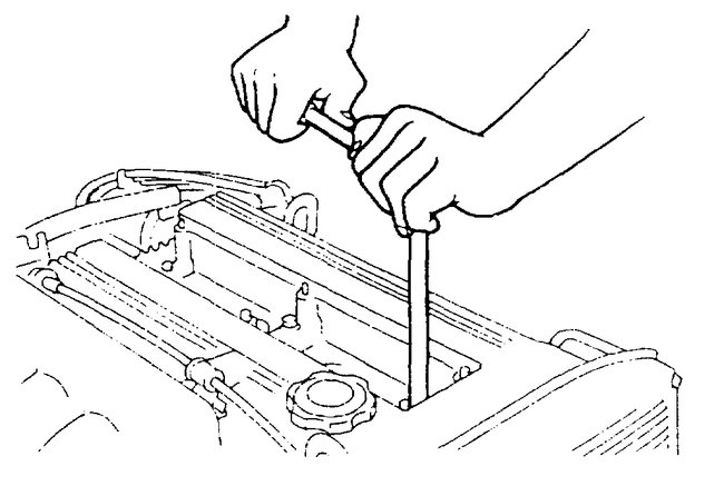

Engine almost starts up. Engine overheated unknowingly by the driver. Driver assumed it was smoke from another issue with the truck and not steam but pulled over upon seeing the steam. Engine now won't start but almost does. After it overheated initially unsure of how long it was in an overheated state but driver did claim she pulled over right away upon site of the steam. Then SUV truck was moved about 5 miles a day later by a ignorant female friend to get it off highway. Then truck was moved another roughly 5 miles more the next day to complete the mission getting the truck off the highway. Unsure if water or radiator fluid was added to truck prior to the 2 additional moves after the initial overheating.

It sounds like you are aware the cylinder head may have been warped or the head gasket blown. If you add coolant now, are there any leaks? When cranking the engine, does it sound normal or is it turning faster than normal?
Do me a favor. Record the engine cranking and upload it for me to hear. I may be able to tell if there is an issue.
Under normal circumstances, I would ask you if the engine was getting spark and fuel. In this case, I think I'm going to suggest checking engine compression unless you feel confident it sounds the same when cranking as it did before the issue. If there is a head gasket or head damage issue, you will likely find one or more cylinders with much lower compression.
Here is a link that explains how to test engine compression:
Here are the directions specific to your vehicle. The attached pics correlate with the directions and the manufacturer's specs are included in the directions.

5. Remove the spark plugs and inspect.
pic 1
6. Connect a compression gauge to the No. 1 spark plug hole.
7. Starting with the compression gauge at zero, fully depress the accelerator pedal and crank the engine for about 10 seconds.
8. Record the maximum gauge reading.
9. Check the compression at each cylinder.
NOTICE: The maximum difference in compression between cylinders should be 26 psi (196 kPa).
Normal compression: 164 psi (1,128 kPa)
Minimum compression: 114 psi (790 kPa)
10. If the compression in one or more cylinders is low, pour a small amount (about one tablespoon) of engine oil into the cylinder and recheck the compression.
a. If the compression increases, the piston, the piston rings or the cylinder wall may be worn.
b. If the compression remains low, a valve may be stuck or seated improperly.
c. If the compression in adjacent cylinders remains low, the cylinder head gasket may be defective or the cylinder head distorted.
pic 2
11. Re-install the spark plugs.
