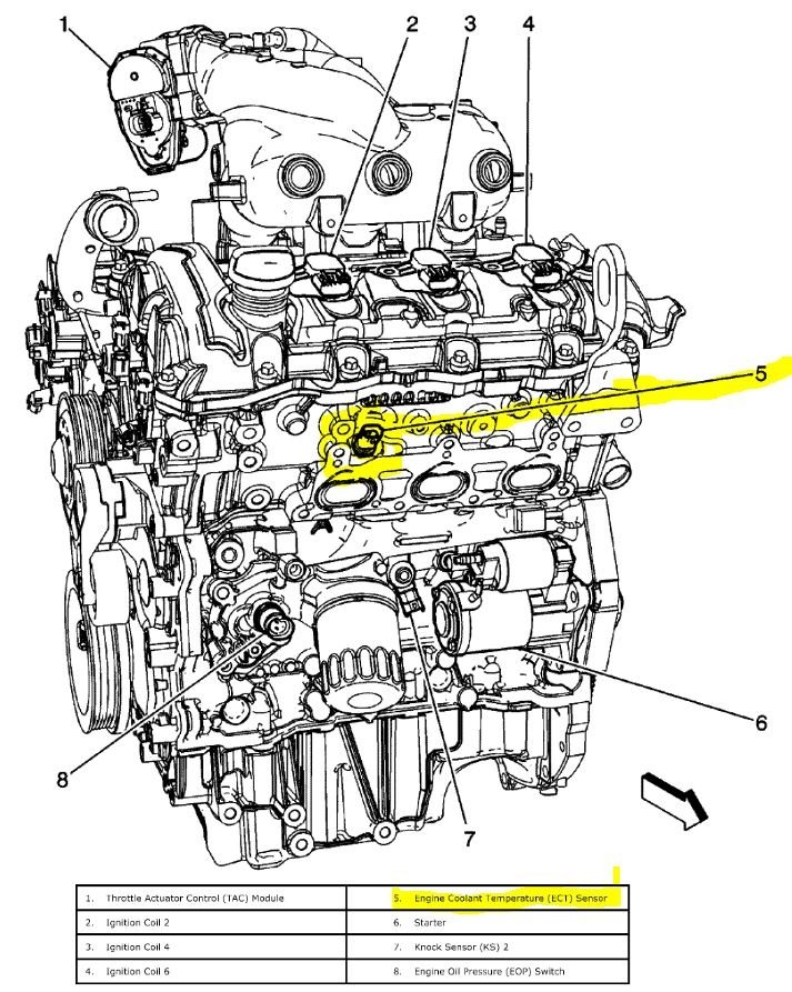

Change spark plugs and cts everything good. How turn off or reset for display turn off.

Okay, you got this message right after you changed the spark plugs? If yes go back to the wiring around the plugs and see if you knocked a sensor wire off by accident. You can get this message if the engine coolant sensor harness is unplugged or damaged. The computer defaults to thinking the engine is hot and starts limiting things in order to cool it off. The sensor is just above the exhaust manifold on the front of the engine.

I also changed that cooling sensor too and checked all wires that I touch only and starts fine just that the fans stay on AC off and the display on dash.

Did you change it before getting this or after? It sounds like the sensor isn't reporting properly, either a broken wire or defect in the PCM are likely. Do you have access to a scan tool that will show live data to see what the ECT is reporting to the PCM? It is acting like the sensor is either disconnected or shorted to power. A scan tool should show the codes to help track it down.

Thank you Steve you help me find the problem, it was the hardness it's broken inside not making any contact.
