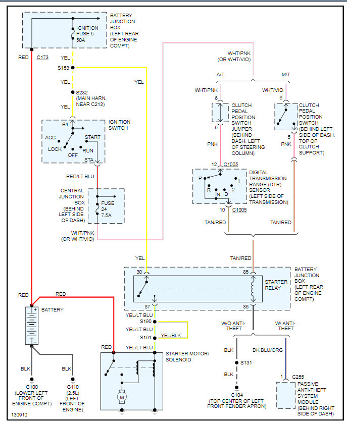

When you connect the battery on my truck the theft light blinks and makes clicking noises behind the dash. It does it with the key on or off. The truck will not crank. Two relays in the fuse box click as well when you hook up the battery.

Okay. This is progress. The next thing is to go to the starter and check for power on both wires. You should have 12 volts on the red wire all the time. Then have 12 volts on the other wire only while cranking.
I suspect you will not have 12 volts on this yellow blue wire. If that is the case then we need to go to the relay and check for voltage on this relay as well.
You should have 12 volts on pin 30 all the time and 85 when the engine is cranking.
If you don't have voltage on 85 then we most likely have a range sensor issue.
Let me know what questions you have. Thanks

I found out the relay doesn't have power but the fuse does.

Update: took the fuse for the anti theft out. Now it cranks but doesn't seem like it's getting gas.

Okay. Found a way to fix it, so far for good. Behind the panel by the parking brake lever there is some wires. There should be a dark green with a purple stripe wire. Ground the wire and it's fixed. Thanks for the help KASEKENNY1.
Saturday, April 10th, 2021 AT 5:51 PM
That is great. Basically all you are doing is bypassing the relay and taking the place of what the theft system does. Thanks for the update. That is great info and I am glad you got it going. Thanks for using 2CarPros.
