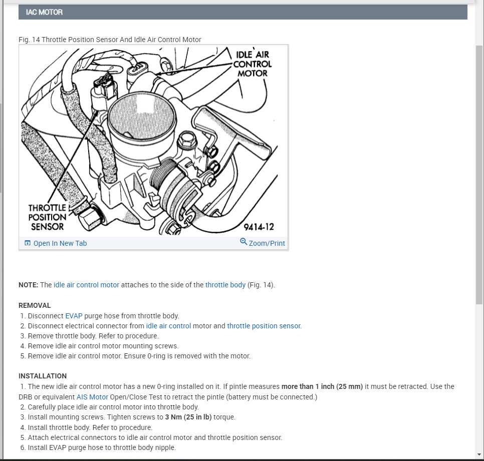

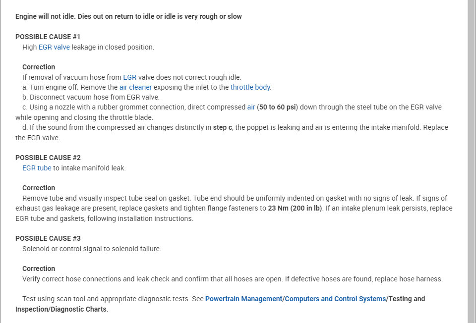

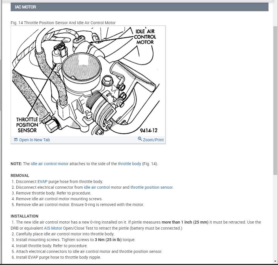

Lastly, we need to remove and inspect the idle air control if there are no codes, plus the EGR valve as well.
https://www.2carpros.com/articles/idle-air-control-valve-service
I am attaching the info needed to run through this testing so let us know what info you find, and we can go from there. Thanks
