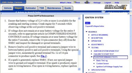

I have dodge caravan 97 3.0 the is thereno spark going through the plugs but there is fire in the control wires to coil is there fire there when the key switch on? Because there on fire when im cranking the engine and where can I find the tranmission control module what does it look like where is I located. Im not sure but I believe the the control wire for the coil is not sending enough power to fire the plugs or the pcm is not getting signal from crank shaft sensor.

My head is spinning. You need to use some punctuation so the sentences make sense. Also, by "fire" do you mean "voltage" or are some wires melting or overheating? There will not be any voltage to the coil unless the engine is rotating, (cranking or running).
Have you checked for fuel pressure? There are three separate but related systems. Most no-start problems are caused by the trigger circuit that turns on the ignition coil, injectors, and the fuel pump.

The 3.0L is not an interference engine so the valves won't be damaged.
The trigger circuit is the optical pickup assembly in the distributor, (camshaft position sensor), and the crankshaft position sensor. He lives in the transmission housing right behind the rear cylinder head, close to the firewall. When pulses arrive from those two sensors, the Engine Computer knows the engine is rotating so it turns on the automatic shutdown relay and the fuel pump relay. The ASD relay sends voltage to the ignition coil, injectors, alternator field, and oxygen sensor heaters.
You know the fuel pump circuit is working because you can hear it run for a few seconds. The ASD relay should be turning on at the same time. Use a test light or digital voltmeter to measure the voltage on the dark green / orange wire in the connector for the ignition coil, an injector, or either of the small terminals on the back of the alternator. You should see 12 volts for one second after turning on the ignition switch. What's important is it must come back as soon as you start cranking the engine.

OK I put a new crankshaft position sensor so I that works I also changed the camshaft position sensor. And yes I hear the fuel pump soon as turn the key to the on position then it stops. And so yours saying the ignition coil, injector and alternater should have 12 volts at each of them for one second rite? Then as im cranking the engine it should be 12 in each items?

Yup. 12 volts for one second at key-on, and 12 volts again during cranking.
Have you checked for stored diagnostic fault codes? Cycle the ignition switch 3 times from "off" to "run" within 5 seconds, then, on older cars you have to count the flashes of the Check Engine light. I think by '97 the codes are displayed in the digital odometer display. There should be a code if the Engine Computer detected the missing pulses from the cam or crank sensor.
Be aware too that a spacer is needed to set the air gap of the crankshaft position sensor. Original sensors use a thick paper spacer stuck to the end, then you push the sensor in as far as it will go. The spacer will slide off when the engine is started. You can get new ones from the dealer's parts department.
Some aftermarket sensors have a thin plastic rib molded on the end to set the gap. That rib partially wears away over time. To remove and reinstall that type of sensor you are supposed to cut the remaining rib off, then use the paper spacer.
In some cases, failure to use a spacer could cause the sensor to break from being hit by the ring on the torque converter.
