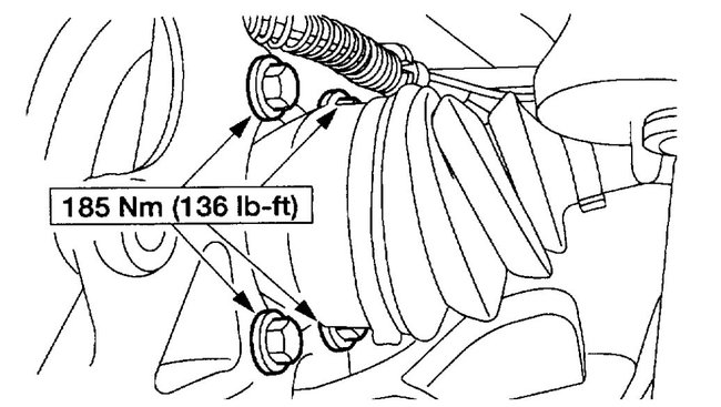

This could also be an axle shaft failing not providing power to the wheels for the car to move.
I attached guides and the procedure below.
https://www.2carpros.com/articles/how-a-cv-joint-works
https://www.2carpros.com/articles/replace-cv-axle
