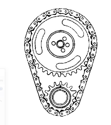

I’m working on this van. It needed a new timing chain, the old chain was original and it skipped 3 teeth, I have spark, I have fuel, I replaced the ignition coil, distributor cap, with wires, and spark plugs. The starter that was on the truck started smoking bad and shot a fire ball out the intake and lit my arm hair on fire. I’m thinking of replacing the crank sensor.

How did you set the marks on the chain? It sounds like you have the distributor in 180 degrees out causing the backfire. When you turn the key to the on position without cranking the engine over can you hear the fuel pump run in the tank for 5 seconds?

I have the cam gear at 6 and the crank at 12. The previous mechanic put a new distributor cap and wires on. Could he have possibly installed it wrong?

Yes he did. I pulled the rest of the motor apart to look at the markings and turned the crank to line up the old set. And it was off by 3 teeth.

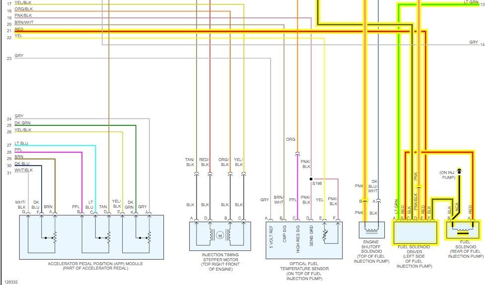

I unplugged my PMD from my injection pump into another PMD, instead I plugged my old PMD back in cause the other one failed, now i have no supply pump , and i cant even by pass the supply pump to make it run. There for the truck wont start.
Oct 5, 2020 at 11:00 AM (Merged)
Good morning,

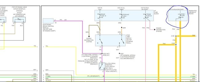

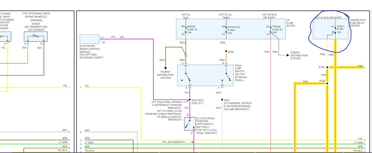

Do you have a voltmeter to do some checks on the PMD?
I attached the diagram for you to view. You need to test the fuse I circled as that powers the PMD.
Did you replace it with a new one? Used is never a good idea.

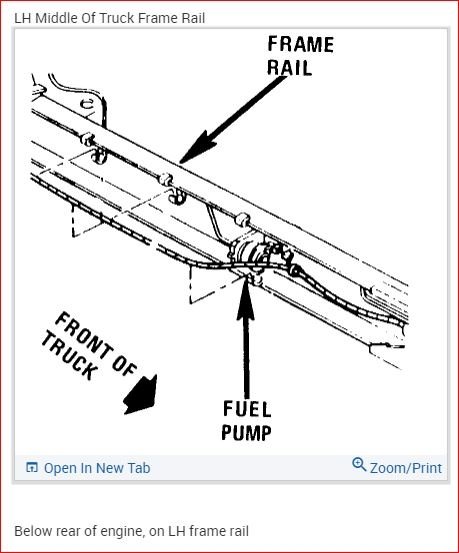

My van will run great, then I can drive it to a store come out and it will not start? Wait fifteen minutes it will start right up to drive it home. I installed a new distributor with new cam sensor, cap and rotor, wires and plugs, new crank sensor, new coil and regulator but, now I am stuck and need some advice.
  • 54,494 POSTS
Hello, this sounds like a classic fuel pump that is going out. But to be sure when it will not run can you hear the fuel pump in the tank running?
Please report back. :)

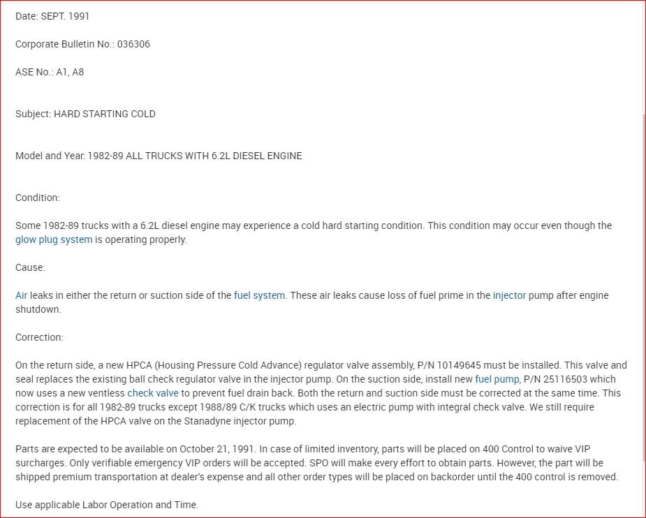

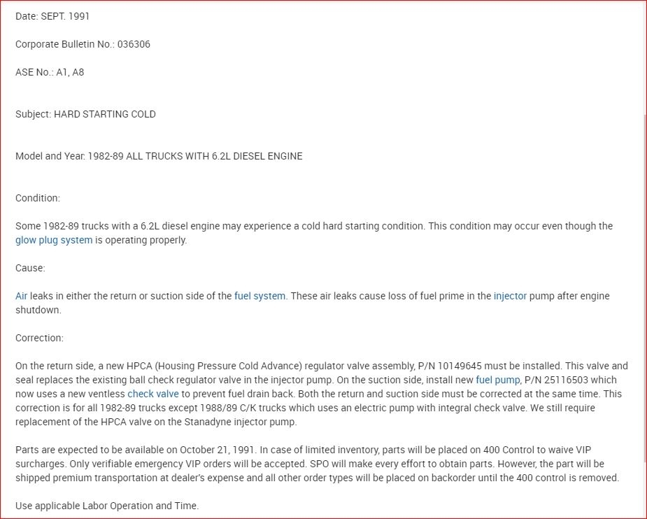

I have a 6.2 diesel in my k2500. every time I go to start it up all it does is crank over. like it is not getting fuel. so I changed to fuel filter and bled the lines. and still wont start. until I put some spray in it then it fires right up and has no problem staying running. what could this be?
It definitely sounds like a fuel delivery issue but that doesn't mean it is a pump as you would expect. Basically you are loosing fuel pressure or loss of prime as they call it on diesels.
What happens after the engine is warm? Does it start up without starter fluid or do you have to use it every time? In other words, how long does it have to sit before it won't restart?
I attached a TSB that addresses hard starting issues on these engines. Basically, it is saying that there is an air leak and that causes the loss of prime.
Let me know if this appears to apply and if not, we can go further. Thanks

Okay. Sounds like you are losing prime. You have what is called a lift pump that supplies the fuel to the injection pump which turns it to high pressure. If the high pressure pump does not have any fuel delivered to it then it has nothing to pump. Once you give it fuel with spraying it, the air lock is overcome and it starts the engine by pulling the fuel. We know the high pressure side is working because it runs just fine.
I would check the TSB that I provided previously and then if you find no air leaks, then I would put a fuel pressure gauge on the fuel delivery line in front of the high pressure pump. Then just turn the key on but don't crank the engine. You should have between 5-10 PSI with just going to key on. If not, the lift pump is probably your issue.
