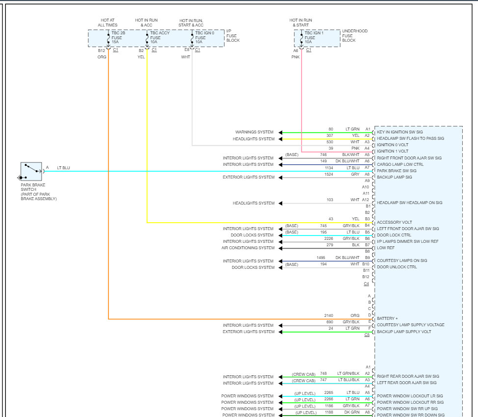

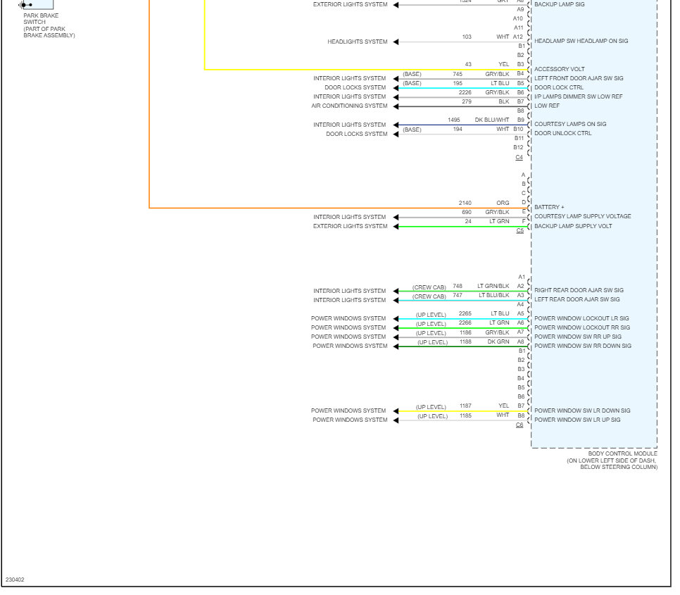

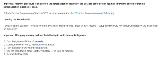

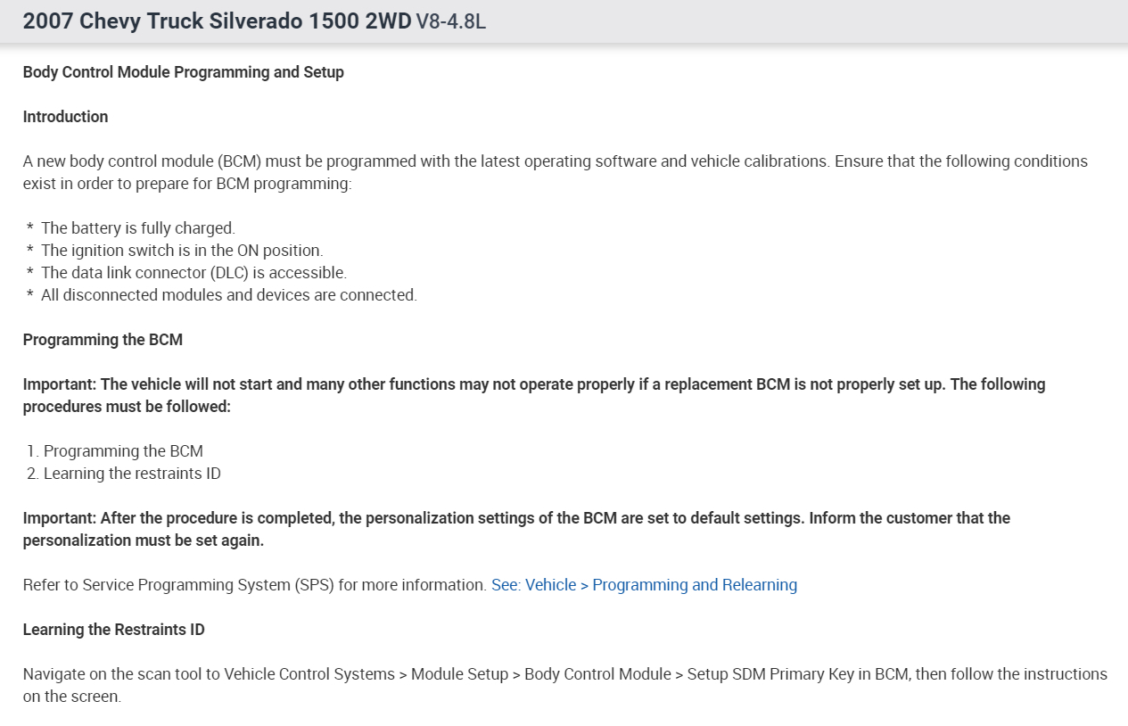

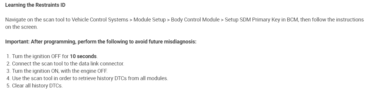

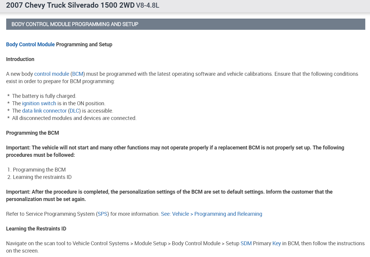

Yes, that could be the problem, power for each run through the BCM but to be sure we can run a CAN scan, you can get a CAN scanner (Controller Area Network) from Amazon.
https://youtu.be/u-4syLc-ifQ
and

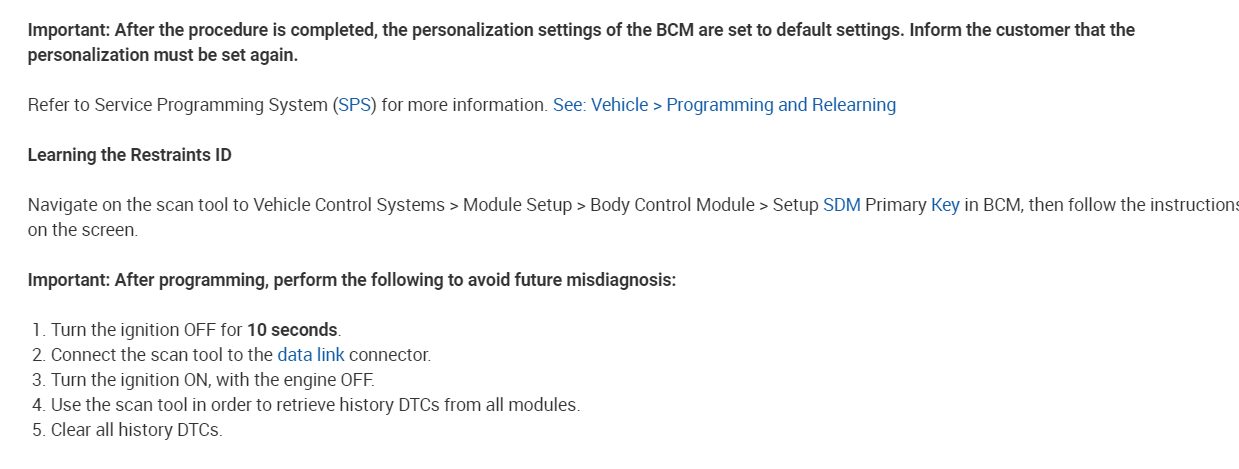

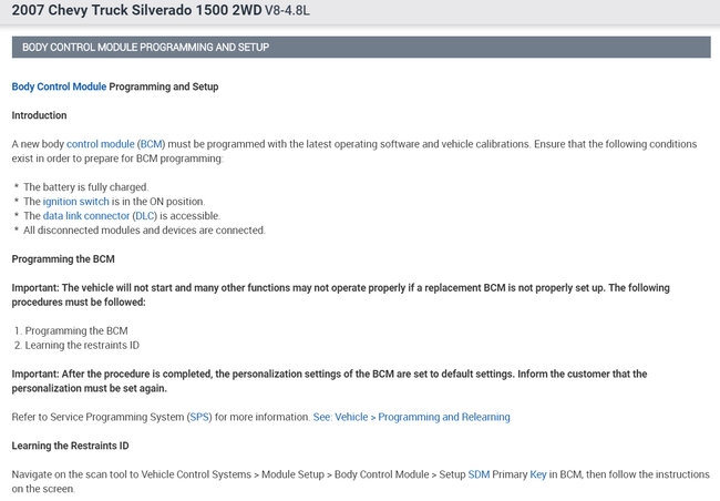

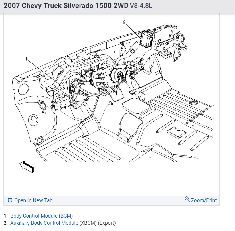

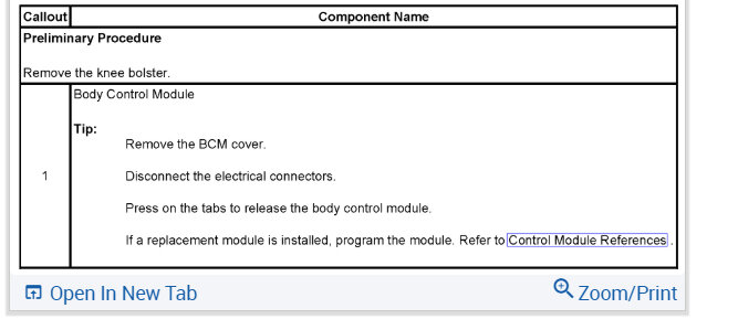

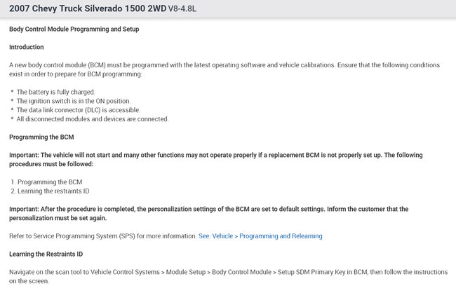

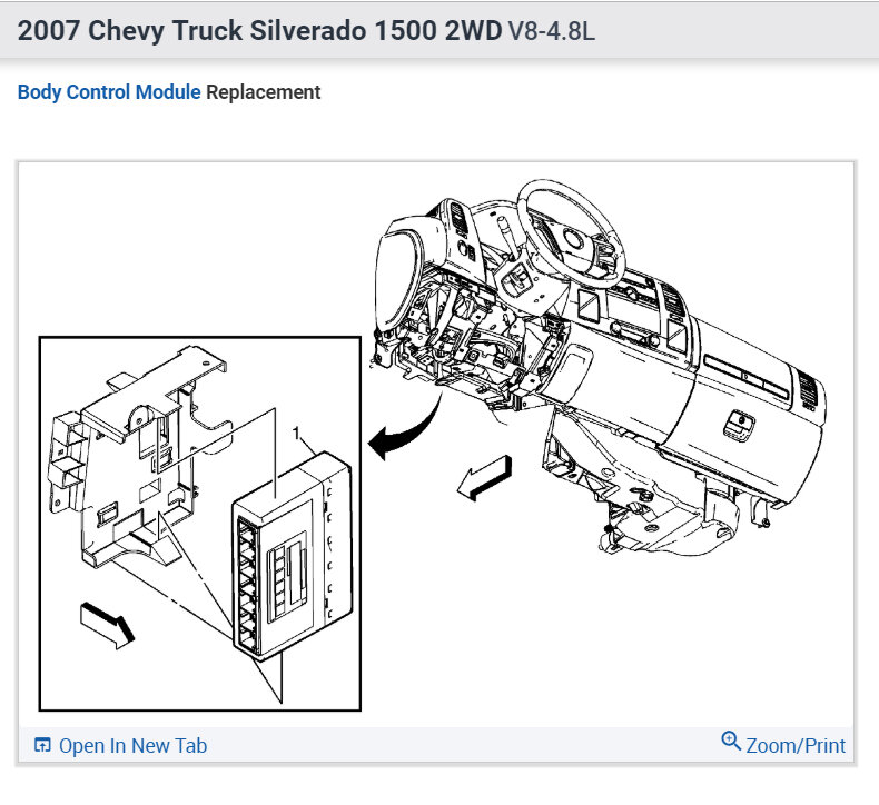

Here are the BCM replacement instructions in the images below. You can get a preprogrammed unit by searching Google or Ebay.
Tuesday, March 14th, 2023 AT 10:28 AM
BDW3671
  • 5 POSTS
Replaced the BCM and finally got everything back to normal. I also relearned the anti-theft system. Now all that's left is the service air bag light. Thanks for all your help guys!

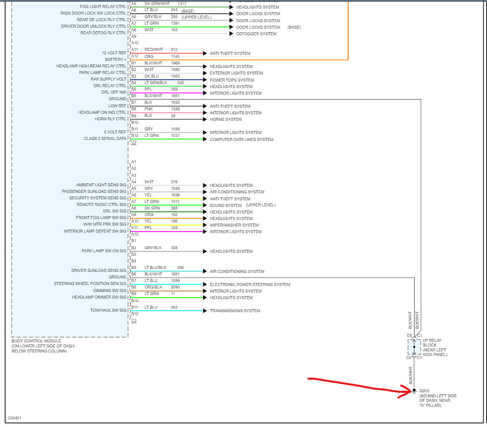

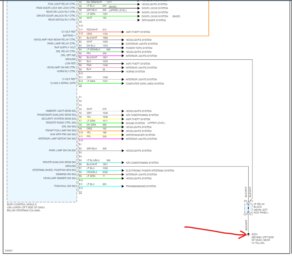

Well, got in my truck tonight and the BCM failed on me again. Any suggestions?
Sunday, March 26th, 2023 AT 11:11 PM
KEN L
  • MASTER CERTIFIED MECHANIC
  • 55,488 POSTS

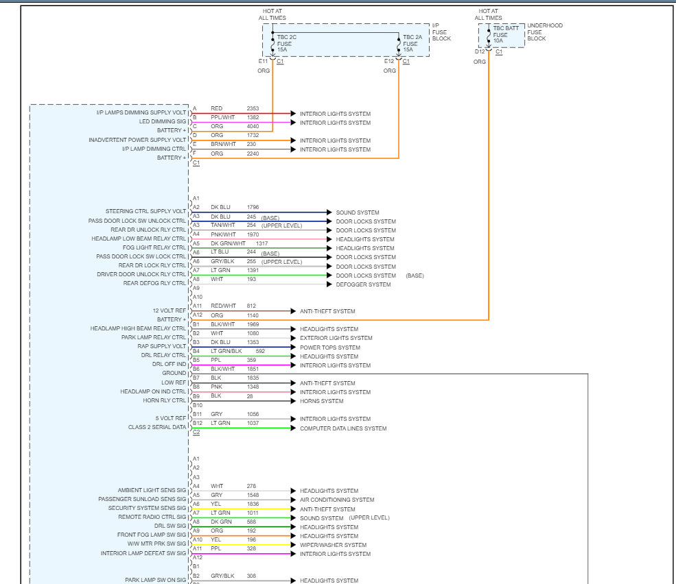

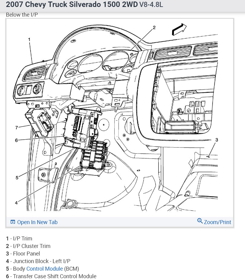

I have seen a bad ground connection to the BCM cause it to overheat. here is a guide to help you check and the BCM wiring diagrams so you can see how the system works and which wires to test:
Also make sure the electrical connectors are free from corrosion. Check out the images (below). Please let us know what you find.
