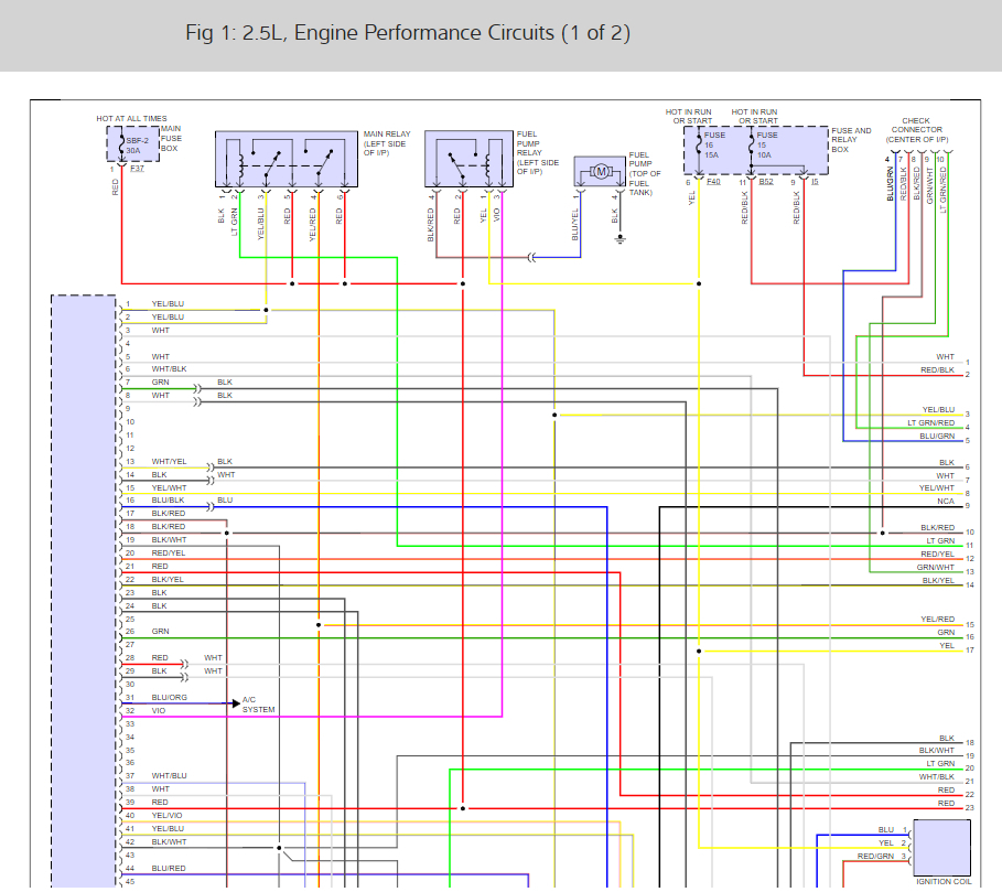

Blown head gasket was the initial problem, so it ran a little. Removed cylinder heads, had them worked over at a machine shop, new gaskets, seals, timing belt, plugs, wires, cam sensor, crank sensor. Put it back together, cranks but will not start. Checked fuel pressure, 35 lbs. Pulled spark plug wire out of coil and turned engine over, spark is present. Squirted a little fuel into intake and still would not start. Changed cam and crank sensors. Pulled covers off the front of engine to double check timing marks, cam timing lines up perfect, but not wanting to turn the engine over by hand eighty four times to line up the crankshaft mark and the cam marks on the timing belt. I took the timing belt off and started over, lined everything up again and still would not start. Checked tooth count on belt thinking maybe it was wrong but it is the same as old one, 281. Any help would be appreciated. Thank you!

When you install the timing belt for a subaru there is specific instructions. Here is a guide to help us double check your work. Also please take a compression test.

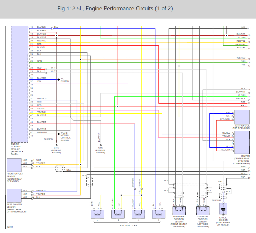

The spark must be at the wrong time is the only thing that can stop it from starting. Anyway this can be? Crankshaft trigger in the wrong place or? Can you take a picture of the crankshaft sensor?

I was wondering that same thing. I've changed the igniter with 3 others and still won't start. The crank sensor is in a fixed position, same with the cam sensor.

I pulled the left intake timing belt gear off today and inspected the pickups on the back, they all looked good. The one thing I did find when checking spark is that when I check the spark on the front two cylinders the spark is double, the back two looks normal, what's up with that? I've changed the igniter with three used ones I pulled from other Subarus. This must be my problem but how do I correct it? Again remember the car ran before I took it apart. I'm not a Subaru mechanic but learning quickly. Thank you again guys!

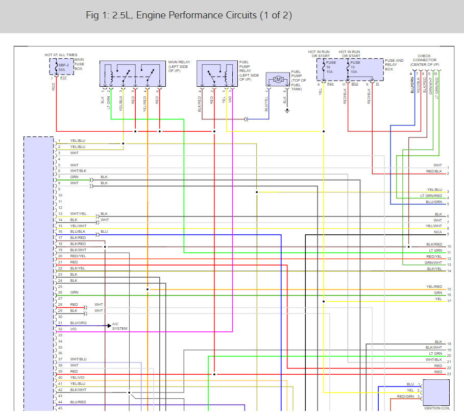

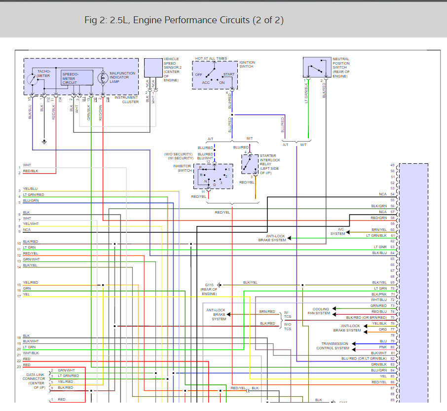

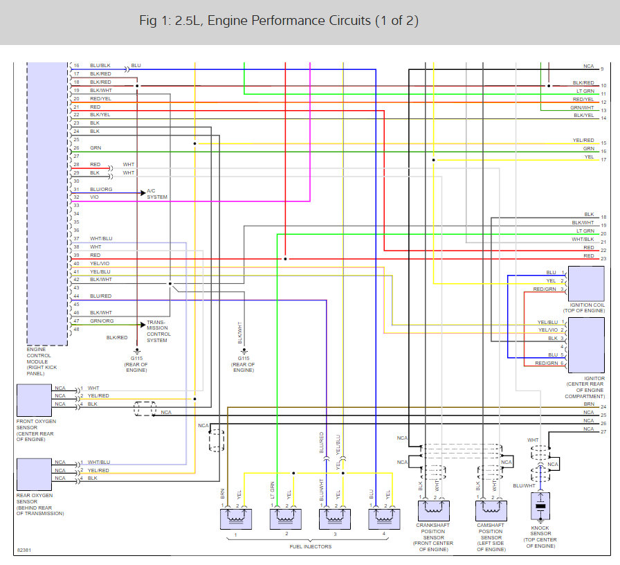

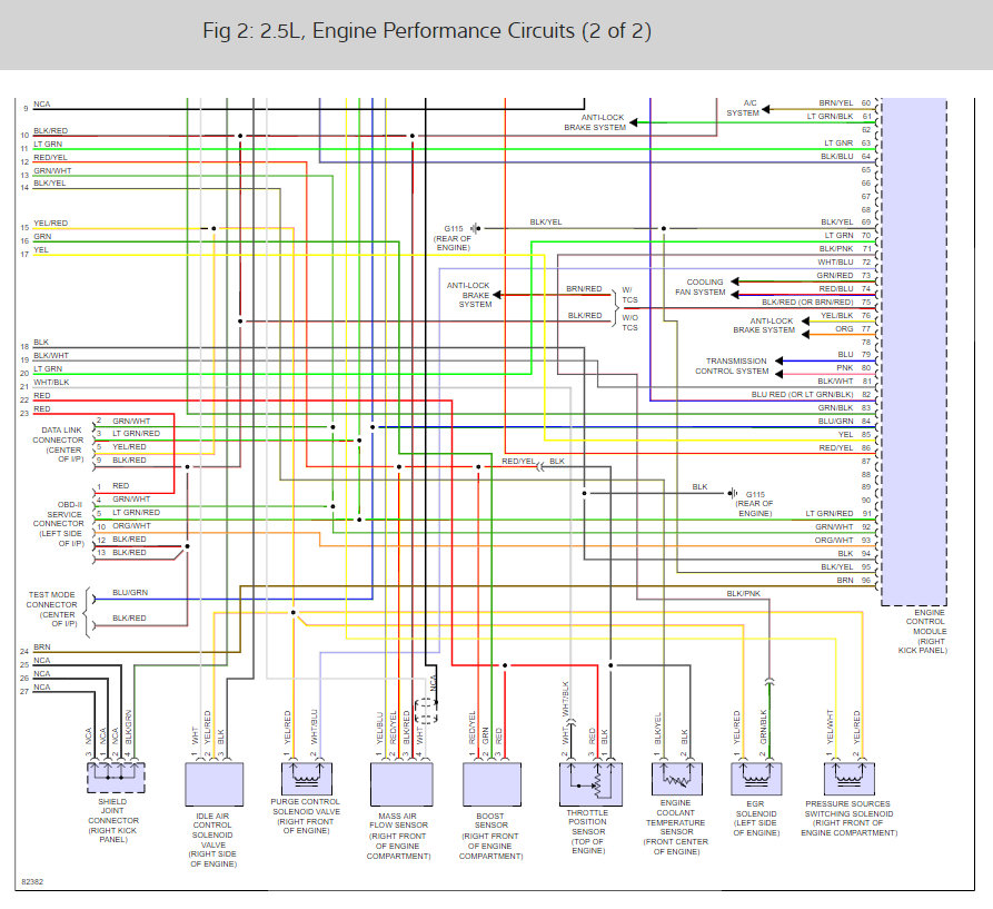

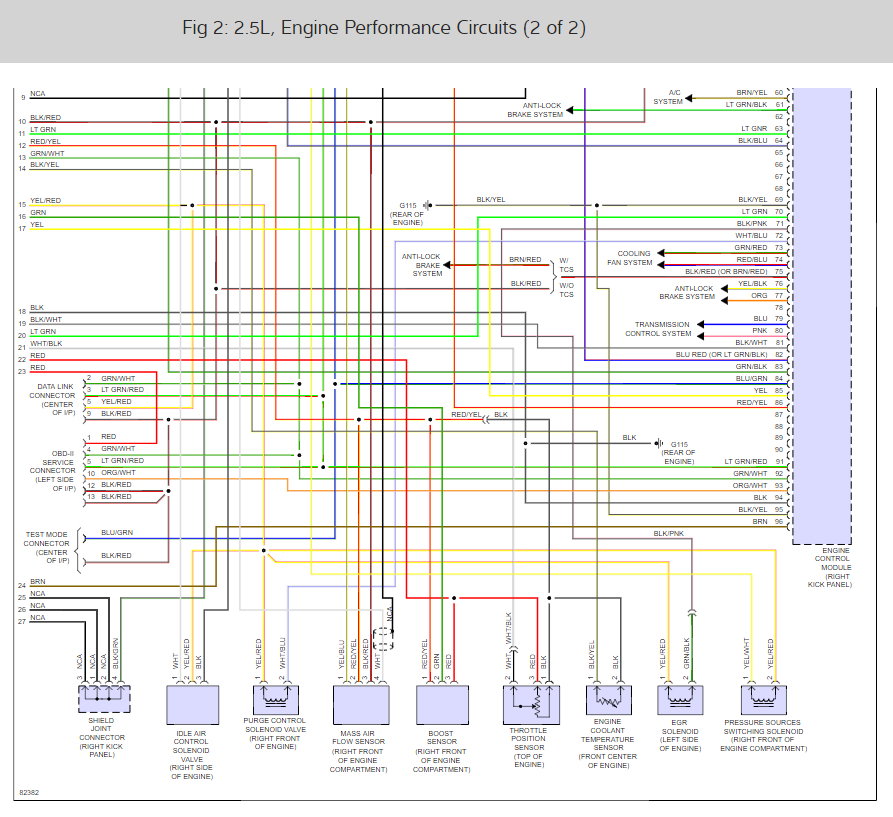

It sounds like you could of had a voltage spike that affected the ECM and fried the coil drivers but first lets check the wiring to the ECM power and grounds to make sure it has them all. here is a guide and engine wiring diagrams so you can confirm.

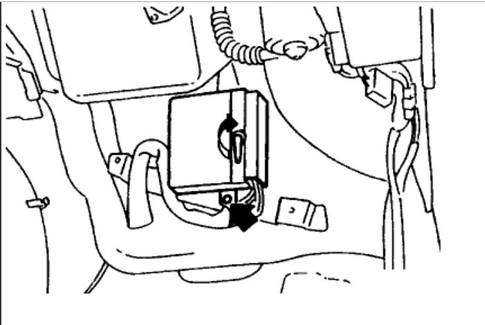

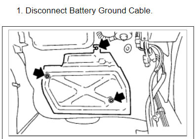

Can I put another ECM in my car to test to see if that's the problem? From another 1996 outback legacy.
Thursday, January 18th, 2018 AT 7:01 PM
KEN L
  • MASTER CERTIFIED MECHANIC
  • 55,512 POSTS
Yep you sure can, here is the location. Let me know what happens have a good weekend. ;)
