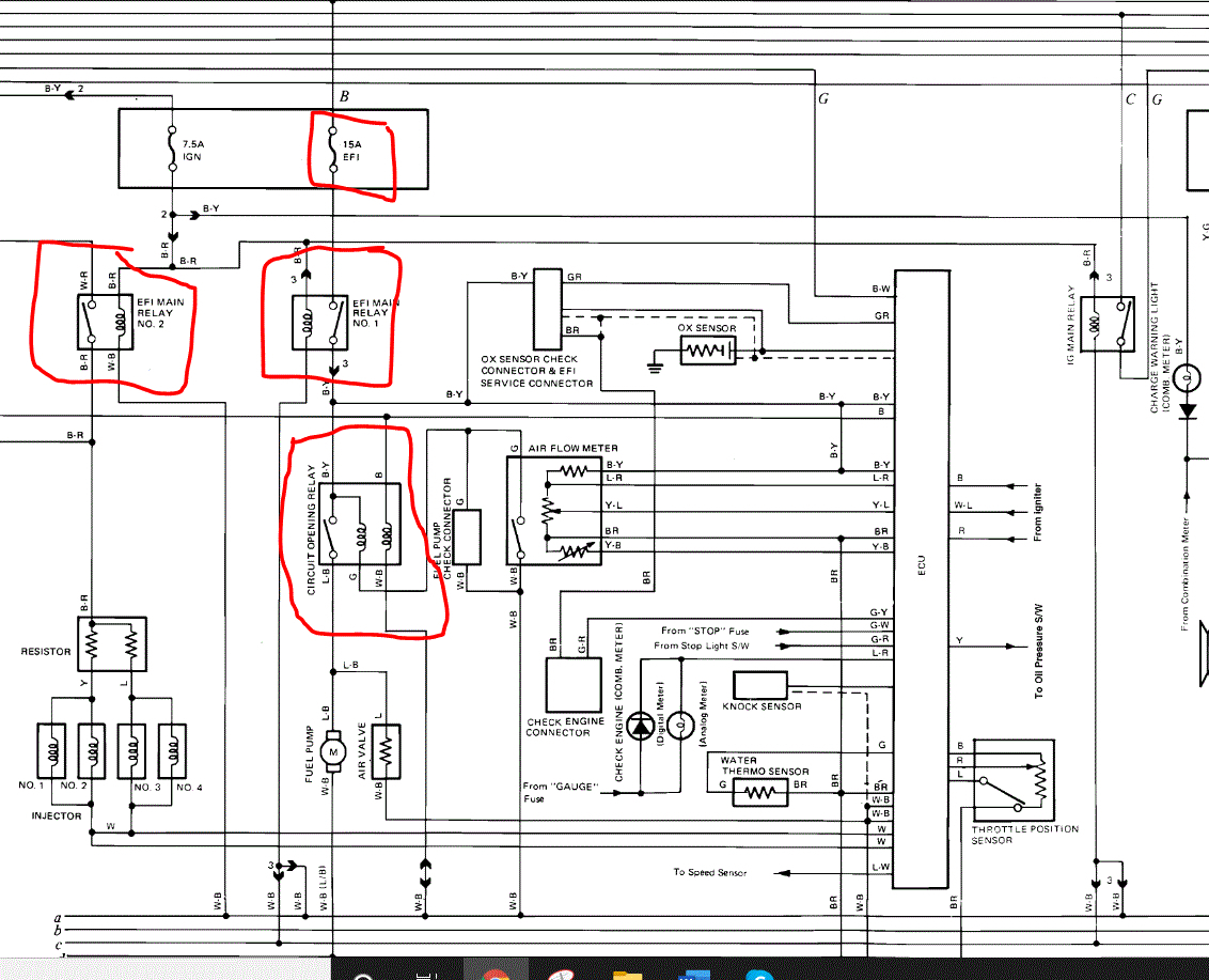

Well, I did a diagnostic with the 2 pin and I have got several codes first I was a #7 then a 28 the #7 is I take it is the mass air flometer sent it in and had it repaired. From then on I have been getting all kinds of different code and I ca not clear all the codes without the same codes coming up. It was running great but then all of a sudden it stopped but I do have to say that my steering rack was bad and I had a very very bad vibration for about 4 months before I replaced the steering rack. Rack now is good, but was wondering if a bad vibration would cause anything to go wrong? I have been working on it now for 8 months.. Old man needs car, lol.

Well, I had a mechanic look into the fuel system and I have 50 pds of pressure and yes the fuel pump does work. I hot wired the cold start injector and it runs but after a couple of minutes it floods out and stops running.

I have spark, I have fuel, I have air, but it seems the fuel injectors will not keep firing fuel to keep it running. Also the above articles is nothing like my engine in my car so I am lost.

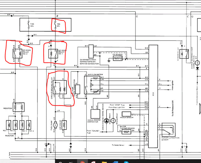

Have you checked the EFI fuse as well as the EFI relays and Circuit Open Relay? Here is a link that explains how to test a relay. Also, I attached a portion of the wiring schematic related to the injection system. If the injectors are working and then not, chances are it isn't the fuse, but a relay could cause the issue.
Let us know.
Monday, June 15th, 2020 AT 8:48 PM

Well, I do understand, but I do see one relay on the fuse box not sure if it is EFI 1 or EFI 2. All it says is EFI fuse not relay. So I am so confused. And I do not know where the circuit opening relay is does not show anything in my book where all these relays and circuit are located.
