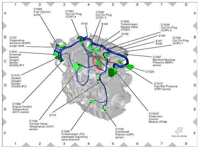

The coolant temperature gauge had been climbing to three quarter and then going back to middle. Sometimes it gets a little bit hotter. I have replaced the thermostat already and it was fine for a week and it is doing it again. I have got a replacement coolant temperature sensor for it but I cannot find the location of the sensor to replace it. Do you know where I can find the location of the coolant temperature sensor?
Jul 30, 2017 at 12:45 PM
CARADIODOC
  • 34,322 POSTS

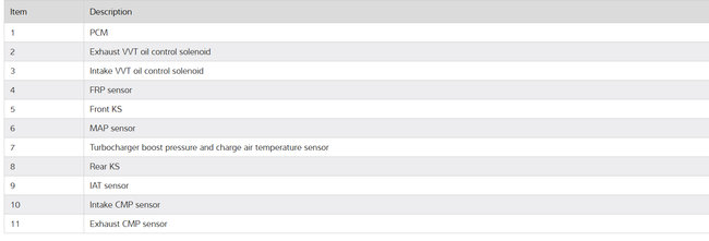

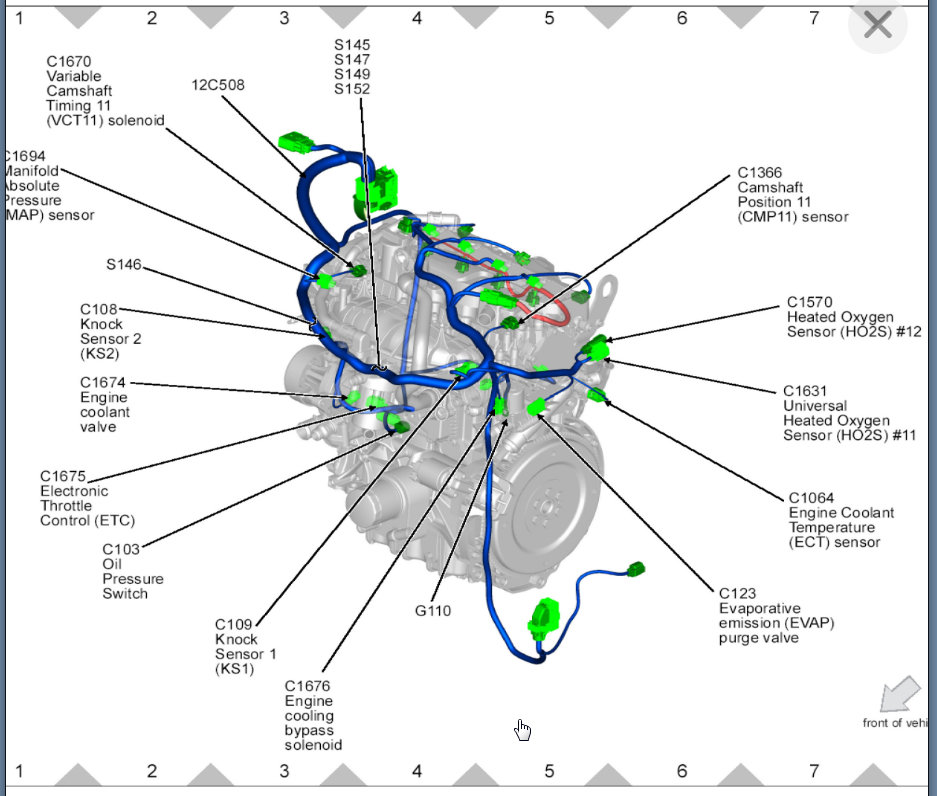

The sensor is telling you the engine temperature is too high. First you have to determine what affects the overheating. If speed is a contributing factor, and the overheating only occurs at low speeds, suspect the radiator fan is not turning on. That is not needed at higher speeds where natural air flow is sufficient.
Your car is too new for this, but if running the heater on "hot" and the fan on a higher speed brings the engine temperature down, corroded cooling fins on the radiator are a good suspect. A large butterfly collection in the radiator will do that too.
Another real good suspect is a leaking cylinder head gasket. The gases that get into the cooling system can pool under the thermostat and cause it to not open. Thermostats have to be hit with hot liquid. Hot air will not do it. A leaking head gasket is usually accompanied by the loss of coolant from the reservoir. There is a chemical test to check for this.

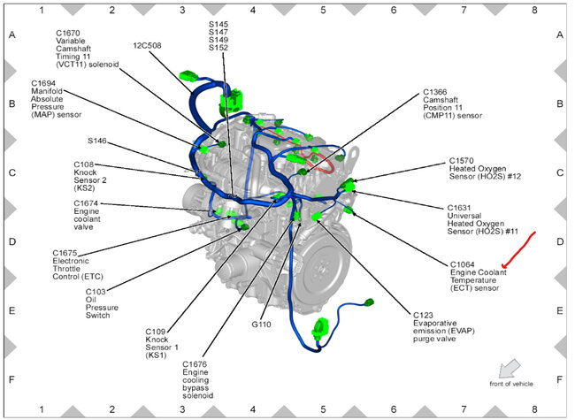

Here is the location of the engine temperature sensor and all the other sensors with a guide to help see whats going on if the sensor does not fix it.
https://www.2carpros.com/articles/engine-overheating-or-running-hot
Check out the diagrams (Below). Please let us know what happens. (ECT is the sensor you are looking for.)

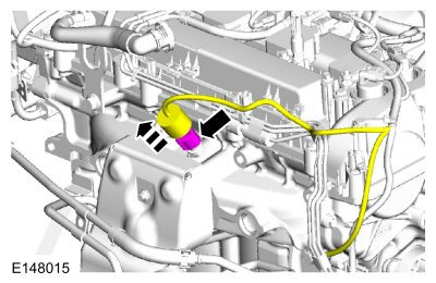

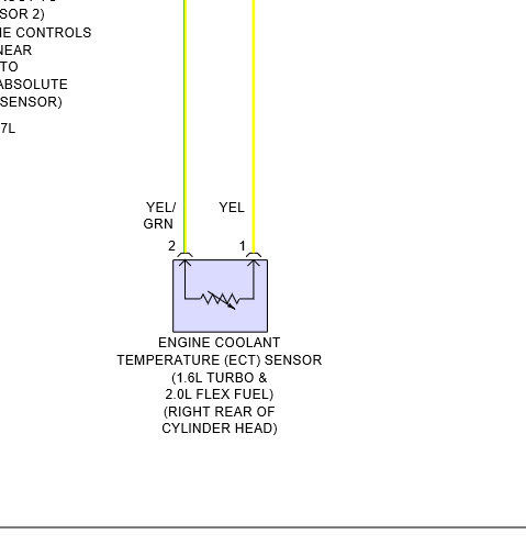

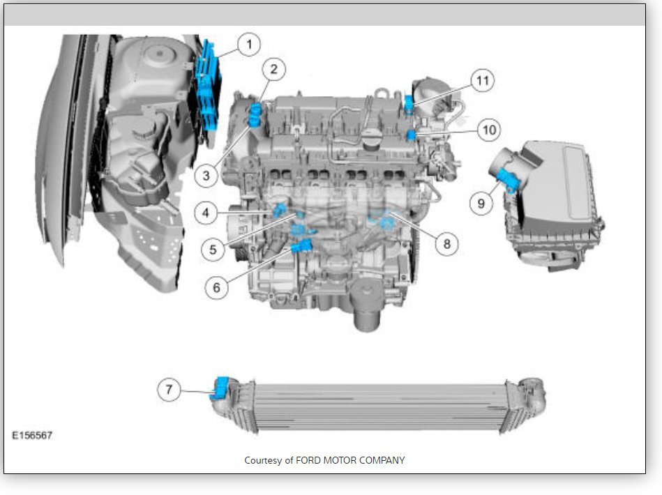

There are two different places it can be depending on the engine which I have supplied both. Check out the images (Below). Please let us know if you need anything else to get the problem fixed.
Aug 29, 2020 at 6:00 AM (Merged)
JOHN ANDERSON2
The engine is the 2.5l direct fuel injected with turbo.
BMDOUBLE
  • 1,139 POSTS

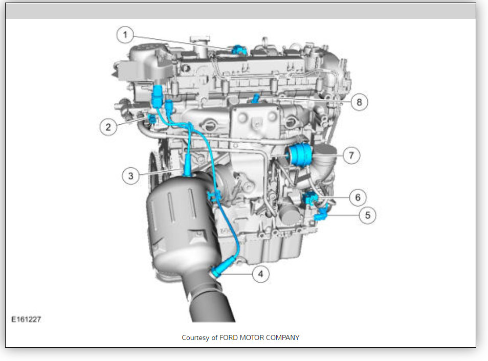

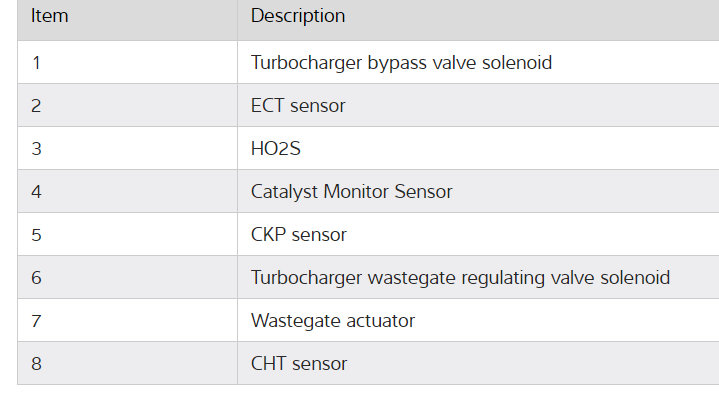

The 2.5 is not a turbo, so here is a picture of the 2.0 turbo cht location. The 1.6L and 2.0L are turbo models.
JOHN ANDERSON2
My apologies, i am getting to old for this. The mechanic I had said it was a 2.5 it is the 1.6.I have been working on this for 5 days now waiting from my local contacts to help with no luck. Sorry about the quality but here are some photos I just took.
BMDOUBLE
  • 1,139 POSTS
Okay, no problem, here is the 1.6 location.

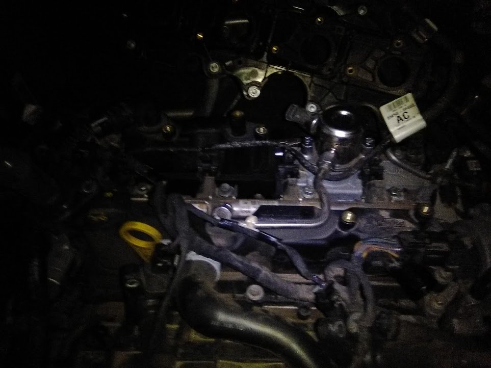

ECONNER123
  • 5 POSTS
Coolant is leaking into sensor creating a miss. read have replaced it twice. was wonder if there is suppose to be a seal in the coolant sensor port?
  • 110,209 POSTS
Is coolant leaking past the threads? If so, there is no seal. Try using Teflon tape on the threads and then properly tighten.
Let me know if that helps.
ECONNER123
  • 5 POSTS
It doesn't have threads.
  • 110,209 POSTS

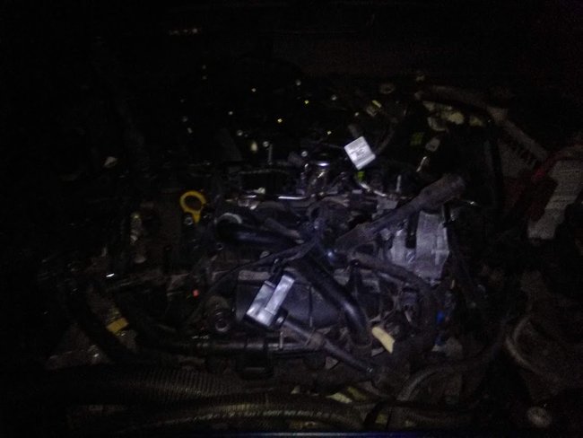

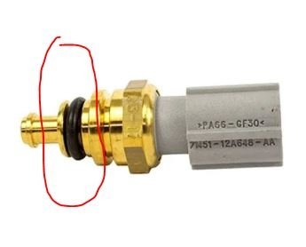

Can you upload a pic of the part? I'm seeing one that threads into the engine in my manuals. How does this one attach?
  • 110,209 POSTS
Okay, I found it. It is the one held in with a clip. First, pull the connector off and see if it is wet inside. These commonly go bad an leak through the sensor into the connector and then out. Also, there is an o-ring on the sensor. If it isn't leaking through the sensor, remove the old one, make sure where it goes into the engine is clean, and lubricate the o-ring prior to install. I usually use something like vasoline. If you don't lubricate the o-ring, there is a good chance it will be kicked and leak.
Make sure the sensor is fully pushed in and that the clip is properly seated.
I attached a pic of the sensor and circled the o-ring that I mentioned. However, remember that the o-ring may not be the problem but instead, it is leaking through the sensor, into the electrical connector, and then out.
Let me know if this helps.
ECONNER123
  • 5 POSTS
I have put two new ford OEM sensors in and they both leaked into the plug the guy at O'riellys said it more than likely is not the sensor but maybe all the sensors are bad?

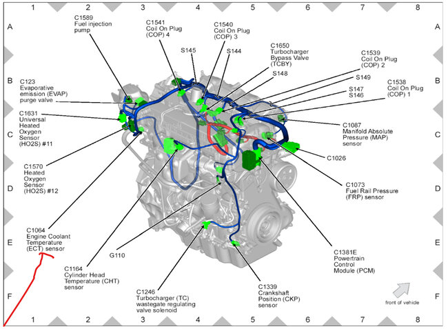

I am having trouble locating the coolant temperature sensor in my car. can you help me? I have searched on the internet and can't seem to find my type of vehicle. Thanks in advance.
  • 110,209 POSTS

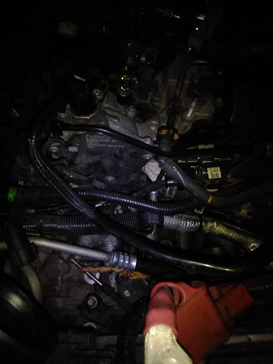

This vehicle has a cylinder head temperature sensor (CHT). The CHT is on the rear of the cylinder head. See the attached pic.
If there is a coolant temperature sensor that is different, it will be located near the thermostat housing.

There is no normal coolant temperature sensor as we normally think of them. Your engine uses a cylinder head temperature sensor.
