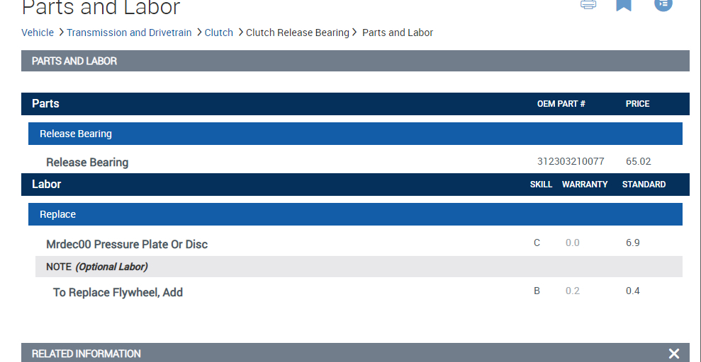

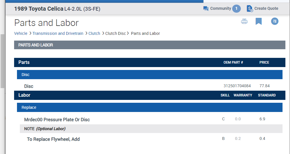

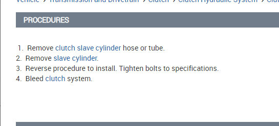

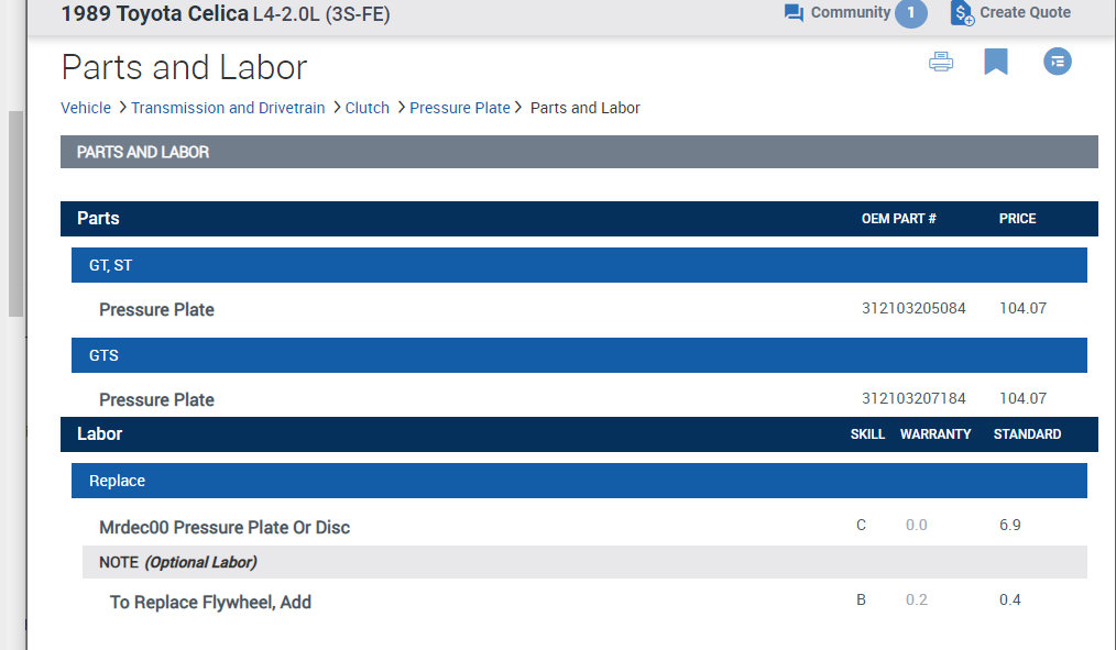

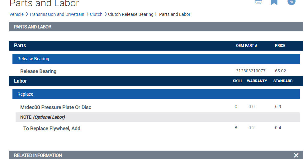

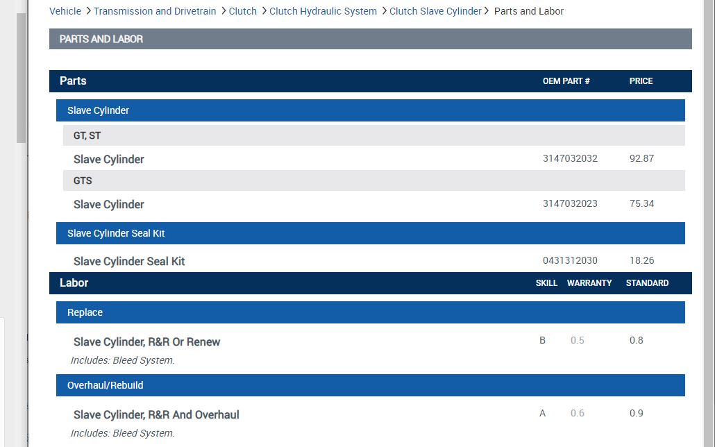

In short I think you nailed it with it needing a clutch as these are all clear signs that the clutch is not fully disengaging which means you slave cylinder/throw out bearing are not releasing the clutch.
Here are a number of guides that talk about this in more detail and how to repair it:
https://www.2carpros.com/articles/clutch-doesnt-work-sometimes-or-not-at-all
https://www.2carpros.com/articles/clutch-symptoms
https://www.2carpros.com/articles/how-to-replace-a-clutch
https://www.2carpros.com/articles/throw-out-bearing-replacement
https://www.youtube.com/watch?v=EpBMj5ZY_bo&pp=sAQA
We are going to have to rely on these guides and this video as the manual does not provide much detail at all on how to do this:
https://www.youtube.com/watch?v=6N6b5F2ChyE&pp=sAQA
Please see below for this info and the part numbers for most of all you will need to replace.
