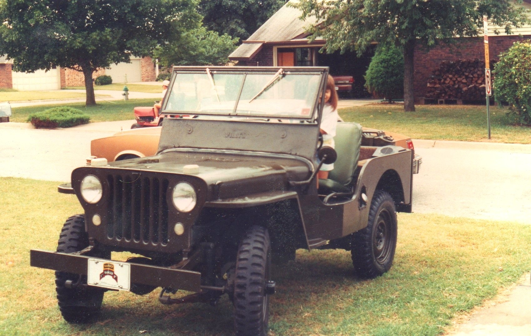

I gave $100 for sick "Willy" back in 1991
I'm willing to go $150 if you get desperate! Lol!

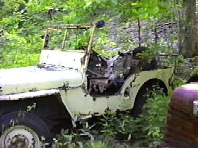

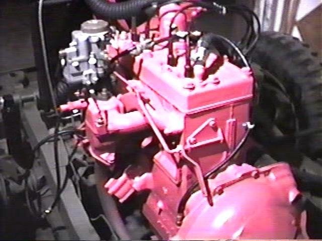

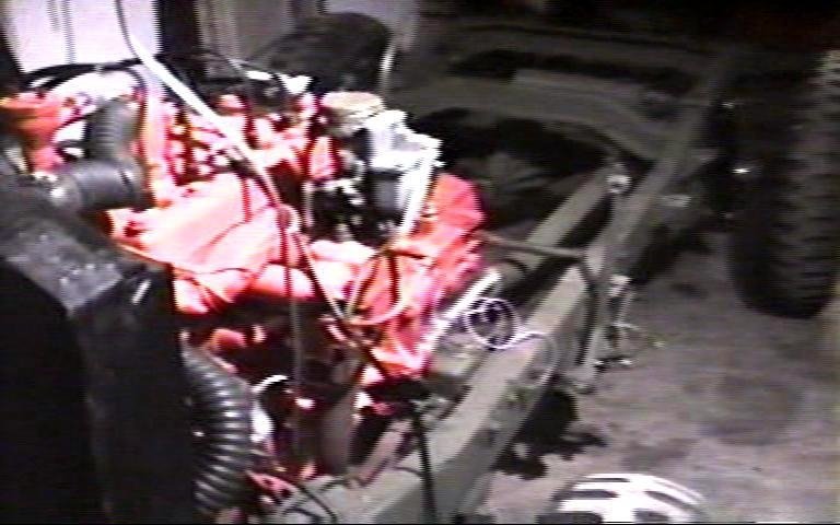

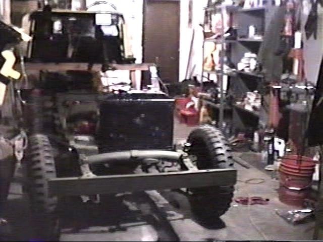

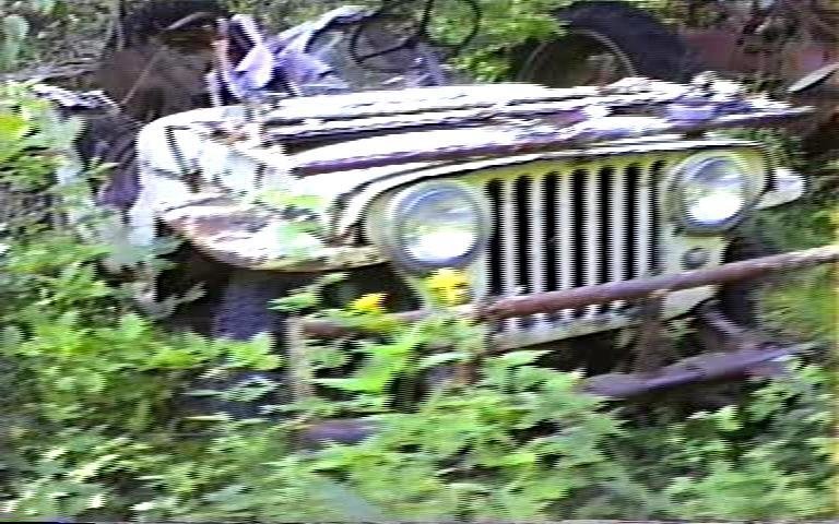

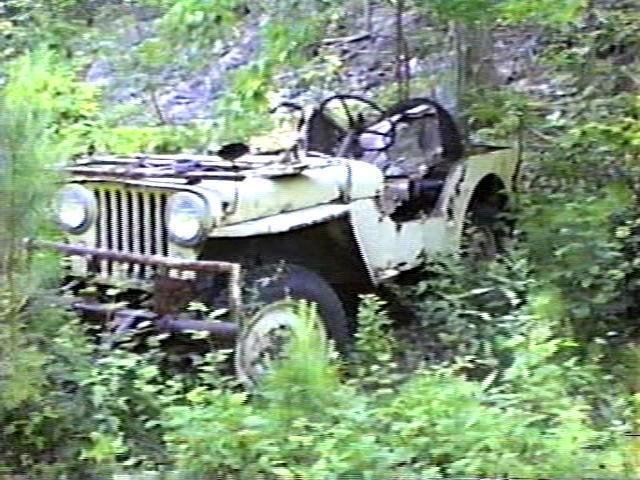

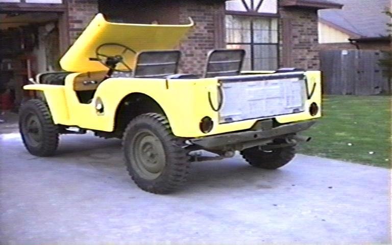

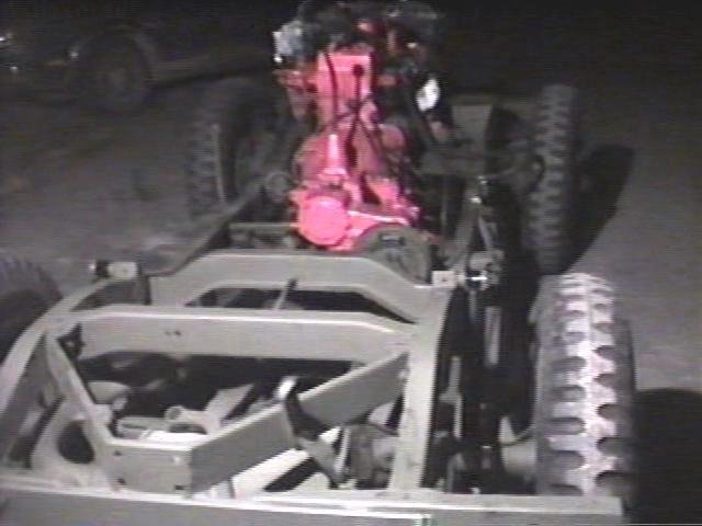

Yep, that was Willy, here's a few more.
Unfortunately, back then pictures required developing or were VHS (in this case).
I wasn't much of a picture taker, but my buddy had a cam corder and that was high tech in '91!
A while back, another friend converted my few VHS tapes to digital and I was able to make some screen shots.
This was shots from "My" day 1 with Willy till he was street legal again two years later. All within a one car garage on my side of the duplex I was renting. Next to the last pic is my four year old little girl who helped all along. Last pic, she's now 32 and Willy is 73.
No sense in yours sitting idle, you need to jump on it! For two long years I longed to drive my own Willys Jeep.

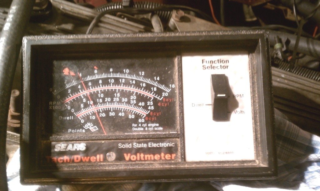

Everybody wants you to convert to something totally odd and hard to work on. On a Jeep, there's really no more betterment in changing stuff, just more confusing to hook up and use. I suggest leaving the distributor and ignition system alone. Unless you want to make a backup system to use after the ICBMs stop falling and the EMPs have destroyed all electronics. A point system could be installed fast and be usable.

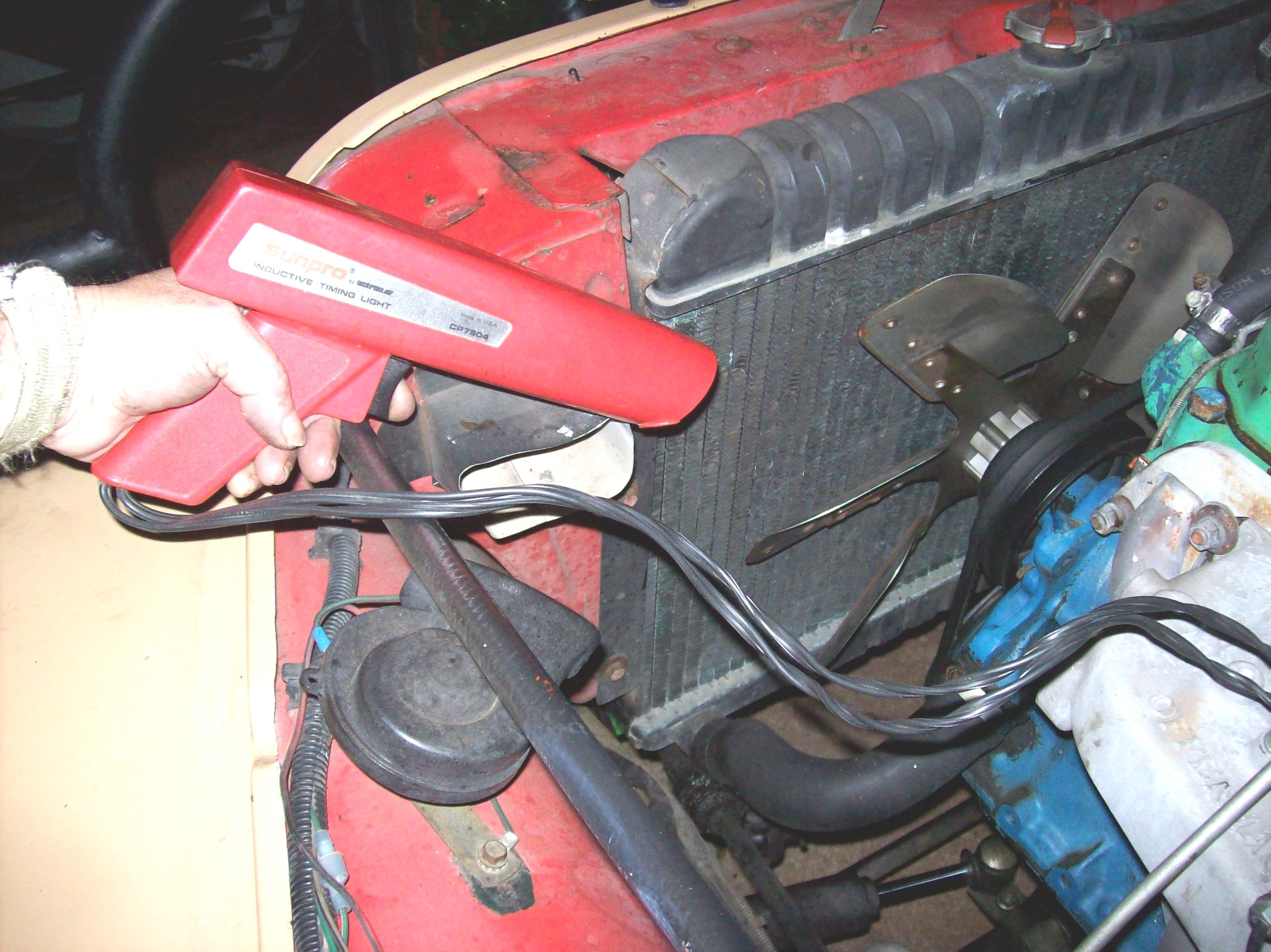

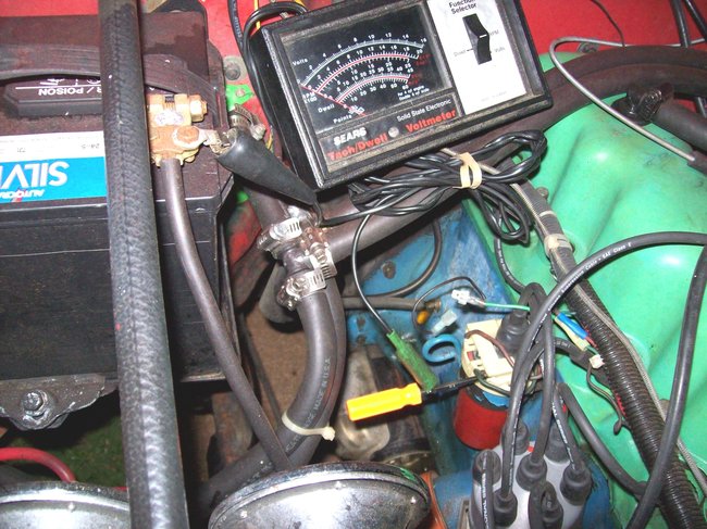

A dwell/ tach is a really good tool, I like it better than using a vacuum gauge to tune the carburetor. A plain Jane non-adjustable timing light works well too.
I see them cheap in pawn shops now days.

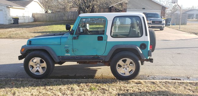

IF y'all are interested. Here's Beatrice "Trixie" my wife's TJ. Picked her up for a steal because she needs a lil work on the frame (2 weld-on patches @ $150 each) otherwise, runs and drives great.
