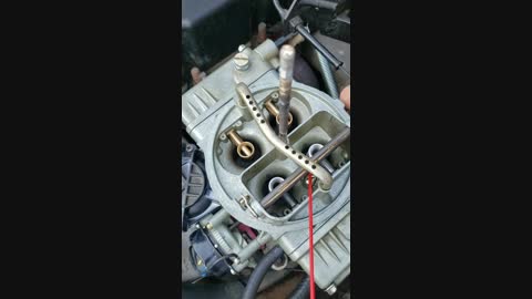

Took a little 15 second video of the stumble. Going to try to figure out what it takes to upload to YouTube. Once I do, I'll post a link to it for ya.

Let's see if this works.
https://youtu.be/rGrExHFPP8g

You don't have to upload to YouTube, you just upload directly to this site. Could you do that again without the air cleaner on, want to see what the secondaries are doing as the throttle opens, also open it a bit slower please.

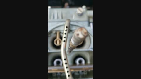

I have 2 videos. 1 with slow acceleration to stumble the other I think I accelerated a little too quickly, but it does include carburetor cleaner with an improvement. I'm hoping you're able to see the butterflies in both videos.
Let me know if you can't and need a better view or anything.

It looks like the secondaries are not adding any fuel? Cannot tell for sure but I can see the accelerator pump squirt on the primaries, and fuel spray there. The other side looks dry. Do you see fuel on the other side?

From what I've heard from Holley. The vacuum secondaries will only engage under a load and will not be visible "in the driveway" (No, I haven't seen fuel in the secondaries.)
From what I've noticed this stumble is preventing the engine from pulling enough load to open the secondaries while going down the road. I'm now thinking I need to try the "paperclip test" to see if the secondaries are opening.

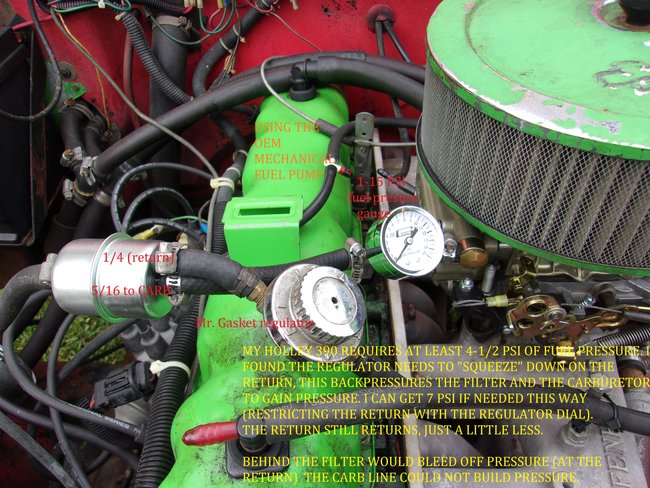

That picture was meant for my last answer.
I don't think the vacuum secondaries can kick in with the vacuum being high.
I think his is like mine, no squirters on the secondary side, I feel sure the other end will be dry until it's on the road under load.

No squirter on the secondary side (single pumper not double) there are jets. The jets are stock on both sides at 57.
This carb wants 7psi at idle (optimal per Holley specs) I'm 1psi low right now
I think it wants 4.5psi to run & can't remember off hand how many gpms it wants
Edit: I'll try to get a pic of my regulator and filter setup in the morning (still only have the 2 port filter installed.)

Try reaching in there with a tool and opening the secondaries as it stumbles. If it starts running better it shows a definite lack of fuel. Pressure wise I don't think you need to worry yet, The higher pressure just ensures the bowls are kept full under higher flow, at the moment you cannot get that engine to run hard enough for that to be an issue.

I've manually opened the secondaries as it stumbled and, yes, it picked up and ran/sounded great.
I was just sitting here wondering; if my jets are too big and my vacuum is a lot higher than Holley expected. Could my vacuum be sucking all the fuel outta the primary bowl?
Here's why I'm thinking that; stock power valve is 2.5. Makes me think Holley built it for about 6 in hg. Whereas I have nearly 20 at idle (full manifold vacuum) I've tried the 10.5pv but still had the 57 jets.
It seems to me that I should be running a smaller jets (maybe the 52) with something like a 10.5 or 11.5 power valve.
Am I way off track or does any of this seem logical?
