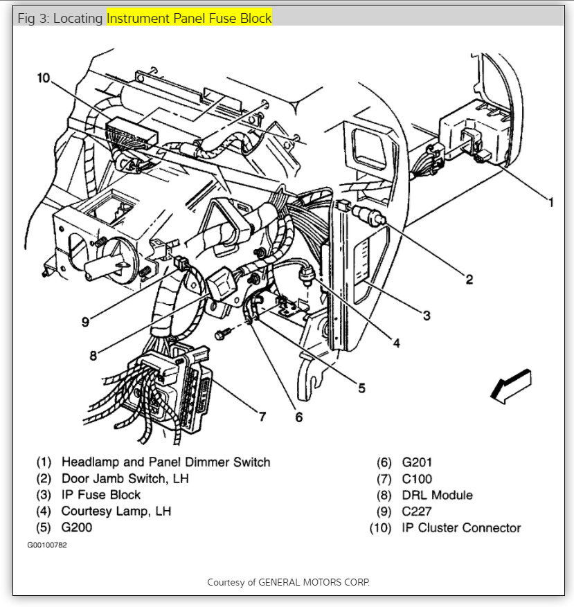

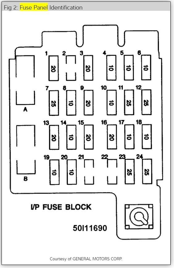

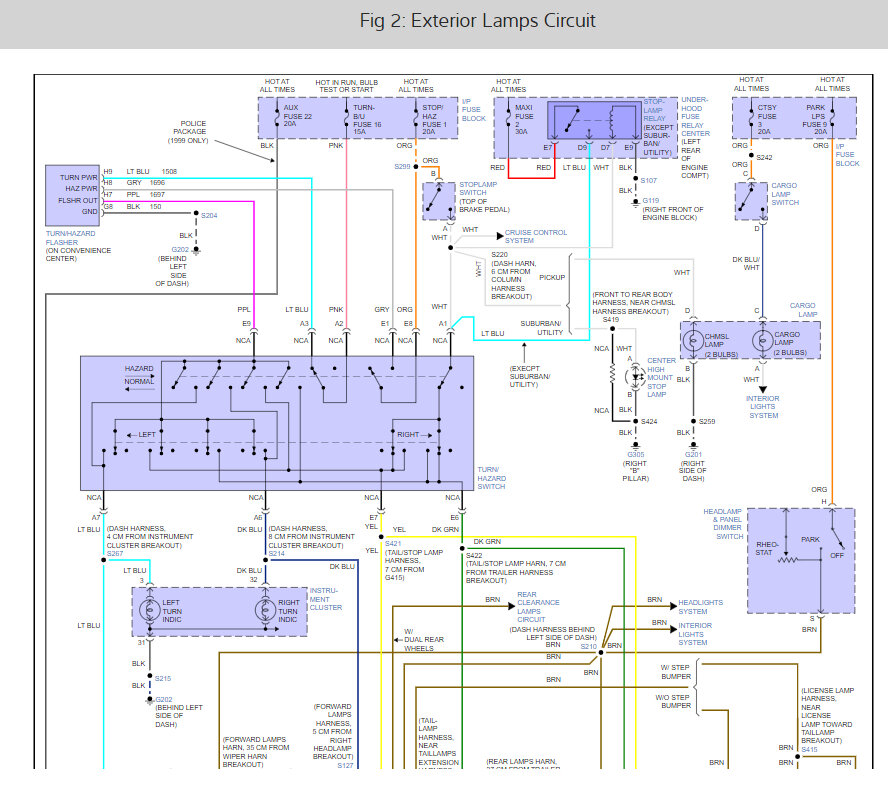

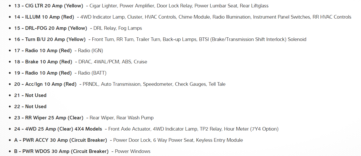

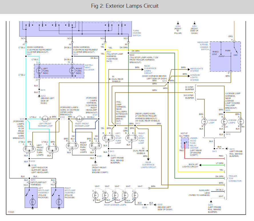

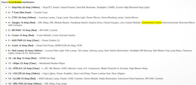

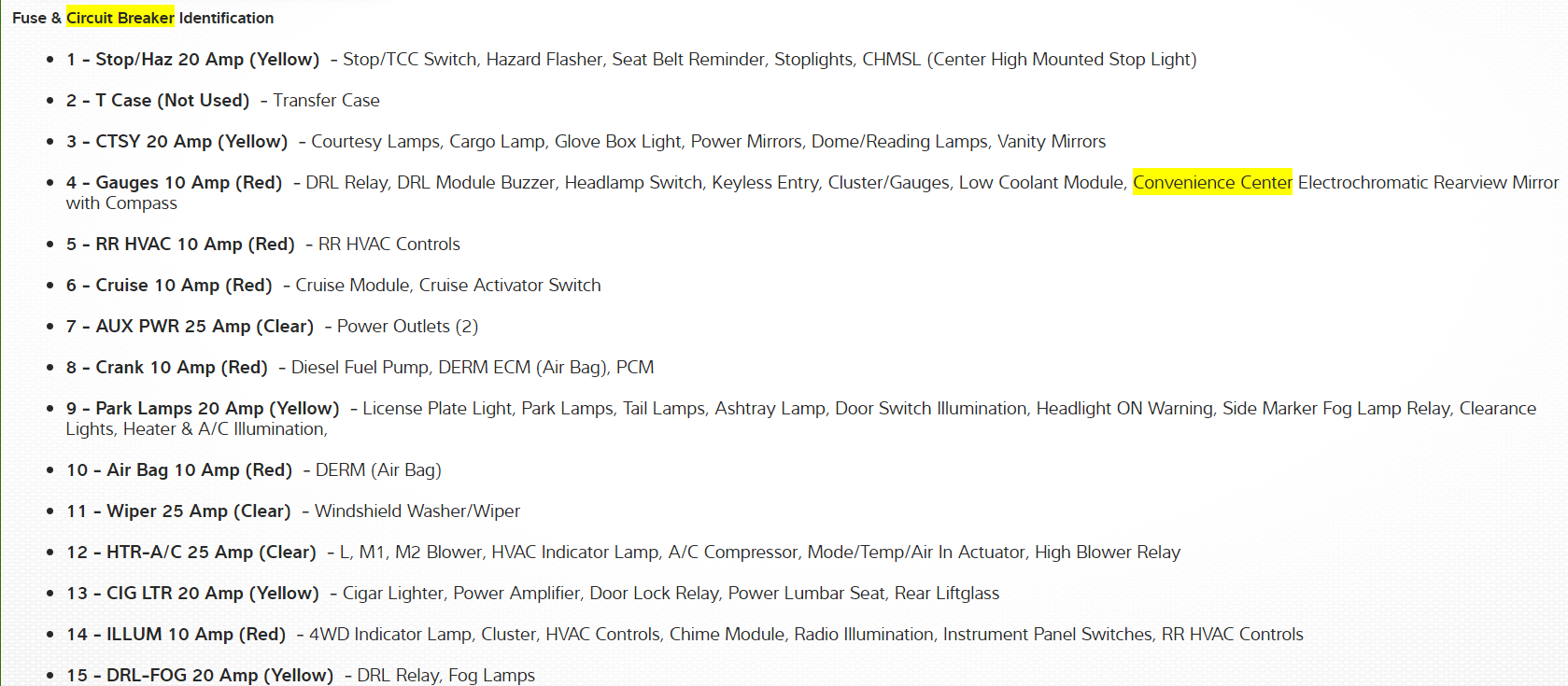

If getting laid off wasn't enough, the running lights quit working on my tahoe -- fuse #15 looked good but I replaced it just in case but they still are not working -- any ideas?
Thursday, September 17th, 2009 AT 12:31 PM
LIKETO
There is a PARKLAMP fuse #9 in the interior fuse panel I would check here is a guide to help and the running light wiring diagrams so you can see how the system works with the fuse locations as well.
Check out the images (Below). Please let us know what happens.
